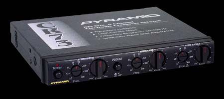

Well, after my calulations showed that a 2nd order passive lin-level was too much of a load for the pre-amp, I decided to purchase this Pyramid car active filter, which I'll be using to drive my subwoofer only:
Pyramid CR73G 6 Channel Electronic Crossover System
Compact Half DIN Size
Mounts in or under Dash
6 Channel RCA Output (Sub, Mid, High)
2 Channel RCA Input Jacks
Infinitely Adjustable Crossover Points
Sub:32-400Hz
Mid:32-400Hz
High:640-8000Hz
Independent Output Gain Control per Band (3)
Subwoofer Phase Shift Adjustment
Frequency Extender (Factor 1:20)
LED Power On Indicator
Fully Isolated DC to DC Power Supply
12dB per Octave Slope
Frequency Response:20Hz-30kHz
Signal to Noise Ratio:>90dB
Distortion:0.01%@1kHz
Dimensions: 7” W x 1” H x 5” D
Cost US$35
