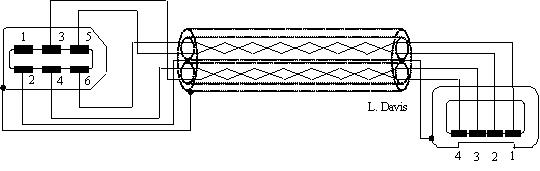

probably already mentioned
flg: " ... I have worked with equipment, from a different field, That had to drive analog signals 20-30' down a cable. We used a double shielded cable. The inner shield was driven by a low power amp driving the same signal as the signal line. The outer shield was a gnd'ed shield. ... The theory here is that the signal line is in effect "cascoded" by the inner shield. ... "
This is the principle behind both USB and FireWire cabling, grounded outer shield (-), active power (+) on an inner wire or other shielding. This methodology is also related to those inexpensive TV coaxial cable boosters / amplifiers, shield as (-), center conductor as (+) = Electrons flowing down the outer shield (usually negative or grounded = 'cause that's where the electrons are). Cable capacitance / impedence is reduced, significantly in some cases ...
(This is, in principle anyway, the reason computer bus speeds have increased beyond "inactive" possibilities, like the PCI and PCI-x bus, etc.)
yes, they said that they used double shielding where outer shield has been grounded and inner shield is running the sam signal as hot wire inside (in center of the cable)...this inner shield is driven via buffer and this buffer has to deal with the capacitance that is between inner and outer shield - here i have only one shield so things are not good looking....

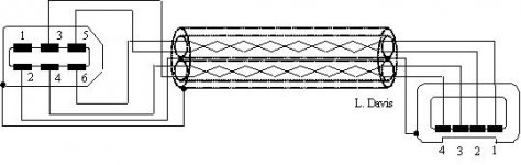

Example: USB
1) + Power = +5 VDC
2) Data 0
3) Data 1
4) - Power Ground = 0 VDC
5) Shield grounded, clamshell, tied at one end or both by connection to pin 4.
Example: 6 pin FireWire 1394a
1) + Power = + 12 VDC or greater = shield of one twisted pair
2) - Power Ground = 0 VDC = shield of one twisted pair
3) Data B receive
4) Data B transmit
5) Data A receive
6) Data A transmit
*) Outer shield = 0 VDC tied to 6-pin clamshell, one or both ends and tied to chassis ground
Note that current flows in both inner 1394a shields and can flow in the outer shield, thus aiding in impedence matching, etc. ... and also reducing EMF interference, internal and from the outside. The physics of all this is quite complicated, but it does work whether there is a dynamic flow of electrons or a static charge on the shield(s).
From: http://www.interfacebus.com/Design_Connector_Firewire.html

"Note that current flows in both inner 1394a shields and can flow in the outer shield, thus aiding in impedence matching, etc. "
Can you please educate me as to what this means. I cannot see how DC current in the screen(s) has any effect on impedance.
Nothing in your link explains this, just a reference to differential signals inside a screen.
Thank you.
Thank you.
