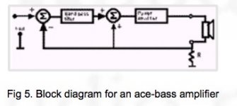

… But ACE-Bass has resistor "R"
Apologies for tardy reply…life events and all.

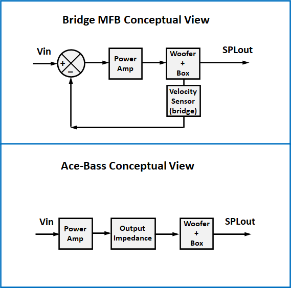

As mentioned in Post #18 , the amplifier current is used to create the virtual components that define the output impedance. Voltage across a resistor between woofer and ground is an easy way to sample amplifier current. You could also use a current transformer if you wanted to avoid power losses in the resistor. Sampled amplifier current can be used to create amplifiers with output impedance ranging from simply resistive (- Re, to near + infinite) to capacitive, inductive, or combinations thereof. This is not corrective MFB. However, when that resistor between woofer and ground is used as part of a bridge arrangement, it allows extraction of the voltage generated by the velocity of the voice coil in the magnetic field gap(ie back EMF). Here you have a signal proportional to motion of the cone that can be used for corrective MFB.
…The ACE-Bass amp uses that feedback correctively…
If you are unable to evaluate detailed circuit behavior from a schematic(not too many people can), your alternatives are to use a circuit simulator like LTSpice to analyze it for you, or build and measure. Having done both myself, please re-read Post #15 which describes the actual measured behavior of ACE-Bass and bridge MFB systems, not notional behavior based on presence of a resistor in a circuit diaphragm. The MFB system responds correctively to changes(or errors) in the woofer/enclosure system. The ACE-Bass system does not.
This notable difference in measured(and modeled) performance has to be acknowledged before you can appreciate methods and details of what is going on. My hope was that providing examples of actual behavior (along with conceptual view of how behavior is realized) would help you and others understand what the circuit is actually doing. Its operation is fundamentally different from corrective MFB. Notice that I didn’t say better, just different. You would be very close to the mark if you instead complained that Ace-Bass was just an overly complicated way of performing EQ.

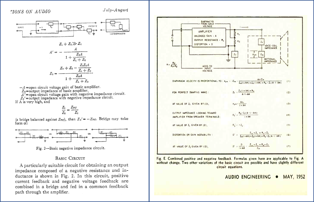

… Previous experimenters like Clements did identify the potential need to balance out the VC inductance, but only mention using an appropriately ratioed inductance to do it
While attempting to organize my electronic archive on MFB, found the attached clipping: an even earlier description by Williamson(yes, that Williamson) for using bridge arrangement to extract cone velocity for MFB use was published in 1947 Wireless World, also includes inductance compensation in the schematic.
Smart folks in olden days.
