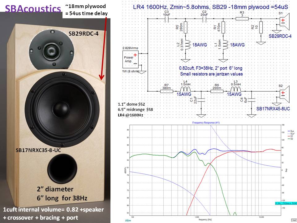

Matches your goals: (White 2-cabinet TM-W)
10" Woofer FloorStander 3-way
3 - SB Acoustics drivers =$250
SB Acoustics :: 1.15" SB29RDC-C000-4 $52
SB Acoustics :: 6" SB17NRXC35-8 $58
SB Acoustics :: 10'' SB29NRX75-6 $140
Sealed SB17NRXC35-8 6" midbass has Qtc~0.7 in ~0.5cuft with F3~70Hz, and works well with a 1600-1800Hz crossover. (use LR4 with active). If customer desires ported option, they can start with a 0.82cuft ported cabinet tuned to 38Hz (2" dia, 6" long), and later put in a port plug which reduces the internal volume to ~ 0.5cuft.
There are passive TM crossovers available for SB29RDC + SB17NRXC35 if only 2-amplifier channels are available, and the active Xover is used mainly for complex room-bass-equalization.
Sealed SB29NRX75-6 10" woofer has Qtc~0.7 in 1.3cuft with F3~43Hs. A Linkwitz Transform can push this to F3~20Hz with modest power boost. A sealed woofer both sounds best, and is easiest to compensate for room effects. In a ported 2.3cuft cabinet(3" dia. 13.2" long), the SB29NRX75-6 produces Fs~24Hz deep bass.

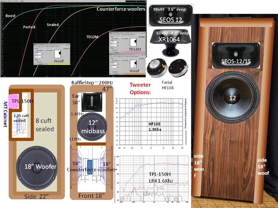

---If you feel the urge to Build BIG..
Peavey 18" LoRider woofers are $200 each and very musical...
but now you need a 12" midbass to keep up...
but now you need a horn tweeter to keep up...
but now you have a different thread
