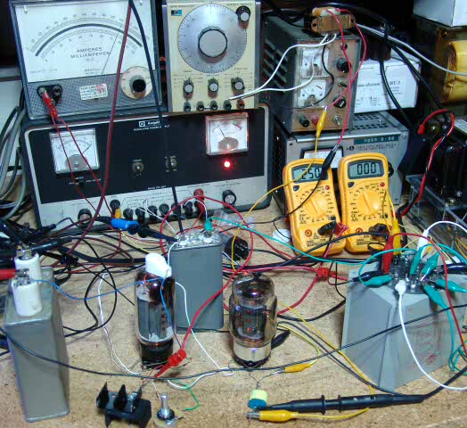

OK, I couldn't just read this without building anything. My work room is still a mess, but I cleaned off a spot, and "built" a basic amp. It is an unsafe mess, so as they say on TV, "Don't try this at home."
Kuei Yang Wang made the following statement, it convinced me that I had to try it.
"Here a little trick for you.
Combine a KT-88 and the IXYS CCS Tubelab mentions (replace the cathode R of the upper SRPP device with the CCS). This way dissipation in the Solid State CCS is limited, most is dissipated in the KT88. You can take the output from the lower Valve Anode (basically traditional SE parallelfeed) or from the upper KT-88 Cathode for basically a Power Mu-Follower."
So, I wired an IXYS chip up to an octal socket, and built a CCS. I tested it with a box full of different tubes. I took the best 10 tubes, and tested them at 3 different currents. What I found is that there is a big difference in the minimum voltage required for CCS operation.
A (Chinese) KT-88 needs 100 volts to create a 30 mA CCS, and it needs 145 volts to provide 80 mA. Overall, sweep tubes work the best. My favorite, the 6LW6, requires only 36 volts for a 30 mA CCS, and 50 volts for 80 mA. I will post the entire list later.
Since the 6LW6 required the lowest voltage, and my power supply only goes to 400 V, I used a 6LW6 for the top tube. I wired up a KT-88 in a manner similar to your latest test circuit, except that I grounded the cathode and used fixed bias.
The first thing that I found is that my CD player does not have near enough drive, neither does my audio generator. I used a filament transformer to step up the output of the generator. Now I could drive the "amp" to clipping.
Output is only 3 watts, this is about right for a 400 volt supply. Frequency response, measured at low signal (without the step up transformer) using a resistive 3 K ohm load (no OPT) was amazing. 18 Hz to 800 KHz (3 db points). The limiting factor will be the OPT.
Here is a picture of the experiment.
Next, build a 600 to 700 volt supply, depending on whatever transformer I can dig up. Then I want to experiment with screen drive. Then depending on the outcome, I will prototype the driver, then build the amp. The results will be posted here, and on the web site.
