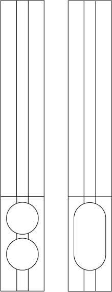

I received the boards last night. Thanks very much for organising this and going to the considerable effort of mailing all of these out. The boards look very impressive from a design and fabrication view.
And to answer your question Bob, mine are destined for use in a two active setup. The amps are using Elektor modules (High End Amplifier 5/2005) but in bridged mode with massively increased power supply capacity. The speakers are planned to be a BG RD50 planar coupled with twin SEAS W22 magnesium woofers, crossed over around 500Hz. I am planning on investigating the worth of some shelving boost filters for both the bass and treble.
The design would be something like the attached file (a rough preliminary outline).
Nigel

Looks like a nice project Nigel.
Most speakers can benefit from some baffle step compensation unless they are mounted flush with the wall. At the top end, I guess it depends on your ears. I don't really hear up where the B-Gs start rolling off any more, but I do sense that there is something going on up to 18 kHz or so as long as I have taken my allergy meds.
Many switchmode power supplies drive me nuts with their whine. Go figure.
