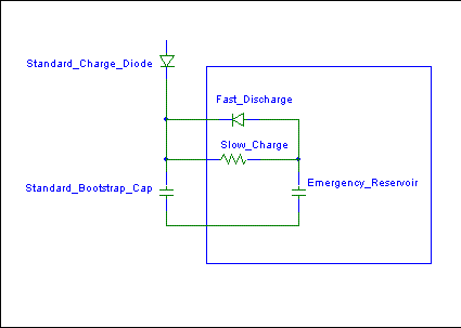

For those who want to use a large cap I already made the following suggestion once (don't want to search):
Use a small cap as usual as main bootstrap cap like 100 nF for instance. Then use an "emergency cap" of larger size of which current is drained during long on-periods of the high-side driver. In order to make this current available quickly when needed without soaking the lower-driver's supply (as soon as the lower-side FET is switched on again) you use a Schottky diode and a parallel resistor between the two caps.

Charles, some more details about your last suggestion?.... Thanks!
UcD use 33kOhm pullup, for precharging bootstrap cap, and zener to clamp it at the 12V. I don't know too, why need the dedicated source or other bruteforce solution if standard circuit ok.. BTW, ir2110 and similar drivers, just can't provide 2-3A, even pulsed, long time at about 80-100C, so they need P-BJT follower at least, that will often safer for the ir2110 if the mosfet blew up.
Below you can see what I am talking of. The components in the box are the additional ones.
Regards
Charles

That's my thinking too. The brute-force method (a constant high side supply) should and obviously does allow the chip to work properly at high levels of low frequency clipping and even DC, but a larger bootstrap cap should allow proper operation even at high levels of low frequency clipping. That makes it sound like there was some other problem that made the bootstrap cap discharge too quickly or did not allow it to fully charge.
