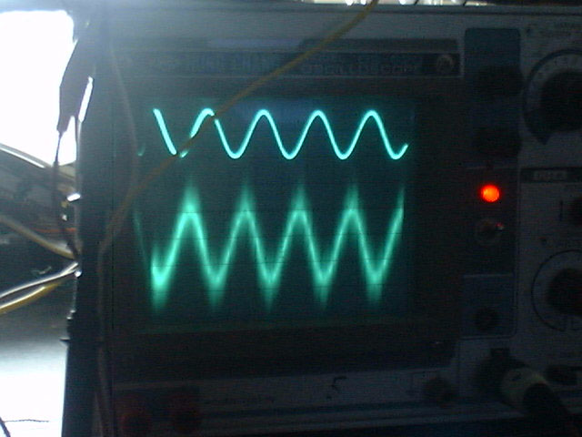

I'm making a second order active crossover for a sub of mine, i made some prototype on a breadboard using a pair of uA741, but there was some problems.
First of all, the noise levels introduced in the filter, its awful, at first i tought its the ground, now i think its either the psu or the opamps.
im taking the voltage off the main amp psu, using +/- 15v regulators, is that ok?
So, what are the best opamps for active filters?
i own the active filters cookbook, by don lancaster, this is where i got the designs and formulas for calculations.

Very often, exces noise is symptomatic of high frequency oscillation. You might want to probe around a bit with a scope.
A 741 is pretty old technology- it should work fine for the low-pass section, but you'll probably want something a bit faster and with a stiffer output (not to mention lower offset voltage and bias current). Speaking of which, what sort of resistor sizes did you use in your prototype? If you go too big, the current noise of a 741 will kill you.

i probed the in and out of the 741,
and the in is kindof clear, the out is awful, looks like 60 hz noise and some pink noise noise, i think the 60 hz noise is from the psu, guess i`ll make a better psu..
any idea of better suited opamps for these applications than the 741 and 318?
i used them becuz they are like very cheap... for the prototyping, also, could it be he breadboard? i got the dc regulators on the same breadboard as the filter itself

It depends on how fancy you want to get. My crossovers are designed with unity gain so that I can use buffers. The BUF03 is a classic for that application, but honestly, an LM310 will probably be just as transparent- as long as you don't tell your tweaky friends what you're using. Grab an Analog Devices databook and start browsing; they've got a terrific selection of fancy devices. And their analog guru, Scott Wurcer, has terrific taste in wine ;-)
Watch your grounding schemes!
Hard to tell for sure without my hands on the knobs, but I'll bet a kopeck to a doughnut that you've got a grounding problem.
