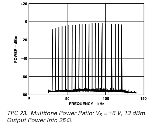

The next question that arises is - how to design for such a target when datasheets for opamps don't characterize them for IMD performance? (This being IMD performance with multi-tone stimulus, each tone at -30dBfs or lower, to mimic music) Do you know some way to interpret the customary THD plots to get out the relevant info?
<edit> After posting I realized there is one exception to the rule - the AD8017 has this. And sounds remarkably good 🙂

There are a variety of other amplifiers with both IMD and THD in the datasheets---Analog has a bunch and National included it for the LME497xx series---and for all the ones I've looked at IMD = THD is a good approximation. Same goes for the ones I've measured (though those are all pretty capable parts). This is unsurprising as they're both measures of the same behavior obtained in the same way. Specifically, THD is the special case of n tone IMD where all tones fall at the same frequency. More formally, it's the diagonal of any n dimensional IMD matrix for any arbitrary n.Do you know some way to interpret the customary THD plots to get out the relevant info?
It's not particularly hard to measure IMD or correlate to it to subjective quality. I apply the 10 tone rake defined for Rnonlin in AudioTester.
For a moment I thought I might have missed something, so I looked again at LME49720 DS - and only found IMD plots vs output voltage into 600R and 10k loads. Nothing like what I was talking about.
So what does this math tell us? That we don't need MTPR measurements any longer because THD tells us all we need to know?
