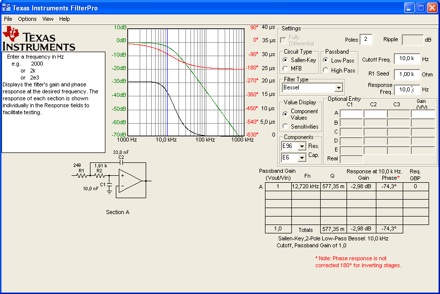

What keeps getting me is the low pass crossover. The only thing in the signal path is resistors, and then the caps are going to ground. In this arrangement, would the caps still exhibit a phase shift on the signal?
Thanks!!
Reece
Yes.
Everything is in the signal path.😉
Green is gain, red is phase, black is group delay.
There's a tendency to think only of series connections as representing "the signal path" but, as Carlos notes, parallel ones count, too.
Think of the resistor/cap combination as a voltage divider. The resistor is frequency-neutral, but the cap passes high frequencies. In low pass configuration, the cap passes those frequencies to ground, where they are lost. What remains is sort of a photographic negative of the high frequency 'image' that went through the cap, i.e. the lower frequencies. Whatever the cap removed leaves an impression--in the negative sense--on what remains. Thus the cap does have an effect on the sound quality, by virtue of what it subtracts. This includes phase relationships, except that they too are reversed.
