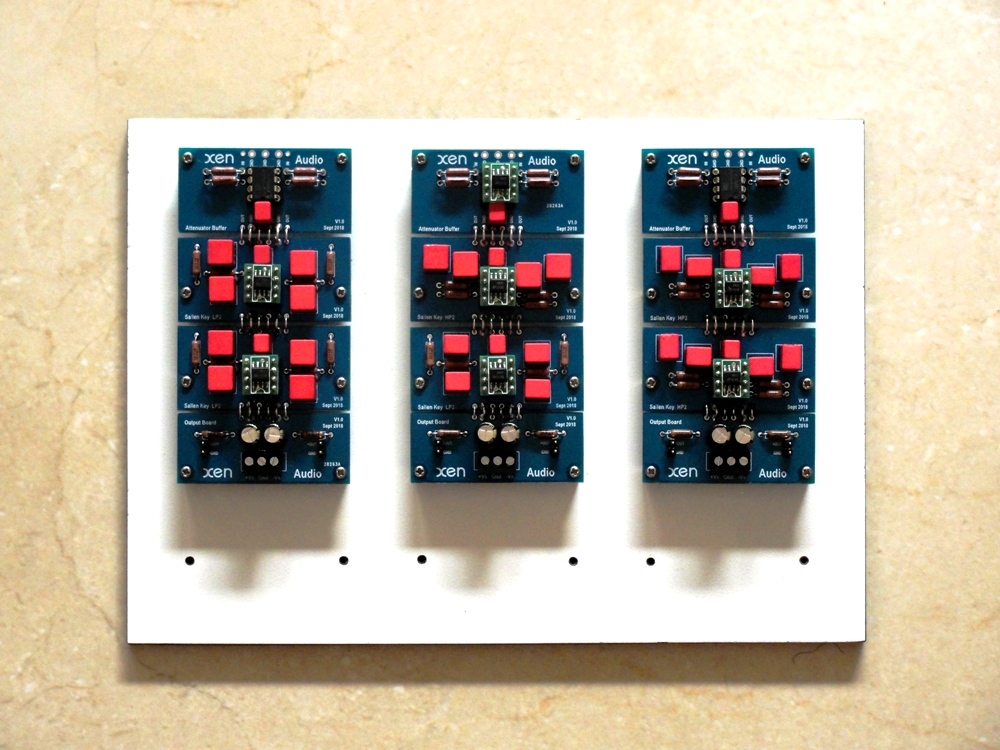

And in my own (analogue) attempt, I have now replaced most IC opamps (at unity gain) with discrete JFET followers.
A Modular Analogue Active Crossover Filter Solution
https://www.diyaudio.com/forums/pass-labs/140488-b1-turbo-chip-14.html#post5740480
(post #136)
And for the few modules where opamp is a must, a discrete dual opamp come to the rescure.
https://www.diyaudio.com/forums/analog-line-level/218373-discrete-opamp-design-334.html#post5711190
(post #3333)
There is a lot more fun doing your own, and they cost also less than any commercial offering.
The modular design makes it even more flexible.
