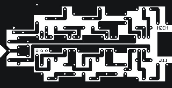

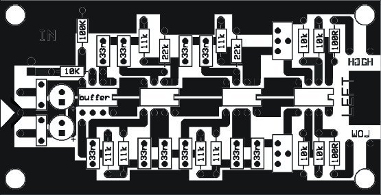

I don't know how to post 2 or 3 pistures at the same time.

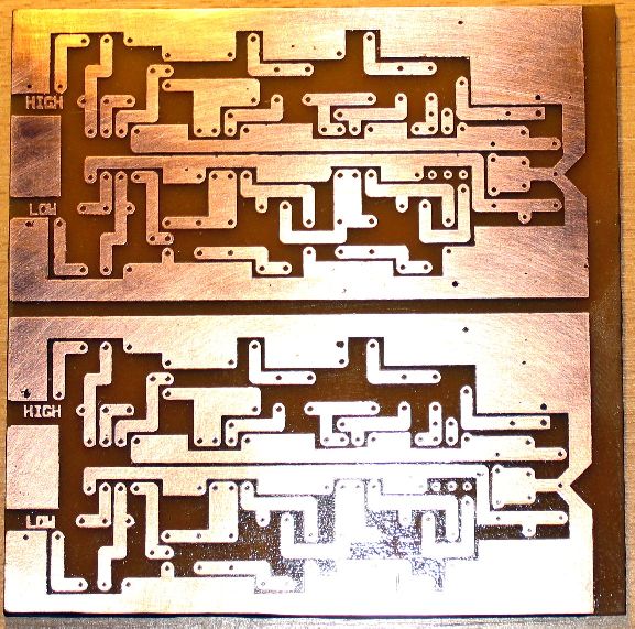

ivan: looks like nice work -- I'm a noob so I bought the PCB from Rod.... 😀
Hi, guys
It's the first time that somebody apreciate my work, thank to everybody.
Well, because I'm novice in electronics, I use the "Express PCB" then use the PhotoPaint (corel) to improve the traces and finally to make the PCB, use Press'nPeel to transfer the picture to the copper. I have "Eagle" too, but to me is complicate.
If anybody need the hi-res pictures send me an e-mail.
Thaks to everybody
Iván Francisco
