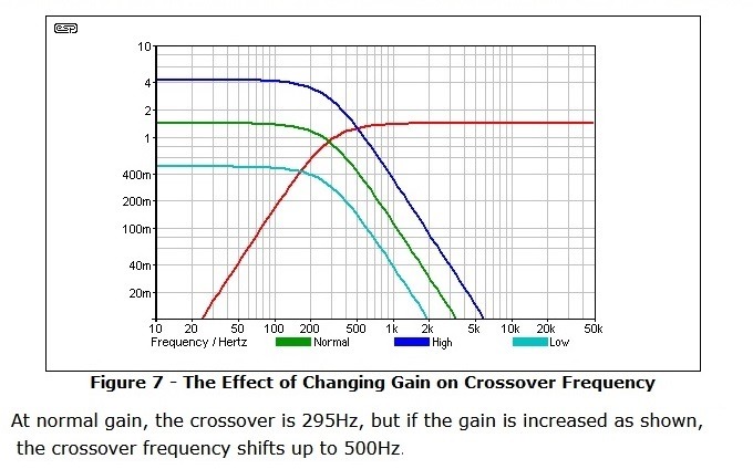

Upon Further reading on Mr. Elliott's comprehensive pages, I spotted this graph showing the effects of this very
same level (up) adjusting upon the crossover point(that we worked so hard to make symmetrical).
(Image Attached below)
So it would appear that if the woofer level is raised ~3dB to compensate for baffle step effect, the low pass "knee"
moves up in frequency, thereby raising the crossover point (but how much?) 🤔
Anyone else have experience with this phenomenon, and if so, advice on how to cross the woofer appropriately to get
a reasonably flat response in the lower mid-range?
Thanks!!

It is actually less complicated than you might think. In most cases, the baffle step can be compensated with a shelf filter. A first order shelf of 6 dB is a good approximation, but if you have good measurements where you have merged the near field response into the far field gated response, you can fine-tune the baffle step with a low-Q second order filter.
It is not necessary to align the crossover frequency with the baffle step frequency. A shelf filter can be put in line with both the mid and the woofer, and the two shelf filters need not be the same but instead they can be tailored for the responses of both the mid and the woofer.

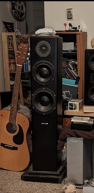

Mine are: 6" midbass above 500hz
8" woofer 26" from carpeted floor;
speakers placed 5 ft. out into room;
4 feet from side walls, and 6 feet apart in 14ft wide room.

by setting the crossover at the baffle step frequency
Actually it is in the range 0.707 to 1 x thr BS(-3). I have found number sin the lower range work better.
8” baffle width is approximately 570 Hz. 500/570 = 0.877. 570 8 0.707 = 400 Hz.
As moondog suggest sthe room and room placement can greatly complicate things.
And keep in mind that rasing on-axis to flat (if not already) will make the room response the same amount too high, so one has to listen and make a judgement
call.
BSC is not a panacea.
dave
