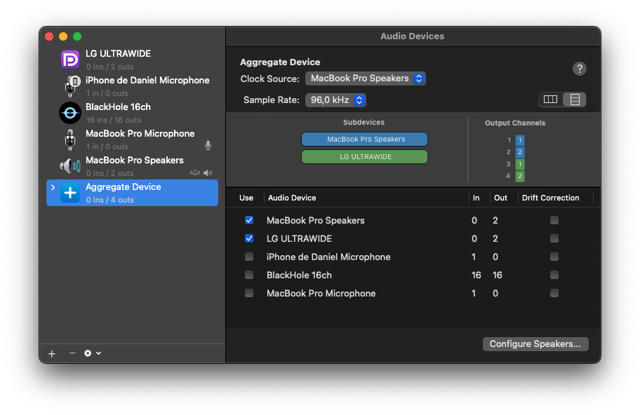

I guess you can use a software/driver that aggregates several audio interfaces into a mutichannel one. I.e., you have 3 stereo (2-channel) usb audio interfaces that are combined into a single 6-channel interface via software. In MacOS there is a native feature called "Aggregate Device" that allows you to do it:
If I remember correctly, ALSA has tools to do that in linux as well. Then, having several devices show up as a single multi channel one, you can use a software like CamillaDSP to build your crossover.
However, from what I read, you can run into syncrhonization problems as USB doesn't ensure that all devices are in sync. I also read (sorry, couldn't find the link) about a guy that used two Prosonus 26C interfaces connected to a computer through USB to run as a single 8ch DAC, and it seems that there were no synchronization issues (powerful comuper + 2 equal interfaces).
