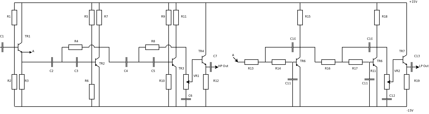

Dear all,
While at work today I had what seems to me like a good idea. The transistors TR5 and TR6 could be converted from NPN to PNP so negating the DC bias issue that I was concerned about. I will get extra PNP transistors so I can see if this helps for TR2/TR3.
I will post the new schematic in the near future. I will also get some extra coupling capacitors.
I am also thinking that if I make the circuit split rail so the capacitors C6 and C12 can be omitted. (my RIAA preamp already has an over built split rail supply)
Does any one have any thoughts on these potential changes?

Actually no scrap that, I was tired.
You still need the caps as the output from the transistors will be at around -0.65V, unless you get clever with the biasing, which may be difficult to work out due to interaction with the filter resistors.
In a discrete circuit stick with single-ended supply, in an op-amp circuit where there are no inherent offsets use a split supply and DC coupling.
Do I have decided on transistors. Mostly based upon what was available in my local store with high HFE. Maybe later I will pick different transistors.
For NPN I will use, BC547C. For PNP I will use BC557C
For the standing current in both transistors I will use, about 4 mA as this is still within the maximum gain of the transistors.
Across the outputs I will use +15V 0V and -15V as that's what I have.
Having thought about what richie00boy was saying C6 and C12 can't be removed and the variable resistor be sent directly to earth unless some thing is done cleverly with bias voltages of the transistors, making the design to dependent on transistors, so I will leave it with a relatively high capacitor values for C6 and C12.
Here is the amended circuit diagram.

Hi Owen,
first let me congratulate You to the decision of using discrete components instead of OP-Amps. It´s the right decision on the way to good sound ;-)
I personally prefer JFETs where voltages are involved and bipolar transistors rather for current tasks (similar to triodes vers. pentodes in the tube world).
You might consider for example using the common and easy to source BF246A N-Channel JFETs as buffers. A pair of BFs, one connected as a sourcefollower and the second as a current source to the first, works excellent, either with single supplies or dual supplies. The latter would even allow for the ommittance of several coupling caps.
Besides the buffer-supported passive filtering You show in Your schematics the classical unity-gain Sallen-Key structure (using the above described JFET-Buffer stages) allows for very well sounding circuits. Looking off of the common filter menue plate You can find very interesting filter topologies which allow for a lower stage number count or lower parts count in the signal path. LT-Spice is a powerful tool in evaluating those off-the-normal type filters.
