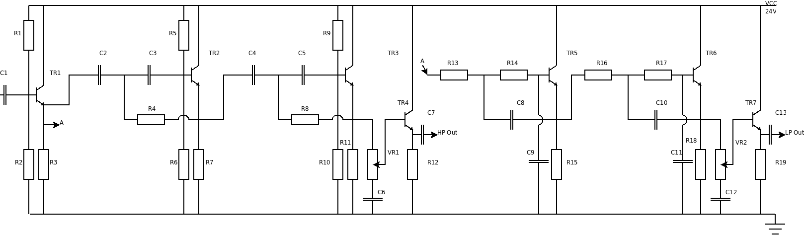

I have a pair of Quad ESL 63 and am trying to design an active cross over. I have a CX3400 which I used to make my LINN HELIX speakers active, but cross over frequencies for 2 way active filtering don't cross over low enough for my ESL 63 so its time for better.
I have read the following articles.
At the moment I am wondering:
Parts should be available from a standard supplier like Farnell and not supper expensive which limits the value of C3,4,5,7,8 to a Capacitance:100nF; Capacitance Tolerance:± 1%. £1.22 Where as 68nF ± 1% are 49pence.
I will probably build 4 of the above so I can do AB Stereo comparisons and will experiment with cross over frequencies between 100-300 Hz.
For Now I will use my old Linn speakers as the sub woofer.
Here is a circuit I am starting with, feed back would be appreciated.

Looks OK, but you are missing the caps for R14 and R17. The value of R5 and R6, and R9 and R10 should be double what your crossover calculator tells you.

Thanks for the encouragement richie00boy. And the values for R5 and R6, and R9 and R10. Could you please clarify

For the low-pass filter, the bias network needs to form your R2, so the value you get for R2 with whatever formula you are using, double that value should be used for both the resistors in the bias network as the capacitor sees them in parallel.
For the high-pass filter you are missing the corresponding capacitors for R14 and R17.

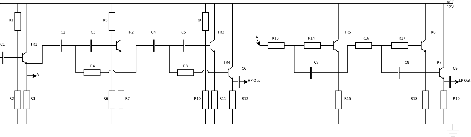

I decided to use the formulars from ESP Linkwitz-Riley Electronic Crossover which are
Since I don't have windows and like python I wrote a simple calculator, which I attached and some sample output. This leads me to select, the following information
So 68nF it is as I expect the cross over to be around 100-150Hz for the final version. As it keeps R not too much higher at 15K than the 10K used by ESP circuit and the 11K used by the Active 3-Way Crossover

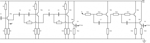

I looked at it more than 10 times then realized your right I am missing
Thank you so much for your help richie00boy 🙂

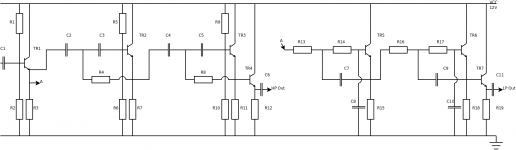

Attached is a revised schematic. I updated the capacitor numbers due to the two additional capacitors added for R14 and R17.the corresponding capacitors for R14 and R17.

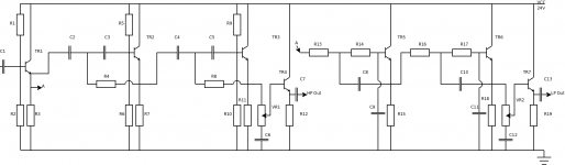

Please correct me if I am wrong. A lot of this is guess work on my part and not because I am an expert.
For the high pass
For the low pass
I have no opinions on Transistor choice, so some help would be nice.
Since for the Transistor TR7, R19 voltage will be slightly more than 2.1 Volts lower than the voltage between at the base of TR1, I may have to up the voltage of supply for now I will leave it as it still leaves me some headroom, I wonder how I can calculate this.
For now I will assume, BC337. I have no knowledge as to where their maximum linearity is, but I do know, Max current is 800 mA, and 10mA is the maximum frequency response, so I assume probably wrongly 10mA would be a good standard current to have running through these transistors. Looking at Designing Bipolar Transistor Audio PreAmplifiers suggests 5mA but being a little on the higher side will allow me to save calculating to many values for when its lower.
Assuming they all have the same transistors, and Voltage is set so approximately half VCC they should be set so the transistors are in the center of their linear operation. Keeping with my target of 12V supply. 6V will be set across all of
This would lead to the value of approximately, 600 Ohms for all these resistors.
For the input buffer I will assume for now,
Giving an input Bias of TR1 of 7.2 Volts, which leaves only 4.3 Volts before definite clipping, maybe I need to increase the supply voltage?
So the questions I have assuming all is correct are.
Costs look like 10-15 Euros for filter capacitors, 4 Euros for transistors and another 5 Euros for resistors and output capacitors.
Again all feed back is welcome.

BC337 are ok as are BC549C, which is what I usually use. I would use a higher supply than 12V, 24V ones are easy to come by. The voltage won't much affect the design anyway.

After looking at the data sheet of the BC549C assuming a 24 V supply so expecting approximately 12 V across the transistor, with a 10 mA standing current (As that's again the collector current with maximum gain) I looked at the power dissipation on the transistor. At 120 mW dissipation in the transistor with the transistor spec sheet it says 1.5 W maximum dissipation (the BC560 has 500 mW Max), this is a factor of 10 inside the maximum dissipation. Since the transistor spec sheet had 12 mW/C temperature coefficient, this would make the transistor raise its temperature my 10 C. This seems a little hot to my mind.
Looking at the gain curve with collector current, I noticed that gain is essentially flat from 5mA to 25mA so it seems safe to half the current to 5 mA which ties in with Designing Bipolar Transistor Audio PreAmplifiers.
So this brings me to the new value of 2.2 K for
Any last feed back before I create make an order with farnell. I will post the order codes for each item here before I place the order too.

Thank you for addressing the issue that is most bothering me most about this design, the decision of how to bias the transistors. I guess I will stick on the low side of the standing current as I would rather the circuit does not drift too much during operation. 5mA makes for 15% and is still in the maximum gain area which should minimize the distortion my smoking break colleague was concerned with.
I will post an updated schematic with the volume controls added in the output buffer very soon.

Here is the updated schematic, I have added a variable resistor and a capacitor for the output buffers.
Due to not using a new biasing network on the output buffer I save an additional capacitor between TR3/TR4 and TR6/TR7 this may not be a good idea if the transistors hfE is not high as the base current may lead to excessive voltage drop across VR1/2 this is especially true for TR7.
TR7's emitter may be in the worse case which may be 5V-6V lower than the voltage at the base of TR1. Seems a 24V supply is definitely needed, and maybe more care over DC offset.
Regards
Owen
