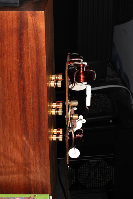

Perhaps I should have qualified 😉 it would be difficult for me using the philosophy I used of no opamps in the "direct" signal path. I used RLC notches in series with the drivers and I'd have to simulate floating inductors (without a shunt cap) to do that, and that is quite a bit more complex, than the gyrators and FDNR's that I have used for the "simple" circuit. Doable but more complex than I'm ready for I think. I did make my MTM's fully active ready from the outset. However I wanted to do passive as a first try with active a possibility down the track.
Pic shows that they are active ready 😉
