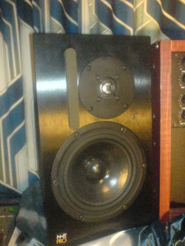

speakers are NHTpro A-20 (minus the original amp and crossovers which were 2100hz)
and it sounds good with fast punchy bass, but around the cross over frequency theres a 2+db spike and the treble is generally a bit harsh.

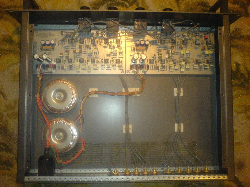

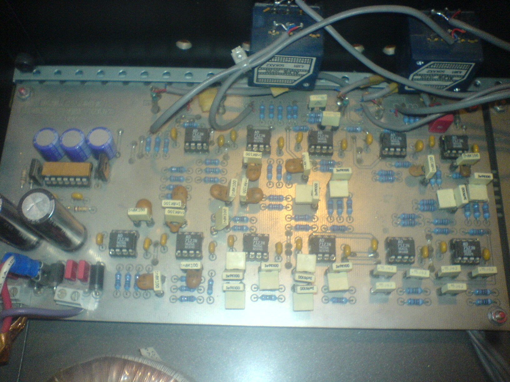

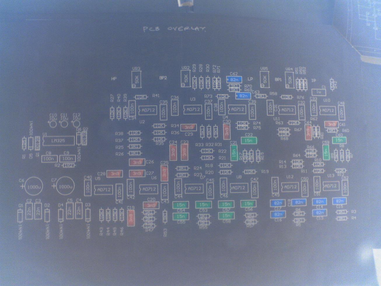

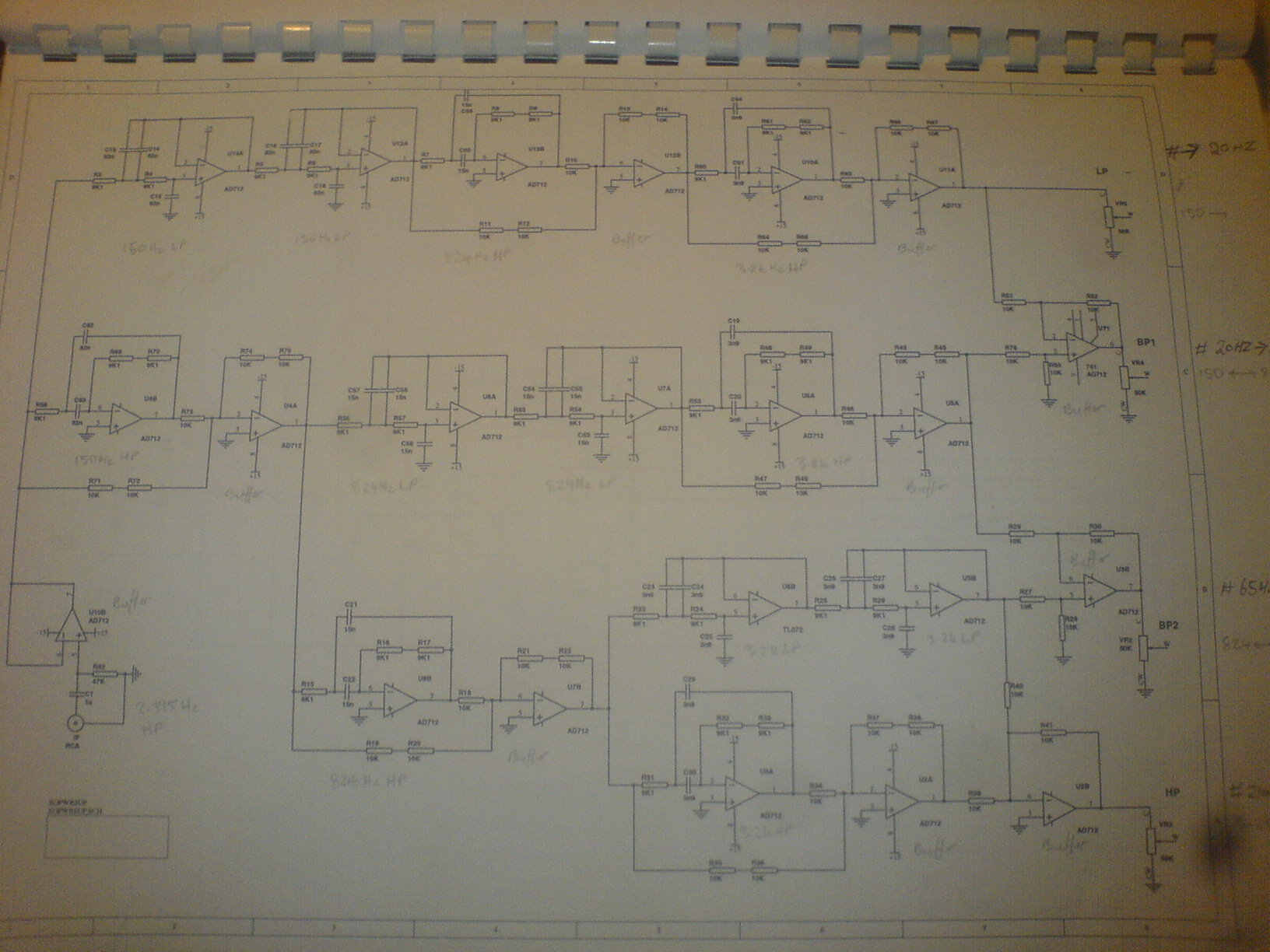

i see, yes i am having trouble finding the required caps to alter freqs. though in the supplied manual with the active crossover it details how to change the freqs, there is no mention of resistors so i would not know where to start there!
i really would love to use this crossover as i believe it is hand made by a great local audio engineer Jon De Sensi. it should be used but i would need to find suitable amps and a extra mid ranges and subs for a reasonable cost! maybe its better to buy (or build) an active two way crossover if reliably designing a passive one is too complicated?
cheers, gabby

Ideally your mike will be calibrated, but many are flat in the crossover region, which is most important. Download Holm Impulse and measure away.
Your active crossover looks like unity gain Sallen-Key topology on the low pass sections, set up for LR4 all around. (indicated by the double caps and resistors) Go to Elliott Sound Products - The Audio Pages (Main Index) and download Rod's LR component calculator. The high pass is multi feedback (MFB), for that go to Active Filter Design Application - FILTERPRO - TI Software Folder and use TI's filter pro program to calculate values.
There are a couple interesting things about your filter. It is a subtractive filter - the bandpass and high pass sections are fed an inverted signal of the band below them to generate their high pass function. Note that the high pass sections are bypassed with resistors and that each leg has all the crossover frequencies involved.
This isn't a topology that I have used, but it looks like you could substitute your desired crossover frequencies. I'm not quite sure what to do about turning it into a 2 way (with sub?) though. It probably involves pulling R25/R51 and R45 and using a 10K to connect those legs and bypassing some sections in the low pass (and BP1).
Another thing to consider is adding a phase correction circuit and baffle step correction - see Linkwitz. Since the slopes in your crossover are textbook, you'll need to adjust the drive phase. You may also want to add some eq to flatten response, either a notch/boost or shelving. Baffle step compensation is required unless your placement will be quite close to the rear wall.
Oh no, looks like the incarnation of one of Stephen King´s books..."OP-amp cemetary" ;-) The only intersting thing I find about that filter is: How can anybody design such a *** thing?? I´m pretty sure that this will not only not work as intended but it surely will sound crappy with those myriads of OPs around.
Yes there are OPs in that schematic that subtract some signals of each other, but since no care is taken about the phase relationship of theses signals the sum of two subtracted channels wont be 1 again. This is not what a subtraction filter is meant to be. A subtraction filter only works well when the drivers are very well behaved and still well behaved at least one octave above or below the Xover-frequency. Typically this means additional equalizer circuitry. If one still wants a subtractive filter then search for Hawksford-Riley. Lowest parts count, matched and as such costier components are not needed and it offers highest symmetry of filter flanks and its truely subtractive. *lol*.
I would opt for a classical filter structure though where both channels are Xovered independantely. Since only a 2 way system is to be Xovered simple unity gain SallenKey structures are fine that can be implemented with simple discrete Buffer stages.
jauu
Calvin

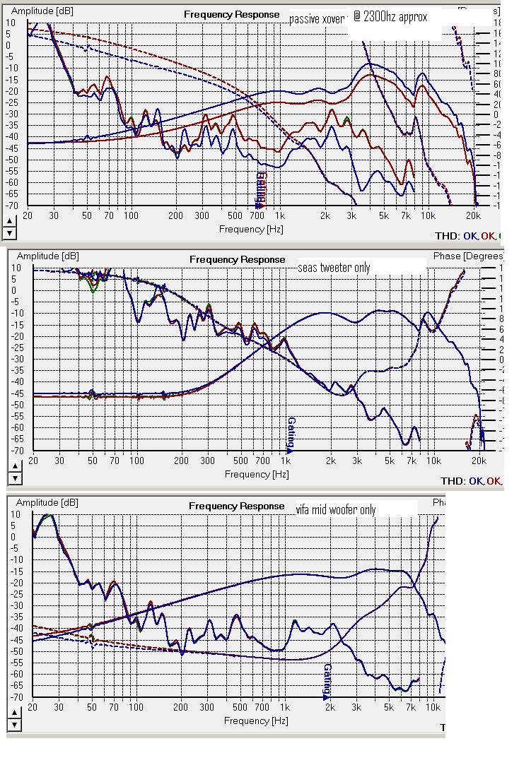

after mucking around with HOLM software i made some measurements using a shure sm57 mic and found some interesting results..
i recorded the system response with the cheap passive crossover connected first and then the individual drivers.
from what i can gather, it looks like theres a huge bass hump below 80 hz that is a worry, also a dip between 600 hz and 1200 hz. theres a peak at the xover point 2300 hz ant the tweeter rolls off steadily after 10000 hz.
am i reading the graphs correctly?
could the amp or room placement be to blame for the massive bass lump?

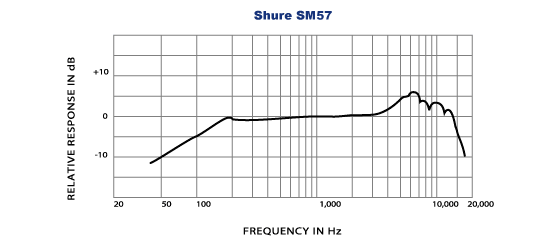

Notice the gating arrows on the bottom of your graphs? They are telling you that anything to the left of them is unreliable due to gating.
Look at your impulse measurements and set the gate to end just before the first reflection. The low end (below 3-400 Hz with that woofer) should be measured near field and spliced to the high end if you want to want a better representation of what's happening.
Try a log sine sweep or chirp instead of the MLS and see what a difference it makes.
I assume that's a generic curve for the SM57. You really should have a flatter mike, although Holm Impulse corrects for that, assuming you've entered it into the calibration file. Parts Express has their EMM-6 calibrated mike that is flatter over a broader range. There is some discussion whether the calibration file provided is for that particular mike, but it seems to have gotten better. You can get a calibrated mike from Cross·Spectrum Labs - Sound | Vibration | Engineering under $100. Herb calibrated my EMM-6, it was quite a bit different than the P-E supplied graph, but it was an early one.
