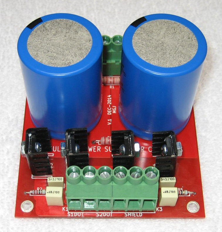

Or, if chassis mounting is impractical, discrete diodes chosen for low-Vfwd can operate just fine with small and inexpensive heatsinks on an ordinary PCB. The example below worked just fine, delivering a continuous 200 watts into an electronic load lab instruemt. Heatsinks are Aavid 577102B04000G (Digikey HS-368 $0.40 at qty=1)

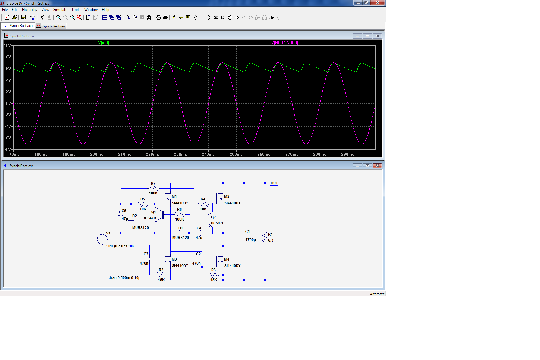

Synchronous rectifiers are not inherently cleaner or noisier than their natural switchings counterparts: they are what the designer managed to achieve, but at least there is some control: with a traditional diode, you are stuck with its rev/rec behavior, but with a synchronous rectifier, you can achieve the best or the worst using the same components, it's just a question of control strategy.
Note that if you want to experiment, you don't need a specialized IC: it is relatively easy to come up with a simplistic discrete circuit doing the same.
This example was designed to convert a 5VAC filament supply into a 6.3V DC one.
It is plain vanilla as shown, but since it is completely discrete, you can tweak it towards any target: cleanliness for example, if you add transition-control components

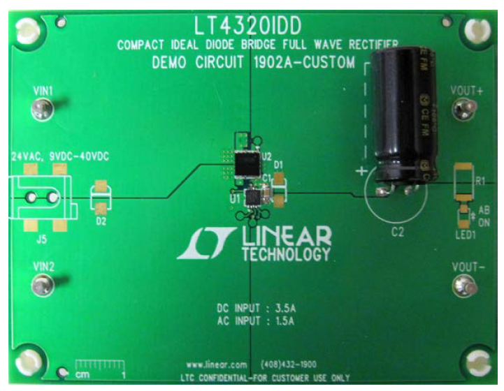

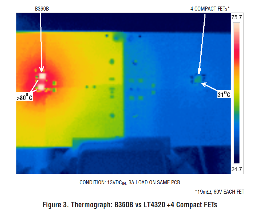

I ran across the LT4320 active bridge last night and found the example in data sheet particularly enlightening: that a 3A bridge can be made using tiny SMT quad MOSFETs and it doesn't heat up at all - no heatsink. Recently I have been building cap multipliers for Class A amps drawing upwards of 5A and notice that the square puck bridge rectifiers get plenty hot, even with a good heatsink. The loss of power, drop of voltage, and requirement for a large heatsink at these currents are problematic.
https://www.mouser.com/datasheet/2/609/4320fb-1271125.pdf
Look how small the controller and the 4 MOSFETs are:
attachment.php

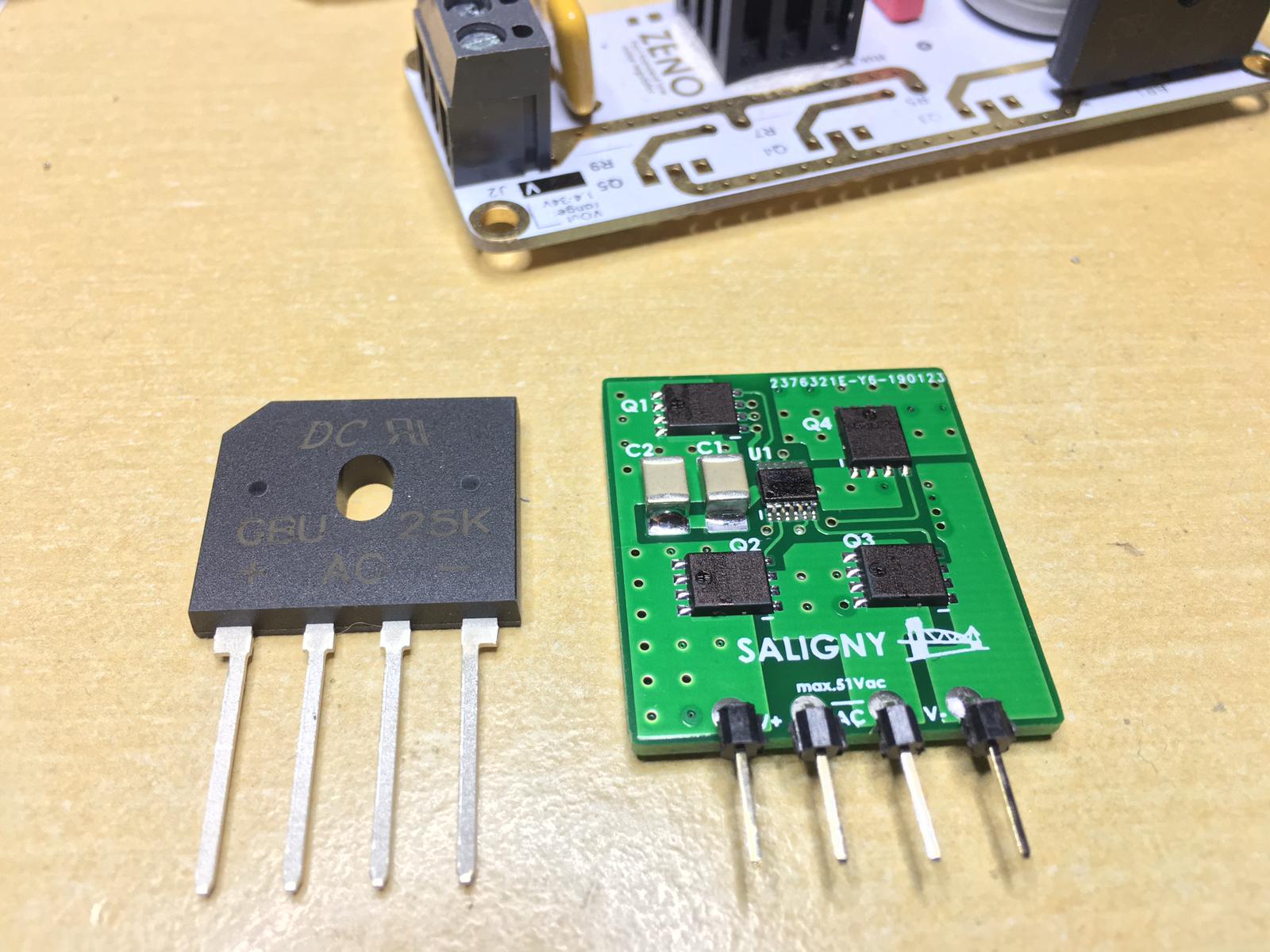

And here is the comparison vs regular diode bridge for same current:
attachment.php
The size is so compact, it could easily be snuck into the real-estate of typical Class A amp PCB and eliminate need for a heatsinked bridge.
