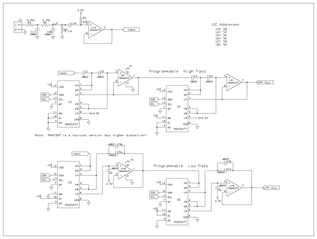

I prototyped a "different" approach a while back just to see if it would work. It does work just fine, although I haven't taken any measurements or even listened to it critically. It's just standard SK filter topology but with all resistors replaced with digital potentiometers. Unfortunately, the chips are a little pricey, so for what it does there may be better solutions.
The attached schematic doesn't show the microcontroller that provides a USB interface for programming the potentiometers. Also, there is another page of the schematic that isn't shown with BSC and volume controls.

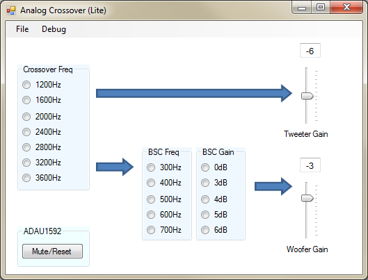

The second attachment shows the GUI for controlling the filters--it works great. Once programmed, the board stays programmed, and the micro will read a pot to control the master volume.

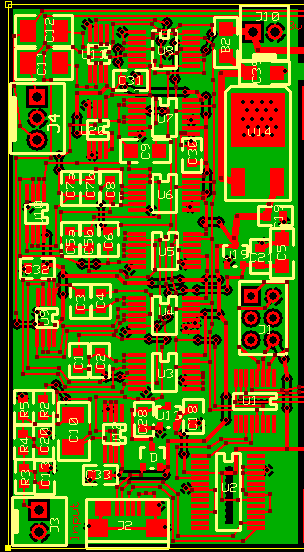

If someone wants to take some measurements on this circuitry I will be happy to ship it off. This circuit hasn't been a priority for me, but I would be interested to see how well it performs.
