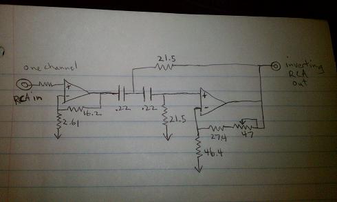

I want to build a 2nd order active bass boost circuit for a boost of 10 dB @ 33 Hz.
I found some schematics, but don't you need a buffer stage of some sort? What about an input and output stage?
I don't know much about building these things, but I have built an active crossover before with step by step procedures. I don't really know how it works exactly so I am kinda flying blind here.
I have the components leftover from another project and I know the values of the resistors and caps. I need. I just need guidance on putting it together.

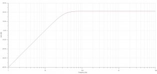

I can see it now. That's a High Pass Filter, not a boost circuit. Plus there's a lot wrong with it. I have to go eat now, but i'll post back to you later 😉
A peaking high pass is generally better than a peaking all pass in the bass.
For higher boosts a peaking second order is best combined with a 1st
order low pass step filter, often very easy to do passively.
rgds, sreten.

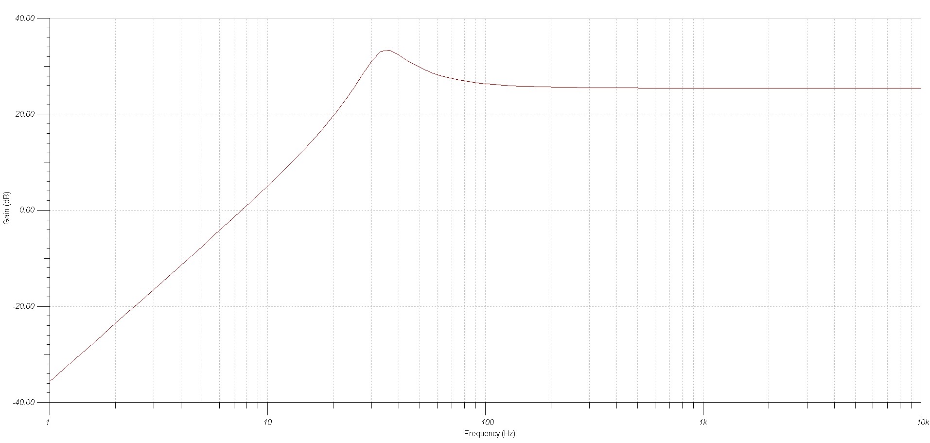

What values do I use to reduce gain?
The curve you are showing is about what I was looking for.
This will be for a 2-way speaker project.

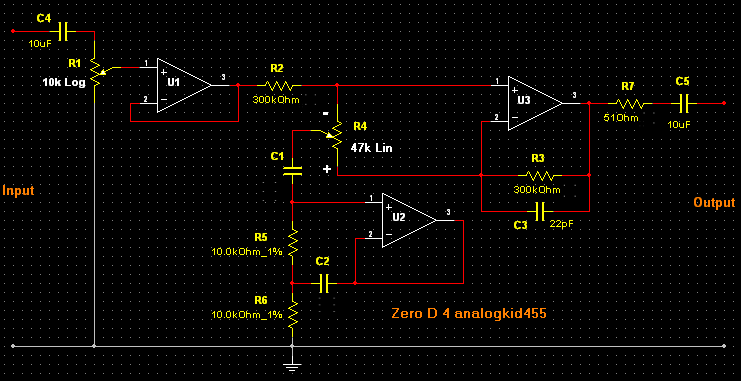

This should achieve what you want. It's a circuit i've modified for you, that i designed for someone else on here last year. Basically it's an Equalizer for one frequency.
33Hz - C1 = 140nf & C2 = 1.4uf
You will probably have to parallel capacitors to get the correct values, or near enough.
U1 - U3 are OpAmps. They could be individual ones, or just using 3 out of a Quad type. I havn't shown the Power Supply connections, as i expect you know how to do that ?
If you need more help, just ask 😉

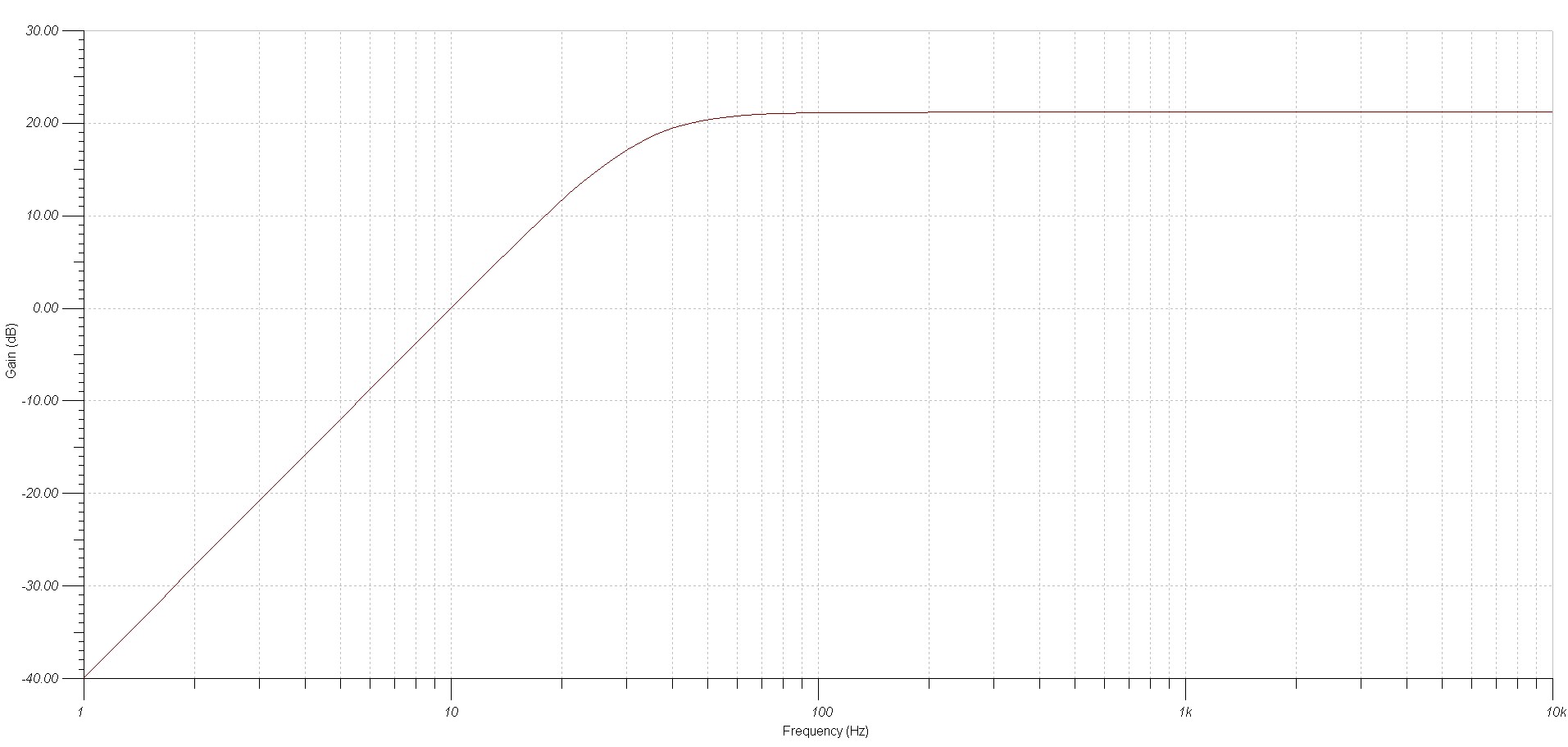

If you get rid of the gain in the first stage and make it a unity gain buffer, the pass band will reduce to about 8dB gain with 18dB total at 33Hz. You might be able to use a voltage divider at the output to reduce it further if necessary, but like I said before, it might be a little noisy.

Zero D, Thank you for the circuit! That seems to be alot better than what I came up with. That's all I really need is a 1 band EQ. Would the Q be .5 on that circuit?
Also, I think I know how to hook the power up, but maybe you should tell me anyway. I have a regulated power supply and I think I have to put a .1 cap from the + and - power input, to ground. Is that right? Hmm.
Michael, thanks. So no way around it being noisy? Can you refresh me on how to make it unity gain?

I said it MIGHT be a little noisy, especially if you knock the gain down with a voltage divider on the output. Doing it that way would end up increasing the noise contribution from the op amps, so depending on which chips are used and what the rest of the signal chain consists of, it could be an issue.
To use an op amp as a unity gain buffer, just connect the output directly to the inverting input (no resistor), and apply the signal to the non-inverting input. In that configuration the chip will amplify current instead of voltage to provide a buffering function.

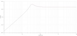

Pleasure !
I missed you wanted Q = .5 so i've changed a few things. C1 & C2 = 470nf & i've also made R2 & R3 = 43K
If you use single OpAmps + Supply goes to Pin 7 - Supply goes to Pin 4
If you use dual OpAmps + Supply goes to Pin 8 - Supply goes to Pin 4
If you use quad OpAmps + Supply goes to Pin 4 - Supply goes to Pin 11
Yes a .1 cap from the + and - power input to ground is a good idea, as are a 10uf electrolytics in the same positions. Your regulated supply should be + & - 12 to 15 volts DC.

Thank you Michael. I am using Burr Brown dual op amp.
Thanks for the changes Zero. The power supply has +12.09 volts and -12.15 volts to ground with a load. Current is 270mA.
