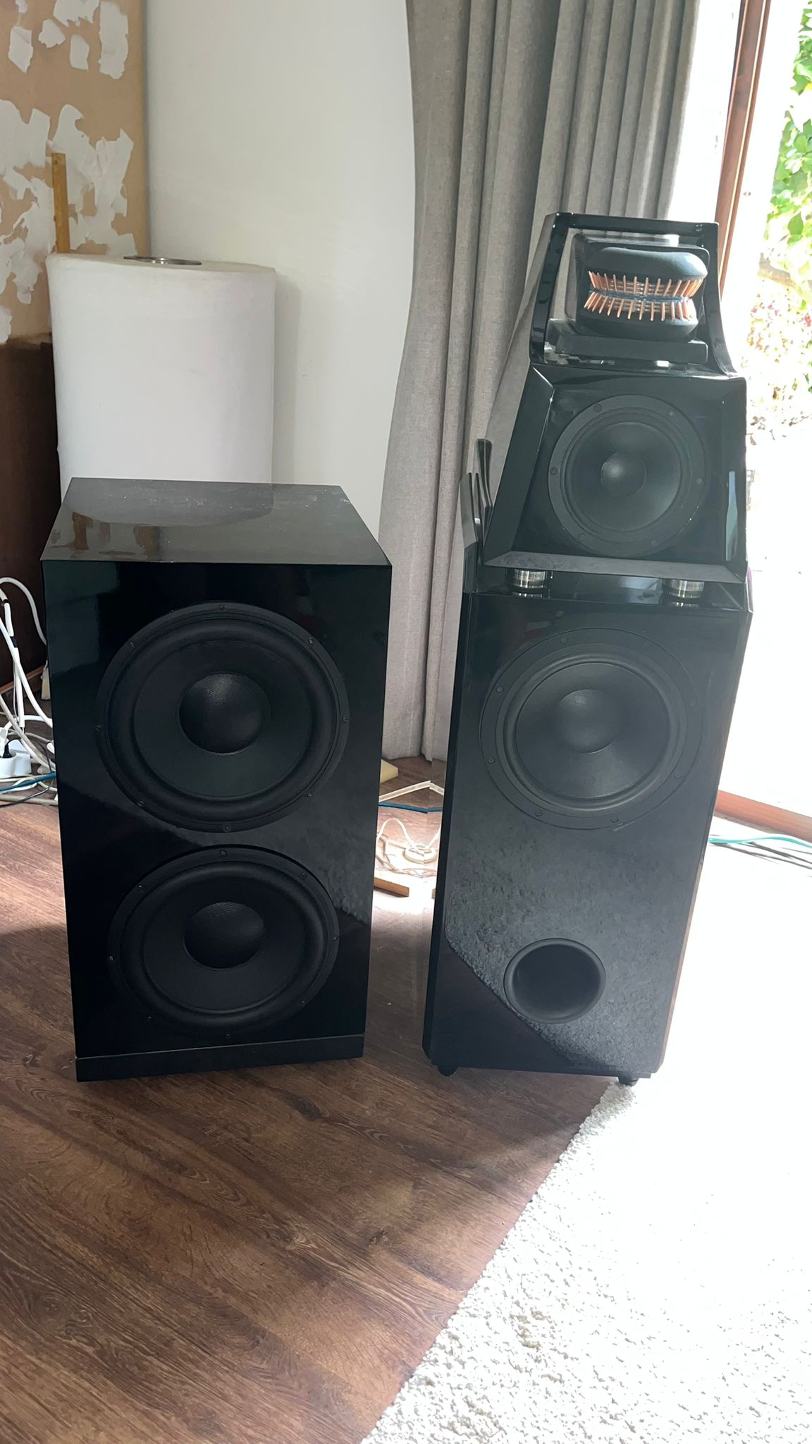

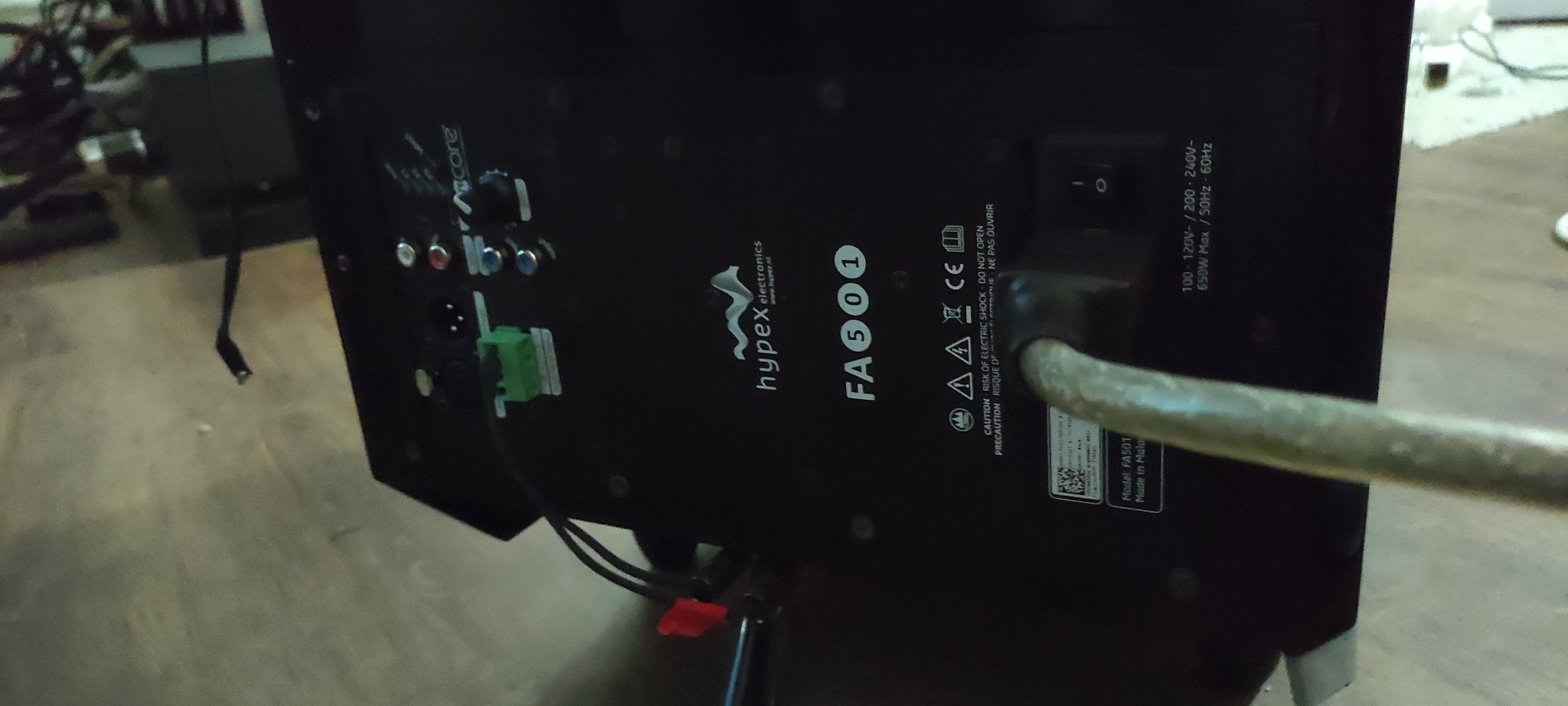

Hello, thank you all for the contributions and debate. When opening this thread I imagined that the digital filter vs analog filter debate would be inevitable. In that sense, I find it interesting to share this thread.
https://www.hifiwigwam.com/threads/active-analogue-crossover-vs-digital-dsp-crossover.95943/
In it the author presents a situation similar to the one presented here. He explains his experience with a model that he did not know about: The DBX 234XS. In any case, I want to remember that I am currently already using a digital active filter and DSP: the one for the bass section integrated into the Hypex Fusssion 501 amplification module. Together with those used for the subwoofers, I can control with a certain margin the highest frequencies. complicated from 20hz to 200hz.
I have also commented that the use of the analog active filter does not necessarily imply dispensing with the passive filter and the correction components it incorporates.
So it is important to remember that actually my idea is to combine two different types of filter: digital for bass (I already use it) and analog for mids and highs.
I am currently satisfied with the response curve as well as the RT of my room. The Mcintosh mc452 stage can correctly handle the amplification of mids and highs but I can't help but think that this amplifier's power is wasted and that, by stopping it from uselessly amplifying the frequencies from 20 to 200hz, its performance and sound could improve. Maybe the best solution is to do nothing
