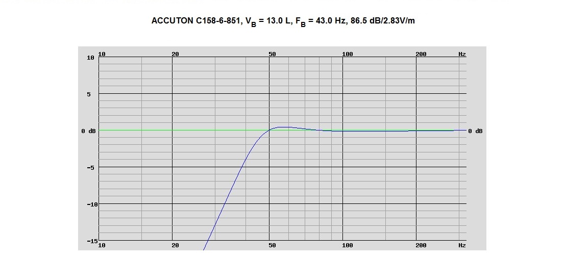

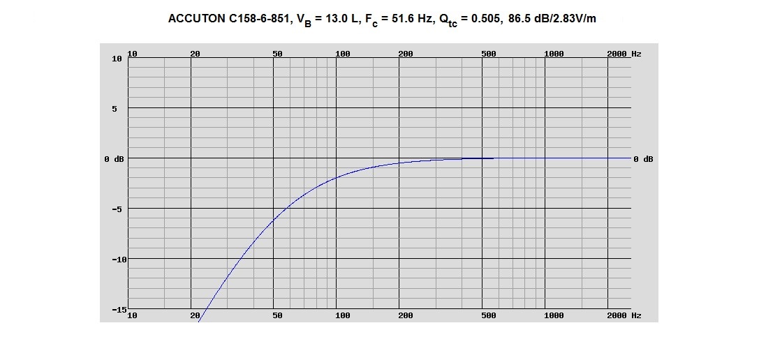

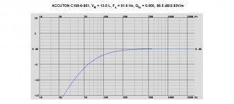

Making it with the Duets and a simulation of the enclosures as close to the original as I could you have (fig.1) for the 12-14L and 43Hz with bass response -3dB@42Hz. If you change it to a sealed (simulated, closing the ports with something flexible) speaker you get (fig.2) with a nice frequency drop at about F-6 dB/50 Hz to 150Hz/200Hz (flat), so that would be my target for the upper woofers or 40Hz - 150Hz. In 4*Pi (LF) you have 82.5 dB/2.83V/m (2*Pi 86.5 dB/2.83V/m) so that you know the sensitivity +/~required for the woofers since u will be multi-amp.
If you want to build a similar encloser to the pictured by you "Modulari Duo" you can use the similar alu ScanSpeak 8 or 10". In the same way you can use the very high quality Accuton woofers in a similar 90L sealed enclosure.

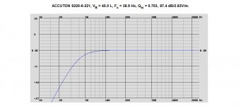

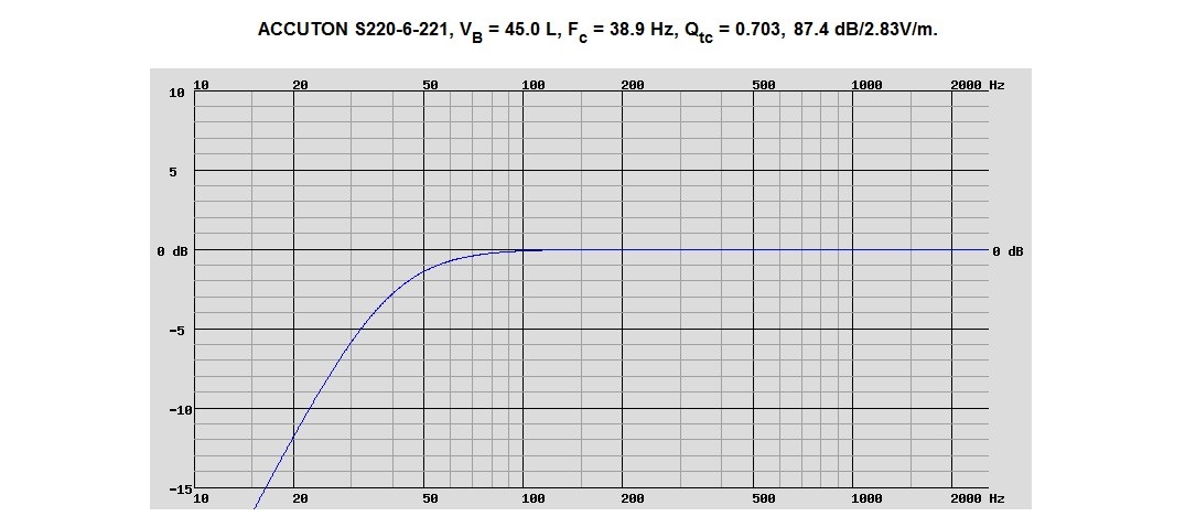

Considering that you have/need some BSC at some point with the room and speaker front baffle more the XO conjugate, you will have to match that with your subs (IB), that if you go with Accuton S220-6-221 8" link - you have in a 45L sealed plenty response to 40Hz (F-3dB@39 Hz) with one driver, having in 4*Pi 83.4 dB/2.83V/m and 89.5 dB/2.83V/m with two drivers in parallel and a sealed 90L.

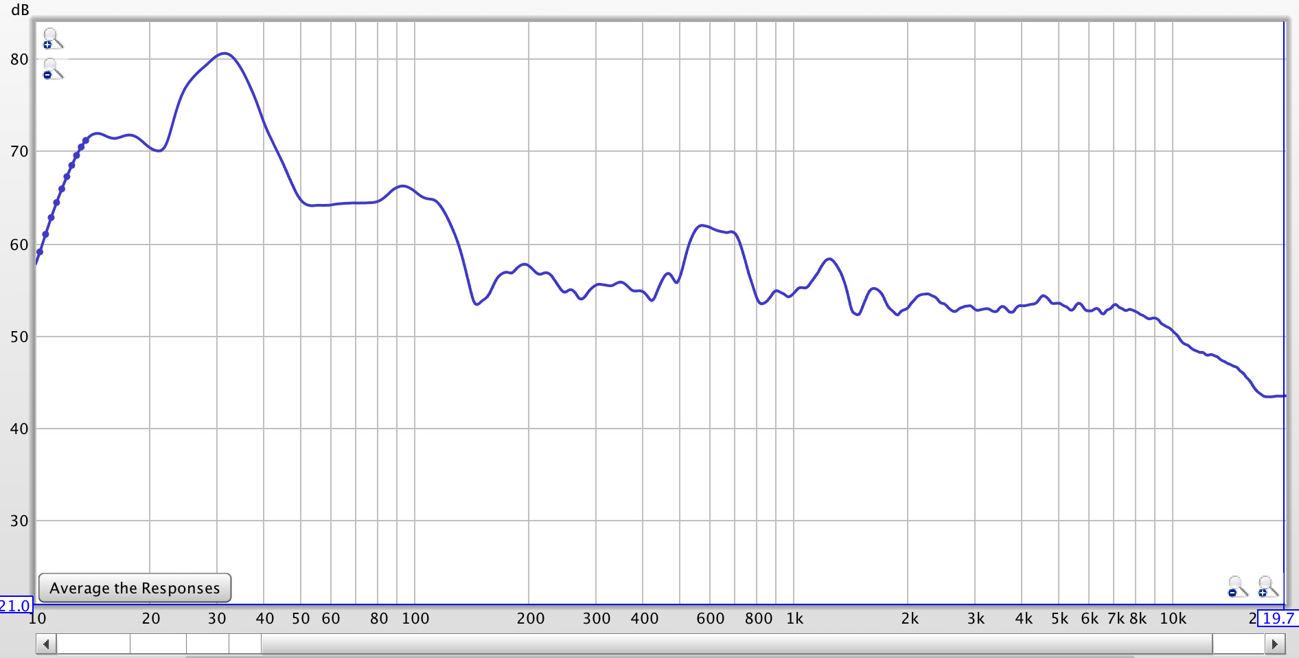

Correct.. Everything I listen to has been digitally equalized to correct for room issues and taste. The difference in sound quality after EQ is the difference between $300 speakers and $20,000 speakers(and I do have $15k speakers). I use Dirac as the first pass at equalization and phase/impulse correction(jury still out on that). I will soon have the ability to parametrically EQ and cross over each driver in the system as well.
I have some bass traps and diffusors and absorbers as well - best to fix the room and not try and EQ problems away as much as possible. Below is the treated room response without any EQ.
I am not going to build speakers/bass cab that only go down to 80Hz - just for resale type issues if nothing else. I may or may not use 40-80Hz region depending on how it sounds and interacts with my room and the IB sub.
