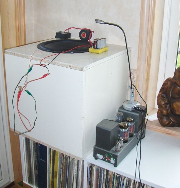

Did anyone manage to build an absorber based on Nelson's Shadows? What was your experience?
At this side of the Atlantic we are currently trying...
But since the discussion on that forum is in Swedish, you probably only can enjoy the pictures.
So far we have got a circuit diagram and PCB layout. You can find it in this thread:
http://www.hififorum.nu/forum/topic.asp?TOPIC_ID=70570&whichpage=12
Look at the post done 2009/09/25 : 21:37:46 There you find links to schematic, PCB and component list.
One prototype absorber have been built from this. It's in action on page 15.
http://www.hififorum.nu/forum/topic.asp?TOPIC_ID=70570&whichpage=15
It wasn't me who built that one, so I can't take credit for it.
I include a picture from first test run here as teaser, it's true DIY style:

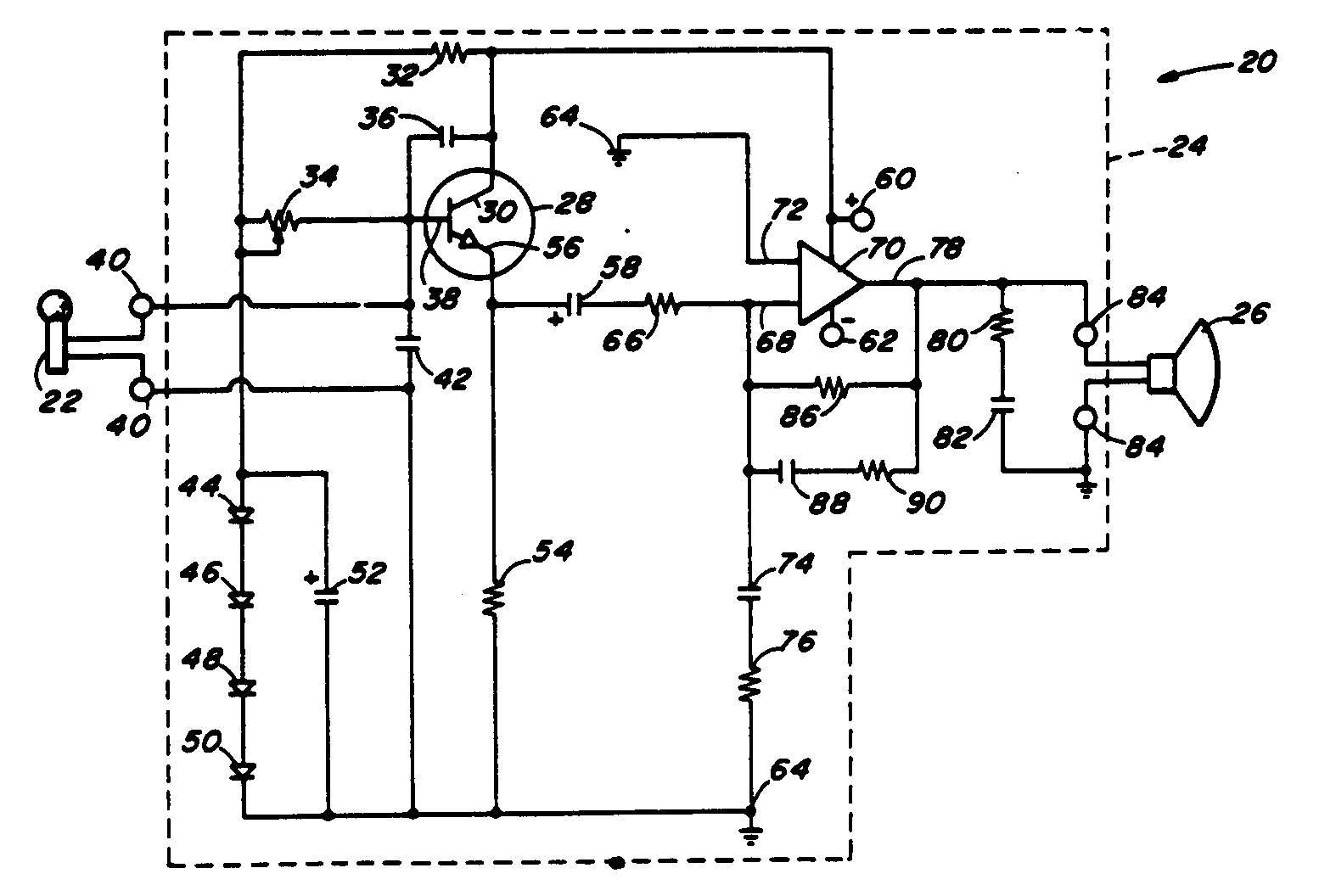

During last winter, more work have been done. Resulting in schematics, a PCB and experiments.
The schematics have been upgraded with a Linkwitz filter to get better low frequency property.
The patent claims a 20-200 hz effective response,is that just due to the shallow 1st order roll off allowing it to still be effective that low?The production piece had a single pole rolloff above about 100 Hz and below about 70 Hz,
This looks interesting and I want to give it a try with a pair of 8" woofers that I have on hand.Their response in a sealed box begins to roll off below about 65hz,should I add still provide a single pole hi pass filter at 70 hz?
The rolloffs are there to keep the system stable, since the
phase of the loudspeaker/microphone combination varies
enough to cause oscillation (motorboating) with higher amounts
of feedback over a wider band.
As it is, only a little feedback is required for it to be very
effective.

post 44, 45 etc was based on misinformation. I apologize!!
Just forget that schematic and the EQ section, it does not work as intended.
If you want to extend the fs to lower frequency, do a coating of the element to stiffen the membrane specially close to the interface between membrane and voice coil interface.
The phase margin after the filters was ruined... and as a result the open loop feedback was not sufficient enough to create a good absorption!
So... all capacitors in series between the mic and the amplifier output has to be as large that the high pass pole should be less than approx 2 Hz. Or removed completely!
So it is actually much more easy to do than you might think.
Delete the EQ!
Get a mic, place it as close to the speaker element as possible and also close to the center. Cut high frequency above 100-200 Hz.
crank up the volume (feedback) until resonance, and turn the knob down with a couple of dB.
If there is some high frequency tone "hanging" when you knock with the fingers on the cone reduce the feedback little bit more.
To improve the preformance even more build a box out of 1-2 inch rockwool to encapsulate the woofer/mic.
The woofer shall be put in to a closed enclosure and add damping material in that box too.
Place those absorbers in the corner of the room.
