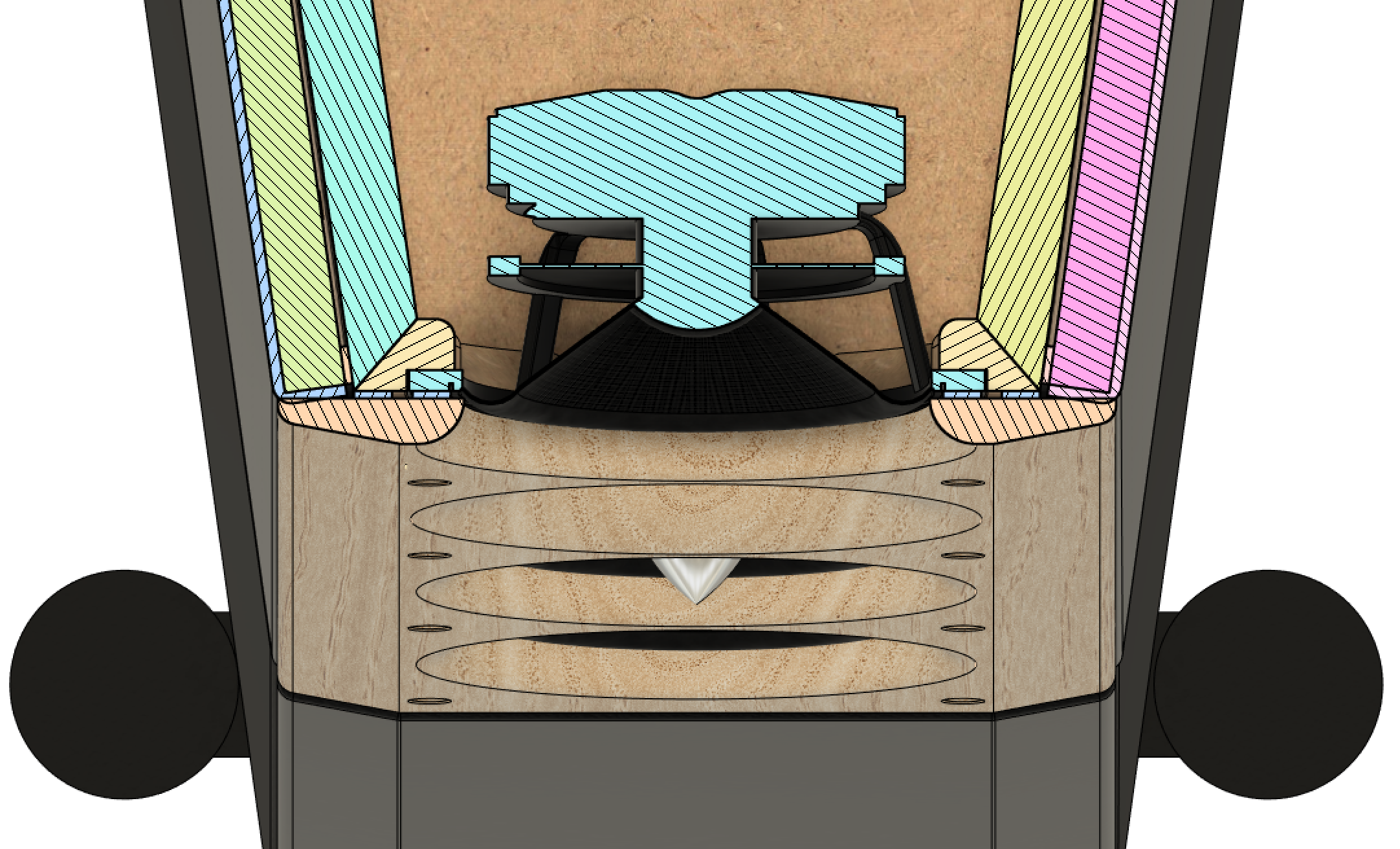

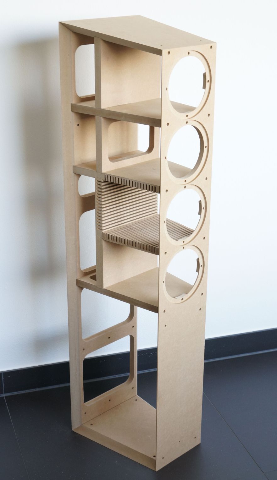

I indeed tried to minimise baffle diffraction. This is the section of how the baffle looks now in design for milling. If needed after measurements I can still sand it a little bit more round.

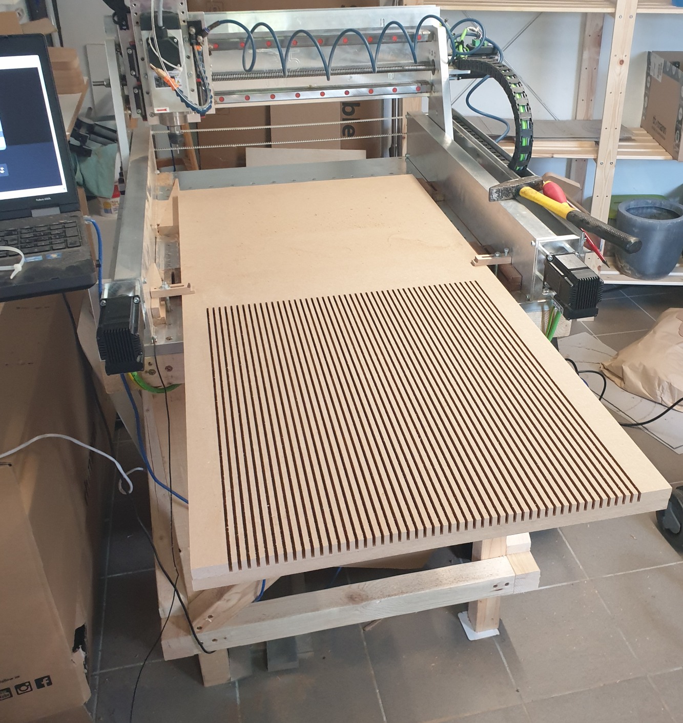

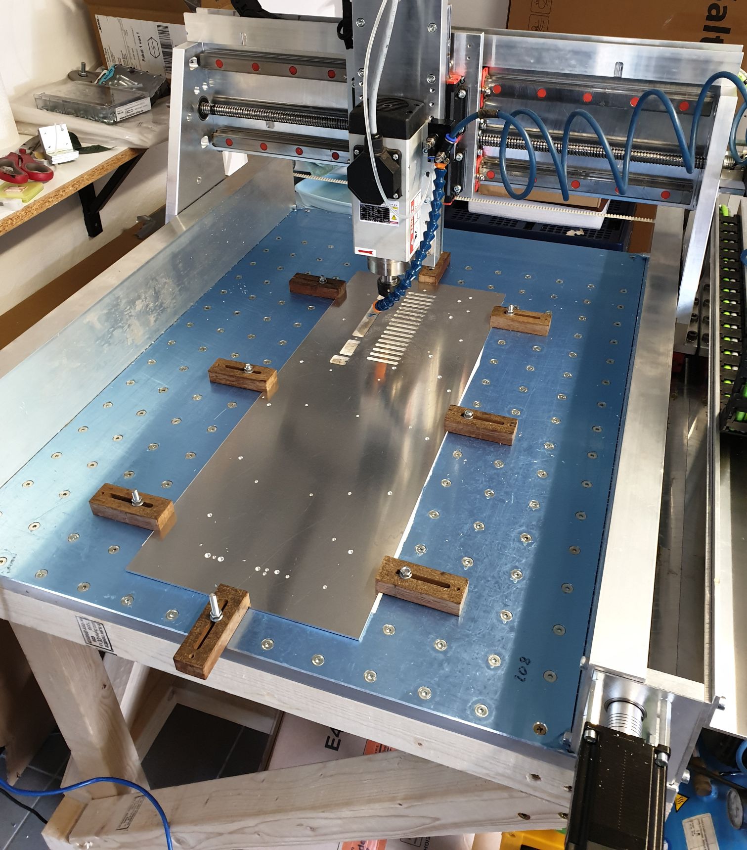

I do CNC machining myself in wood, plastic and alu on a self build CNC.
This project would be too complex to do without a CNC.
Any chance you have a build blog of the CNC. I'm currently looking into building one myself and yours look very well built
I have not done a blog myself but I bought the mechanical parts from a german guy who designed the machine. You can see how it is build here:
YouTube
I added controls, chinese servos and spindle and my wifes old laptop 🙂
I went for this one as it is really stiff and also very suited for milling aluminium.

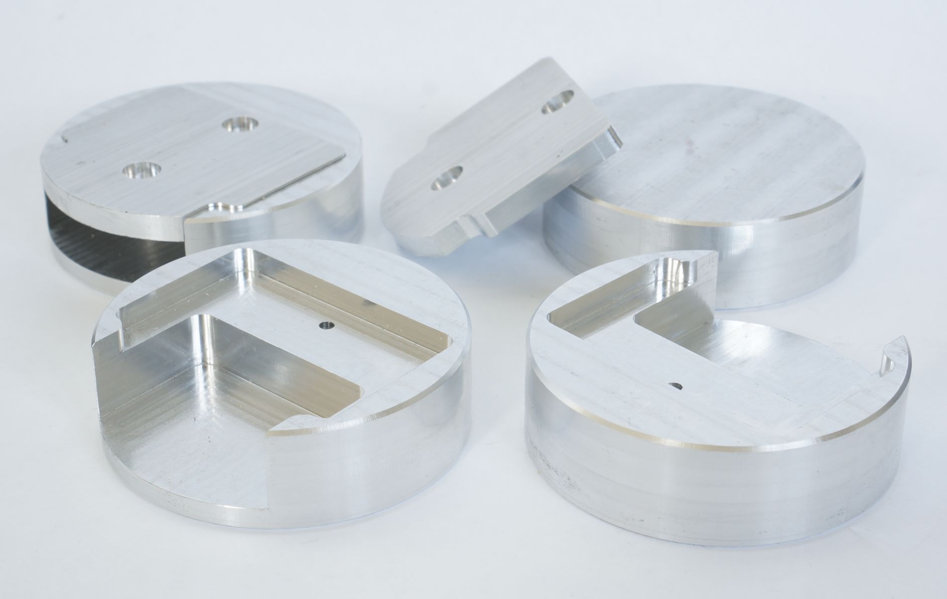

I have made some feet for the speakers on it this week.
YouTube
YouTube

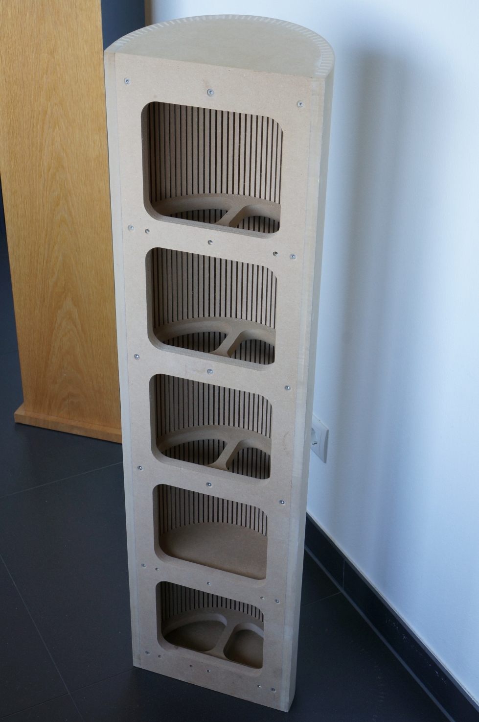

Hi everyone,

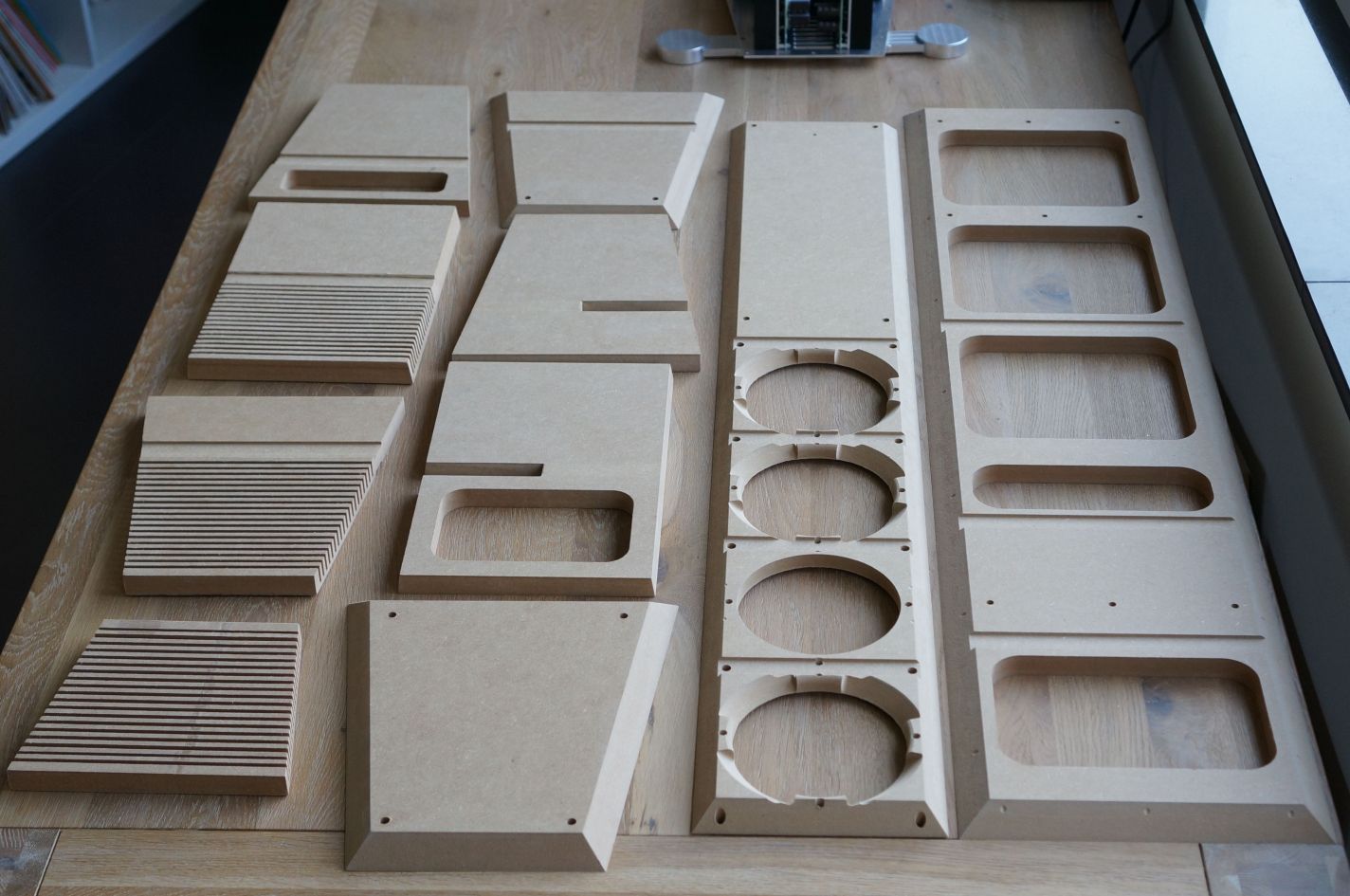

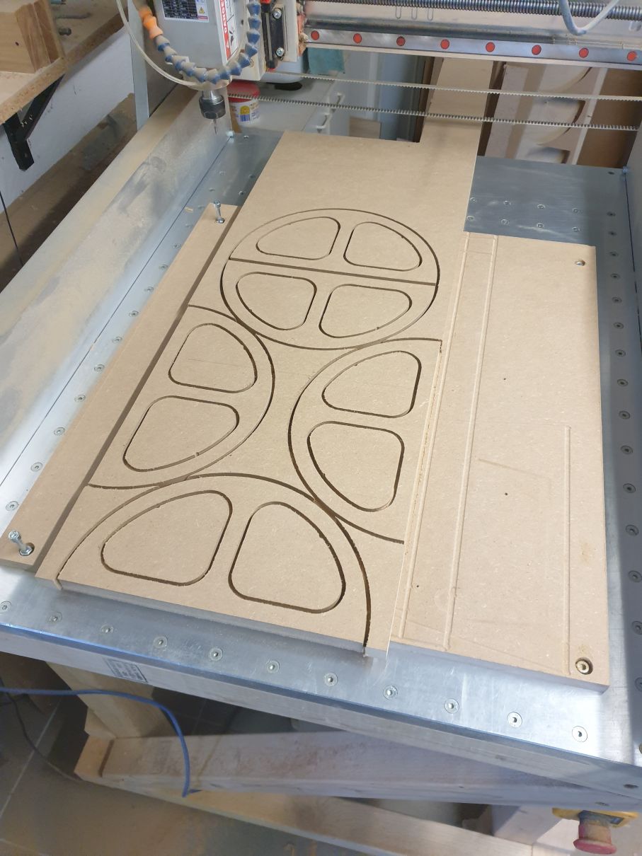

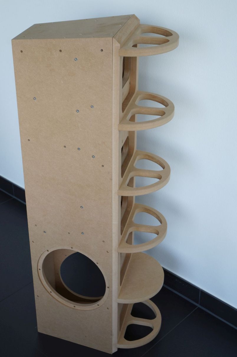

Today I had a bit more time to continue. I started with milling the mdf parts for the base structure. It all went well. I did a test fit and everythings fits nicely together. It even stands upright without glue or screws 🙂
Looking great! How did you machine the bevels, with contours and a ball end mill, or with a V-shaped bit?

I did the bevels with contouring in 0.5mm steps and a ball mill. Due to the tapered and slanted design none of the bevels are 45 deg. It does take some time though, more or less 15mins for the larger pieces.

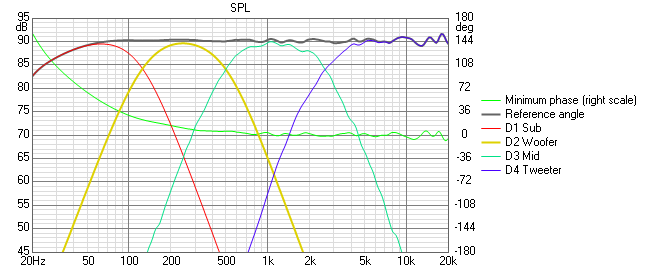

Indeed once build there will be a lot of measuring and finetuning needed to get to the required results. I did some simulations in VituixCad but I need measurements on the real baffles before I can really fix things.
