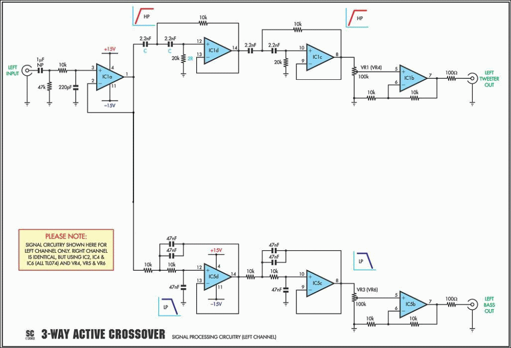

I love this xover, as a 2way, got some good sample IC's comming
(OPA4134UA) and Browndog adapters, I'm using only IC1 as high pass and IC5 as low pass both driven by IC1a. IC3 is totaly out of the circuit. When all was crossed over at 239hz it looked great on the scope and the 24db cut was acting fine both high and low pass.
Then I decided to use it at 160hz with the approprate resistor changes, the low pass cut nicely at 160hz, but the high pass just gives a little boost 1or2 db just before it starts to cut at 160hz, this did not happen at the 239hz it was flat up till the cut starts but at 160hz the high pass just boosts a little before it starts the cut.
Is there any explanation for this, as the only change is 2 resistors from 20k to 30k that go to ground at the input of IC1d and IC1c the caps remained the same 47nf. Is there some form of resonant circuit going on between the 30k and the 47nf that doesn't happen with a 20k resistor?
The low pass IC5 had no such problem with the 160hz setting

You also need to change the 10K in the high pass to 15K. As it is now you have two sections of your filter at 160 Hz. and two at 239 Hz.
If you made this change and still have a bump it is likely due to the caps being out of tolerance. You alter the Q as well as the tuning if your caps are off. Sallen Key topology is fairly sensitive to component tolerances.

BobEllis said:You also need to change the 10K in the high pass to 15K. As it is now you have two sections of your filter at 160 Hz. and two at 239 Hz.
Why would the caps be out of tolerance now with the 30k's in place and not when the 20k's were there, same caps unchanged?
Here is what I've done, the high pass 4 x 2.2nf are 47nf and the 2x 20k are 30k. The low pass, 4x 10k changed for 15k.
The 47nf were the same ones when the xover was set for 239hz, then there was no slight rise in output before cutting at 239hz.

you have upset the Q of the high pass filter. You must change both the resistor sets. 10k>15k and 20k>30k
There are two parts to the 2pole filter wrapped around each opamp stage. Consider the low pass first, the feedback part through the 47n//47n and the passive part using the second 10k+47n.
The same applies to the high pass. The feedback part is the 10k and the passive part is the second 2n2+20k. Notice the 2R, R, C and 2C in turquoise but one R has been omitted from the top 10k.
The ratios in both parts must be kept the same.
The alteration would have been much simpler if you had linked IC3d pin 14 to IC1a pin1. then you could have used the 47nF in their original locations and only needed to change the eight resistors. Are the resistors set up in the form of DILs? 8 pin DIL socket allow easy frequency changes.
That is the big disadavantage of unity gain S&K. interlinking of Q with F which in equal value S&K are sustantially separated but now gain changes with Q. However there is MFB which separates Q, F and gain to make changes easy but cost one extra component and a lot of unmatched component values (a difficult one for the beginner).

Sorry Bob E, you were right.
I see now where I've made the mistake and getting the rise in output before the cut on the highpass section, it's not mentioned in the main schematic on Silicon Chip but the feedback resistor also has to change slightly from 10k to 15k not just the r2's going to ground at the input of each section.
I only found this out after down loading the Linkwitz Riley filter calculator program.
http://sound.westhost.com/project09.htm#download_esp_lr
A part left out by Silicon Chip on their main schematic.
Cheers George

Since the existing is rolled off at 125Hz you can use exactly this for your active crossover.
The passive is 2pole 125Hz. Add a 2pole 125Hz to make this a 4pole giving a very slight reduction in very low bass and no effective increase in power handling.
Now supply the bass amp with a signal from a 4pole 125Hz crossover.
The two pole into the passive mid/treble may be close to Butterworth or not (I cannot tell). Adding a second 2pole Butterworth gives the opportunity to go Linkwitz Reilly.
Cascading two 2pole Butterworth for the low pass gives your L-R crossover. This is what you have in your crossover. just adjust your frequency to 125Hz.
There is an alternative.
Move the crossover point to 2octaves above the existing passband of the mid/treble unit. i.e. 500Hz. Now build a 4pole L-R Hi and Lopass crossover. This will give more power handling for the Mid/treble but could be asking too much of the bass unit.
There are only two ways to find out. Ask someone else how the modification sounded or do it yourself.
BTW. converting the bass to active will change the Q of the speaker and you will hear the difference whether for better or worse.
Thanks Andrew, seeing my bass driver now has the better ACI SV12 in place of the Eminence rubbish, the QTC with the passive was still at .9 because of the series impeadence of the xover, this was with both drivers, but now with the active it is .65 and sooo much better it's not funny.
The top end will wait till the OPA4134UA are in, if they don't still meet my expextations for transpaency and separation, I will go back to using the passive for the high pass, and bring the active low pass back to 125hz.
I will wait and see what the OPA4134UA will do, but to my ears the best opamp in the signal path in the mids and highs maybe no opamp at all .
