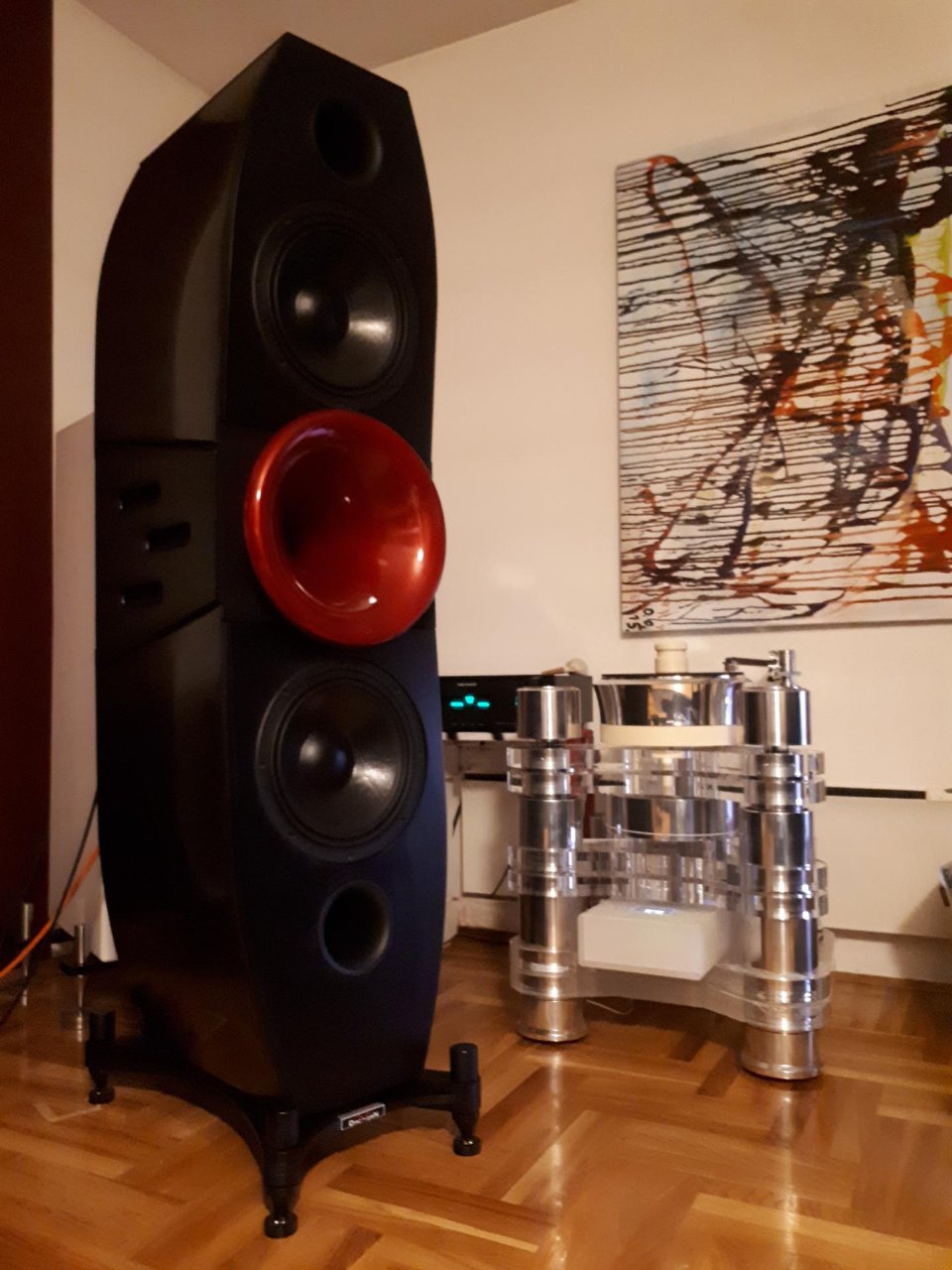

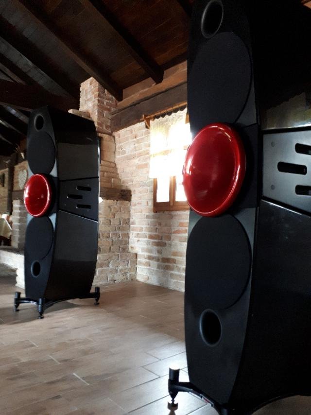

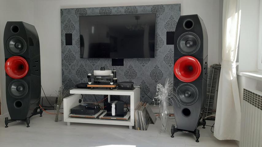

Hello everyone. I decided to present here a project of active speakers that I have been working on and developing for years. These are 2 system speakers with 2 bass drivers of 12 "(Sica 12sr 3cp) and 2" (P-audio SD 750 n) in a 340 mm diameter Tractrix fiberglass horn. One day it may be a commercial product but for now it is still not since it is just a prototype. The speakers are active with slightly modified Powersoft amplifiers (2x600W) ⁶and their original DSP Lite modules. The construction of the speakers is made of MDF and plywood coated with 200 gr. Carbon canvas and multiple coats of Epoxi resin. We can say that the speakers are a finished product, but their development is still ongoing, so any criticism or suggestions are welcome.
