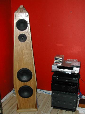

It's correct that it is to be used with a loudspeaker.
My current filter is 24dB/oct. linkwitz-riley filter, using TL082 opamps. Caps are BC Components MKP460/464 1% I believe.
I'm planning to improve it, even though it sounds ok.
I have read in other threads that 12/18 dB/oct. sounds better than 24. Isn't that a question about what speaker units you've got?
Think I've heard something about the better unit the softer crossover. Is that true?

TL082 is a pretty crummy op-amp (but useful for checking that the crossover works). I have used OPA2604, or you could use OPA2134. Either will be much lower distortion and noise. Because S&K filters work by positive feedback, it is important to have a low-distortion gain device, otherwise the distortion goes up around the crossover frequency. I think you will hear a significant improvement simply by changing the op-amps!
24dB/oct Linkwitz-Riley is the ideal filter from about 700Hz up when drivers can no longer be considered coincident and phase/amplitude response is important. At lower frequencies, <300Hz, it can be more useful to use an 18dB/oct filter because the power response is flatter.
The most important thing is matching the two channels and getting driver levels right, for which you need some sort of MLS measurement system, such as Liberty Audiosuite (or whatever its current incarnation is called). Having the loudspeaker in the corner of the room is going to add problems...

Boundaries
Any loudspeaker in a corner is in trouble. When you put a loudspeaker near a boundary place (for example standing on the ground in an open field) there is a reflection of the source. In effect, the loudspeaker sees on a 2pi (hemisphere) space, rather than 4pi (sphere). Output rises by 3dB. But when the path length from the source to the mirror, and back again is half a wavelength, there is cancellation. With only one plane, the cancellation is quite mild. With two planes, (floor and one wall) the cancellation becomes deeper, and the rise below cancellation is 6dB. With three planes (two walls and floor) the cancellation becomes noticeably deep, and the rise reaches 9dB. The relevent paper is, "The Influence of Room Boundaries on Loudspeaker Power Output" Roy F Allison JAES June 1974 Vol22 No5 pp314-320.
300Hz is a grey area. Get those speakers out of the corners, and then start worrying about crossover slopes.

EC8010,
I can get the speakers about 1m out from the corner, don't know if it's enough? The main problem is that the speakers stand 1.7m and has a weight around 110kg and the livingroom is only 30 m2 :bawling:

Small room
Yes, I know the feeling. The EC8010 theory of moving house is that the Hi-Fi is the last item to be packed/loaded (because playing music reduces stress). Therefore, it is the first item to be unloaded. It should be set up immediately (so that it can resume its function of reducing stress). Thus, it is positioned ideally, and frivolous items like furniture enter the room afterwards, if there is room, and they don't upset the sound.
Seriously, you can't do much about the bass boost, but you can ensure that the cancellations from each boundary don't coincide in frequency. 1m is the length of one wavelength at 344Hz, so your bass drivers (operating below 300Hz) are never going to suffer from cancellation because you can't move them far enough away. For your loudspeakers, the boost caused by the boundaries is helpful, and allows you to reduce drive to their amplifiers. (It looks as though it was deliberately designed to allow for room effects.) Conversely, your midrange driver is always going to have some cancellation due to boundaries, so it is important to make its distance to each boundary different, and not multiples of one another. Probably, the best results will be obtained with the loudspeakers back up against one wall, and spacing of the midrange driver to the adjacent wall 2/3 or 3/2 the distance to the floor.
