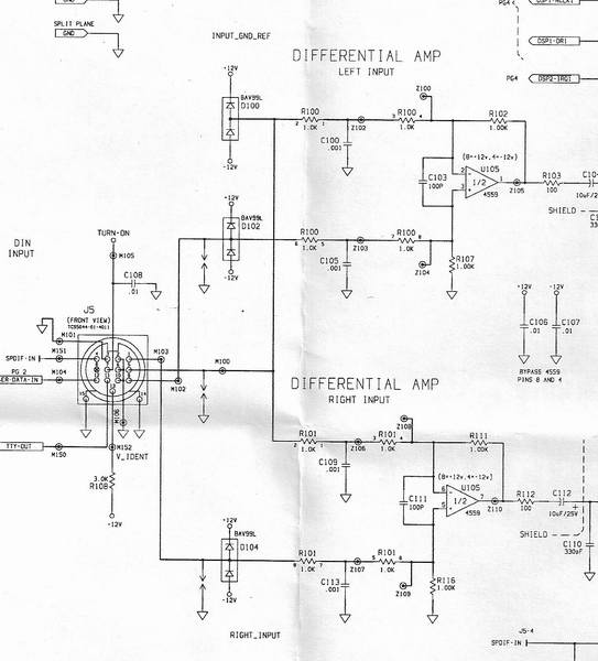

My Problem is a lost audio input Cable for an Bose Acoustimass 25 series 2 Subwoofer to the Music Center. I know that the normal cable Partnumber is bose PN-253346 but there is no way to find out how it is wired it's some mytherios secret. i foud some pictures but stilll can not find out hoe this secret cable works.
If you could please help me out with making my own cable i would be so happy im searching for month now.

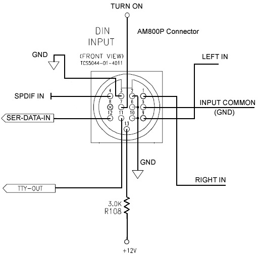

I'm also new in this forum but hoping you guys can help me out with the same problem as efelo, but the my connector input is a 8-pins connector.
My Problem is also a lost audio input Cable for an Bose Acoustimass 25 , i think its a series 1 and not a series 2 Subwoofer , to connect the serie 1 , its has a 8-pins connector. I,am looking allready daty on the internet but can not find
the Music Center. I know out how it is wired it's some mytherios secret. i foud some pictures but stilll can not find out how this shout be wired.
I have an Acoustimass 30 series II and Lifestyle 20 music center. I bought them in an auction, but I am missing the interconnect cable between the two. I am assuming they are compatible. The music center has an 8-pin and the Subwoofer has a 13-pin connector. I have seen several different cables that could fit my system, but I am not sure which one is correct. I would like to make my own using the diagrams from ukpete, but not sure if that is correct for my system. I contacted Bose for a part number, but they told me they don't like to give part numbers because they change(Interesting). Also ukpete, in the 8-pin side of your diagram I notice that pins 1 & 2 don't show a connection? I'm trying to avoid spending $30-40 on a cable.
This is a very late reply to this request for cable information but I have recently needed to check out connections of this very cable (Bose P/N 253346).
I have recorded the interconnection data in a spread sheet. Here is a pdf that may help those interested.
Hi UKPete,
Thanks for the info. I have recently moved to a new place and during the move, I had to cut the heads of the 13-pin and the 8-pin connectors (cable was buried in the wall) hoping to reattach them to the new place. This has proven to be very difficult until today (2019) until my search led me here.
So thanks very much for the effort!
