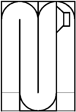

I would go with a 48" x 32" x 15" coffee table design (like my bed but smaller).
This will give you a long folded pipe of 139" or 24hz (each inner tube would be 46.5" x 12" x 6.5").
I would fire the ports downward for room gain.
You should be down about -3db at 20hz -- good for movie sound effects AND music.

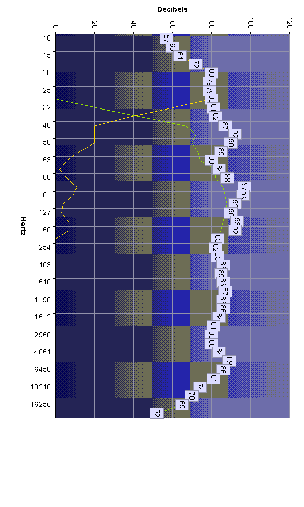

Bose Cannon frequency reponse charts...
I found these sweeps from two years ago. They are alot more ragged than I remembered.
The measurements were done from my listening position. The room is 12' x 14'.
There are two nasty peaks introduced by the Cannons.
92db at 45hz
97db at 90hz
I third nasty peak (89db) is at 5k from the horn-loading of the five JBL HLS610s.
Also, I am -8db at 17hz, and -16db at 15hz -- worse than what I had previously indicated.
The green line is a sweep with the subs off.
The orange line is a difference sweep -- showing only what the subs are adding to the frequency response.
Notice that although the subs cross over at 80hz, they are still +7db at 160hz.
I have a 15' delay dialed in to the subwoofer home theatre setting, with a volume setting of -9db (this was set at +3db when the subs were in 4 cu ft boxes).
Clearly the cannons are MUCH more efficient than the ported boxes they replaced
I am writing Santa for an 1/3 octave EQ (wouldn't a Rane Parametric EQ be nice)...

The Fs of the driver should be lower than the 1/4W of the entire length of the tube.
" Preferably, the loudspeaker driver is overdamped to avoid undesired resonances between the loudspeaker and the tube."
A Qts of 0.3~0.4 rather than an infinite baffle Qts of 0.5~1.0
" It may be desirable to use equalization circuitry to insert a notch in the system response at a frequency below that for which the tube length is a quarter wavelength."
Use a subsonic filter.
