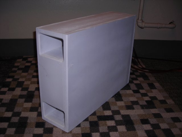

Business end of the bass module. The upper tube is the short tube, and the lower tube is the long tube. Tuning points are 168 Hz and 52 Hz respectively. It's not your imagination -- the lower terminus is slightly smaller than the upper terminus. This was a mistake.
More:
Another note -- this thing is quite efficient. The driver used has an efficiency of 83dB at 2.83v, and each Tang Band driver is 86dB (1w/1m) efficient, yet the Wave Cannon principle easily makes up the difference, and the system is nicely matched. Adding or removing stuffing from the upper and lower lines allows level matching through different parts of the passband, and can bring the overall level of the Cannon down to the level of the satellite speakers as well as smoothing the response. I used 3 handfuls of polyfill in the upper tube at the driver end, and then 2 handfuls of polyfill in the last bend of the lower tube (opposite the terminus). The driver is in the top rear of the enclosure, firing downward into the longer tube. The passive crossover networks (one for each channel) are directly below the driver, in the first section of the long tube. They don't seem to obstruct the tube.
While auditioning this system, I had the bass module behind the TV stand, firing into the corner. I only brought it out for the "money shot" of the entire system. Localization is a problem if proper placement of the module is not taken into consideration. For their Acoustimass modules, Bose recommends placing them along the front wall, firing parallel to the wall, across the front soundstage. This seems to work well with my bass module as well. A good way to describe the sound is that it sounds like a decent multimedia subwoofer, like some of those that are currently being distributed with multimedia speaker systems. There is some distortion happening, and the waveguide just takes those effects and boosts them just like they were the program itself. That's a fair disappointment when it comes to building something for hi-fi use, but this is more for casual listening.

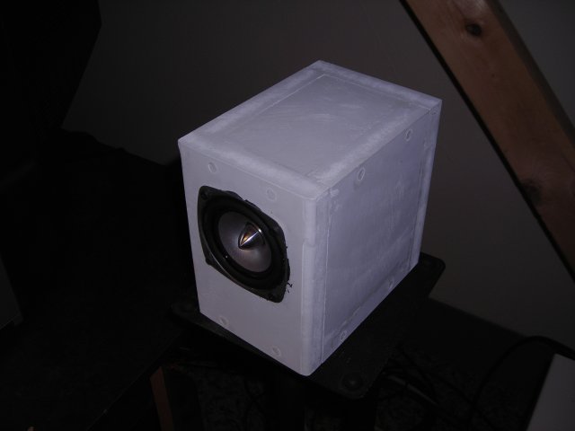

With some finishing touches those speakers shall look pretty darn cool. Do you have any more pictures of the woofer?
I think I'll have to design a new crossover for the system. The bass module is getting way too much midrange leakage, and the resonant lines don't provide much of a lowpass effect. I've added stuffing to the upper and lower lines (less stuffing to the longer line) to try to "damp out" the midrange which has leaked into the woofer, but it's just no substitute for an updated crossover. Perhaps a Linkwitz-Riley second order network is needed. I have a cell-phone picture of the woofer taken while I was applying glue to the cone (to stiffen it for woofer duty). I'll see about getting that posted up here.
Perhaps you can change the shortest tube into a basreflex much like the highest tuned part of a 6th order BP? Also with a Fs of 107 Hz it sounds like the low end mostly depends on the resonant frequency of the longest tube, hence the resonant-like sound. While the driver by nature does focus on the midrange which you don't want?
Wkr Johan
Wkr Johan

You can use two cannons next to each other with one woofer wired out of phase and on the other side than the other "paired" cannon. KISS-don't over think it!
The Bose idea just smoothed things out in the upper band of the operating range of the canon, if you have speakers that can already hit 80Hz-120Hz cleanly you are just fine!
I was somewhat disappointed with the outcome of my experimental wave-cannon bass module. I found that it needed a good deal of EQ to reach the lowest notes of its range with the same authority that it handled the upper end, and woofer excursion was a problem.
I've got a hypothesis, though. I think that it may actually be better to use a driver where the Fs of the driver is equal to the 1/4-wave frequency of the longer of the two tubes. This way, there will be quarter-wave loading of the driver diaphragm and some additional output down near the bottom of the cannon's range. I'm thinking of using the Aurasound 4" incredibly-high-excursion woofer, but Madisound is out of them, so I'll need to find another source. I contacted Madisound, and they said Aurasound recently stopped production of the drivers, but there had been rumors that production could restart in a few months. I think this particular driver will be the answer for my little wave cannon.
(Formerly known as BAM)
