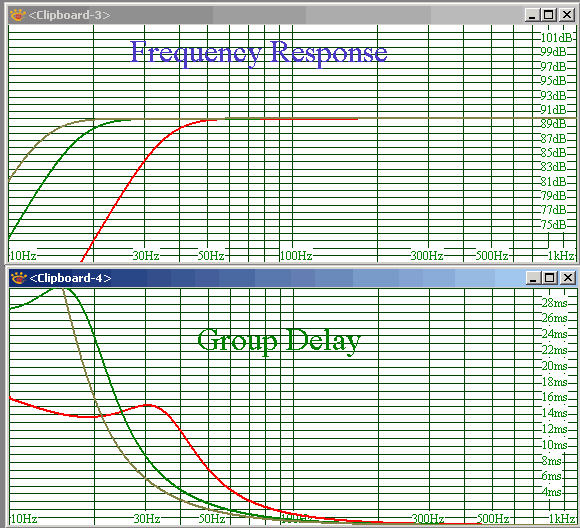

I guess the group delay depends on how deeply the box is tuned.
Below is a chart with the frequency response and group delay for that Swan driver. In all cases, the box is 2.5 cu ft.
In the red, the actual Swan 12 inch is put into a box tuned to 31 Hz. The Fs is 24 Hz.
Fs and Bl were modified in the Swan to give lower F3 in the same volume box at the same sensitivity. I will list the Fs changes-the Bl changes I will not.
Green line: Fs is 12 Hz. Fb is 16 Hz. Group delay is 30 milliseconds.
Olive line, (peak not shown): Fs is 9 Hz. Fb is 12 Hz. The olive line peaks at 40 milliseconds.
The olive line will correspond to a 1/24th frame. So if the cinema subwoofer is tuned to 12 Hz-a possibility-then indeed the port will be "one frame behind".
The deeper the tuning, the greater the group delay, even in the same size box. If the box were tuned to 22 Hz, it would be a half a frame behind.
So whoever told you about that "one frame behind" business is accurate if the box is tuned deep enough-are cinema subs tuned to 12 Hz, (full frame behind), or 22 Hz, (half frame behind)?
Remember that it has been shown that perception of such things as group delay goes down as frequency goes down-a group delay value such as 10 msecs would be very good at 25 Hz, not good at 100 Hz. That has to be considered as well.

I may have missed something, just jumping into this thread. But isn't group delay determined by the combination of driver and box parameters? So it's entirely possible for a low tuned box to have low group delay if the driver parameters are right?
I believe it is, Rich. I just kept the parameters the same as possible, changing only Bl and Fs on the Swans, to give a comparison.
Of course,parameters also determine where F3 is in relation to Fs. The better, (lower Qts) setups also give higher F3.
At some point, I'll see if I can do a comparison of bass tightness of ported speakers with the same F3, but different Qts and different Vas/Vb values.
However, for all practical alignments, group delay will be larger in the ported systems, although there will be differences among the ported systems.
As I recall, the best practical ported system had a step response similar to a closed box of a Qtc of 1.3. But I will see what I come up with later.
