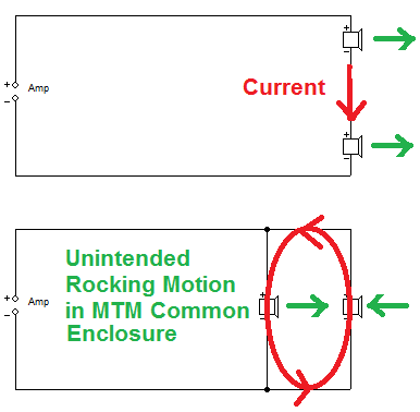

Mr. Erath when he did eight 15's in sealed cabinets.
Series / parallel in common volume.
Cutting edge back in the day. He was so ahead of his time.
Google Image Result for http://www.audiocircuit.com/A-Images/AA-Brands/L/LWE-LWE/8___________-F-003-906-LWE.jpg

Here is the cone displacement for SERIES wired:
Here is cone displacement for PARALLEL wired:
