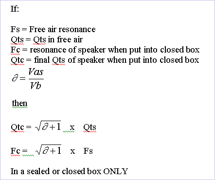

I have some articles here that define the Acoustic Suspension Design. As I recall, the classic Acoustic Suspension is:
Qts = 0.38
Box Volume = 1/3 Vas
This yields an Fc, (resonance in closed box) an octave above Fs, (free air resonance), and a Qtc double Qts. At the time, it was understood that you could make an Acousitic Suspension design with a box smaller than 1/3 Vas, but not larger.
All this is according to the formula:
Fc=(Vas¸Vb) X Fs
Qtc=(Vas¸Vb) X Qts
The reason they called it Acoustic Supension, (or air suspension), is becasue when Vb is much less than Vas, the springiness of the air in the enclosure had a much greater effect on the woofer than the woofer's own mechanical suspension. So the woofer cone is essentially suspended by the enclosure's air.
Nowadays, the terms have loosened up a little and an Acoustic Suspension enclosure is a closed box where the box volume is significantly smaller than the Vas.
By contrast, an Infinite Baffle is a closed box enclosure where the box volume is near or greater than the Vas. That is because the greater the volume of the box as regards the Vas, the less the speaker is affected by the air in the box, and the more it is affected by it's own suspension.

Sealed cabs become a ~ IB equivalent at 4*Vas if stuffed to yield a Qtc = Qts, and 10*Vas if not. Above 10*Vas, the mass of air in the cab begins to mass load the driver, lowering its Qts.
Strictly a nit-pick: Qts = 0.383. 😉
