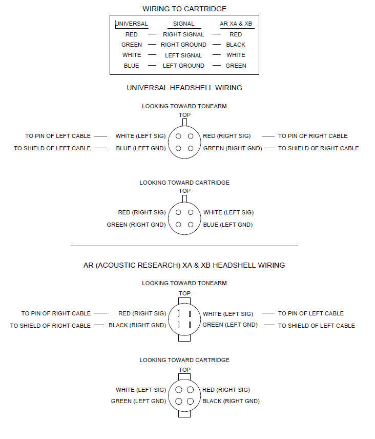

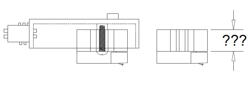

I've never had an AR77XB but you probably need the same screws that were used on the XA and XB. I've attached a pdf drawing that shows the hardware that was included with XA and XB headhshells.
#3-48 screws may be a challenge to find locally but McMaster-Carr has them.
https://www.mcmaster.com/products/screws/rounded-head-screws~/
I've also attached cartridge mounting instruction from AR.
