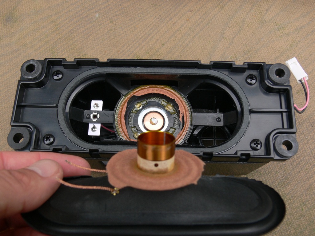

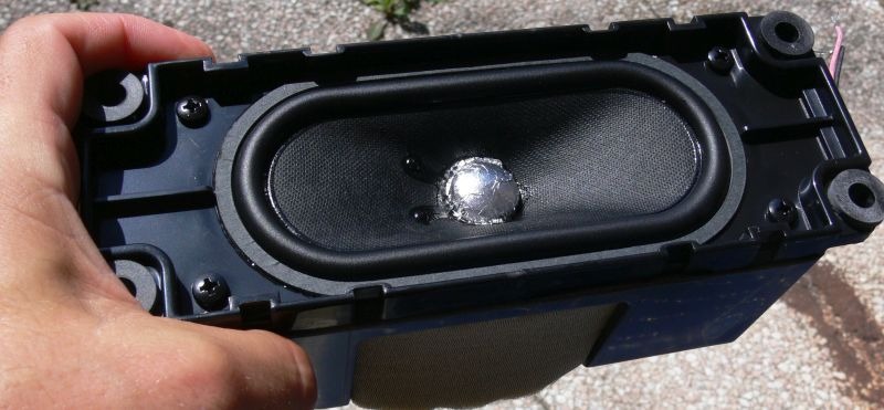

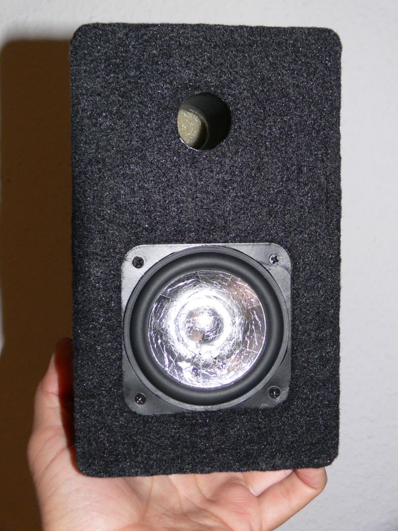

I am a big fan of loudspeakers with aluminium foil. So I do that myself if you cannot buy it. I take care to buy drivers with copper rings which minimizes distortion.

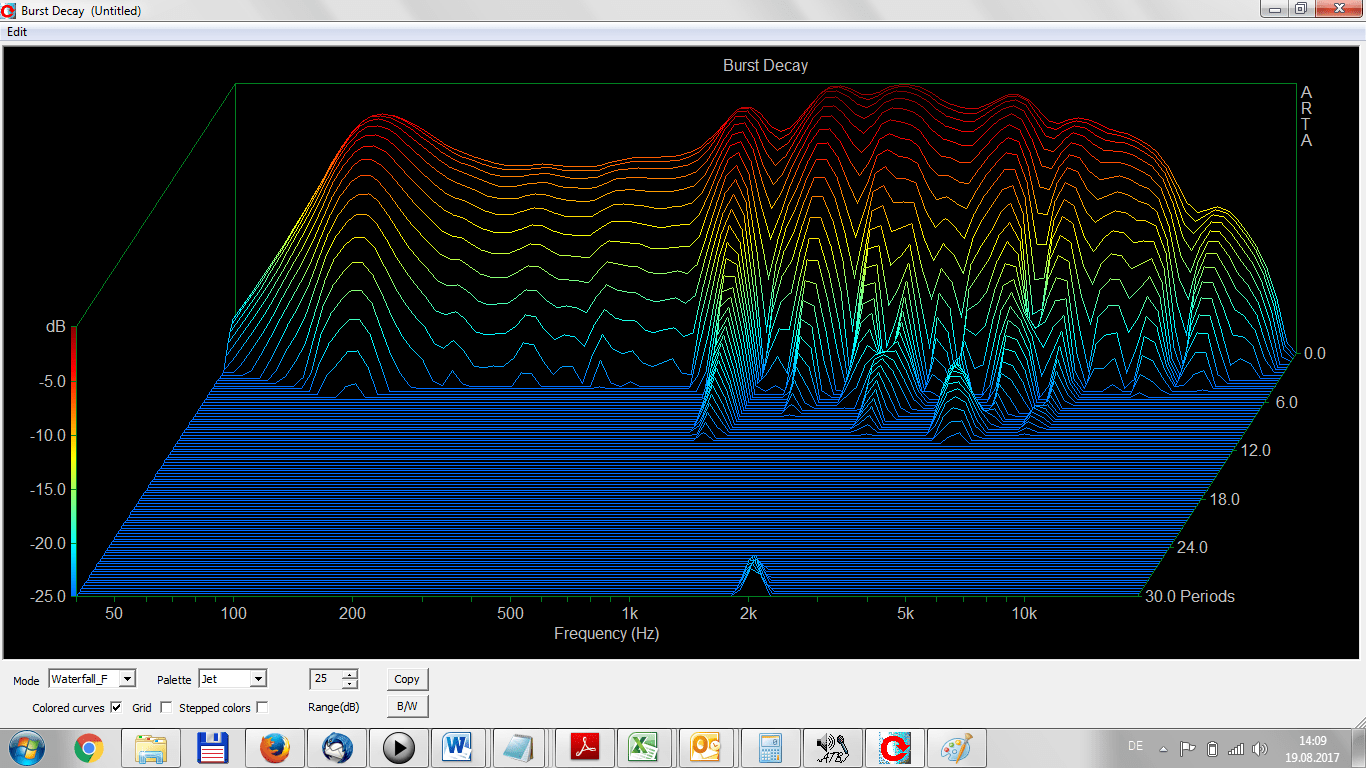

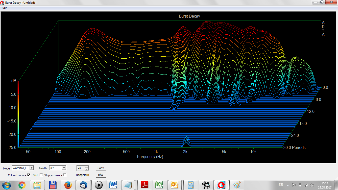

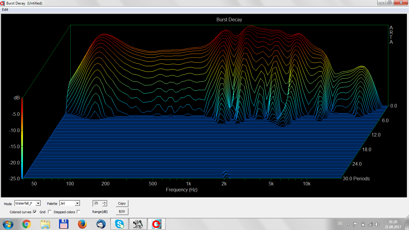

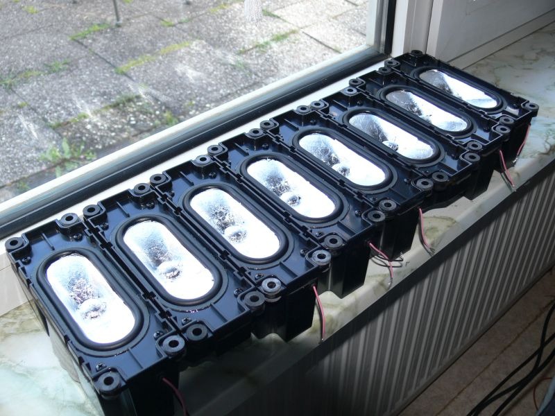

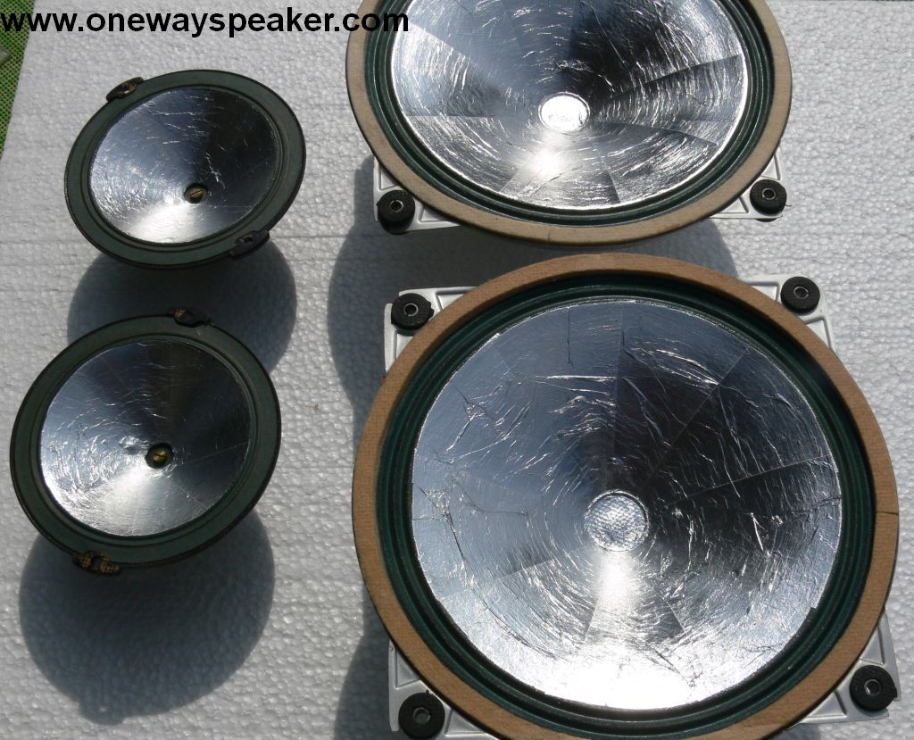

I have measurements before and after for many drivers. But often I did not wait until the glue has completely evaporated. I did not always document if the measurement was made immediately after the diaphragm tuning or not.
I have here however a Saba Greencone without aluminium, with one side aluminium and both sides aluminium. In the ones with aluminium the glue has not evaporated. After some time (I do not know exactly when, but certainly after two weeks) the water component in the glue has evaporated. Frequency response in the higher frequencies are damped by the heavier cone. But after some time the loss in the highs comes back as the diaphragm lightens up. However the aluminium used was very thin as this is a fullrange driver and weight should not be added too much.
As you put aluminium onto the cone it takes longer time to evaporate than usual as the foil prohibits a fast evaporation, especially if you do the diaphragm covering in one turn just to finish the job, I often do it like this. You should not force evaporation by heating the driver because bubbles can occur and you destroy the driver not only optically.
