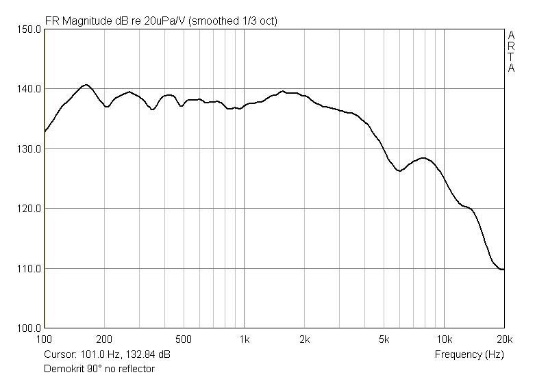

Actually I forgot to generate one diagram: 90° without reflector. Here is an older take for now (slightly different measurement setup).

0° to 90° in 10° steps - box without reflector/with reflector:
Box only:
Box with elliptical reflector:

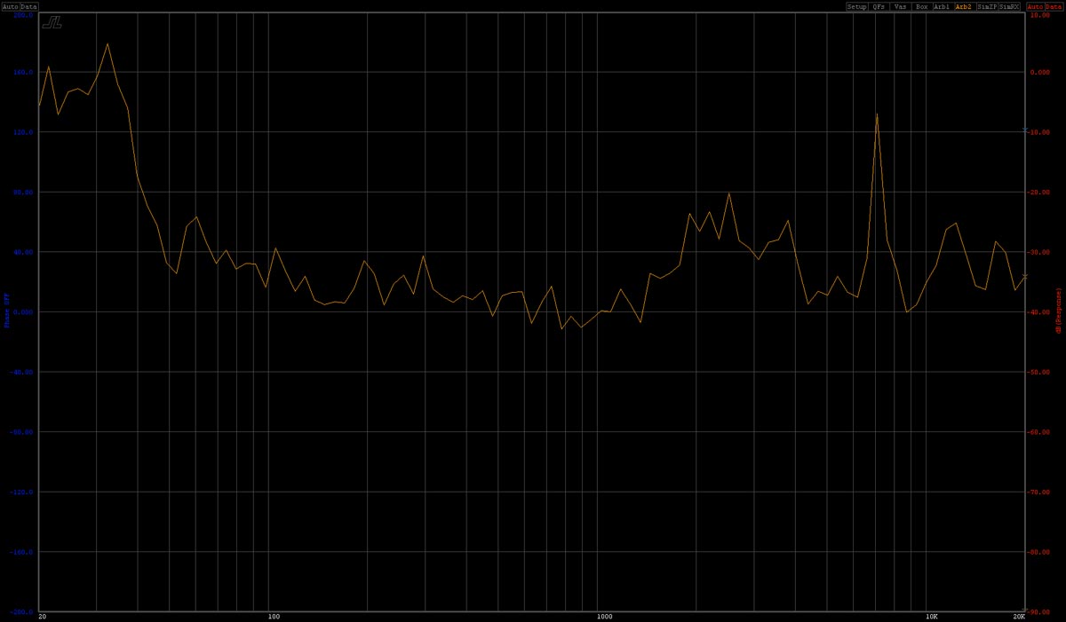

What speaker / reflector is that ? If your program can be switched to black and white because the scales are hardly legible would you please re-post the pictures ?

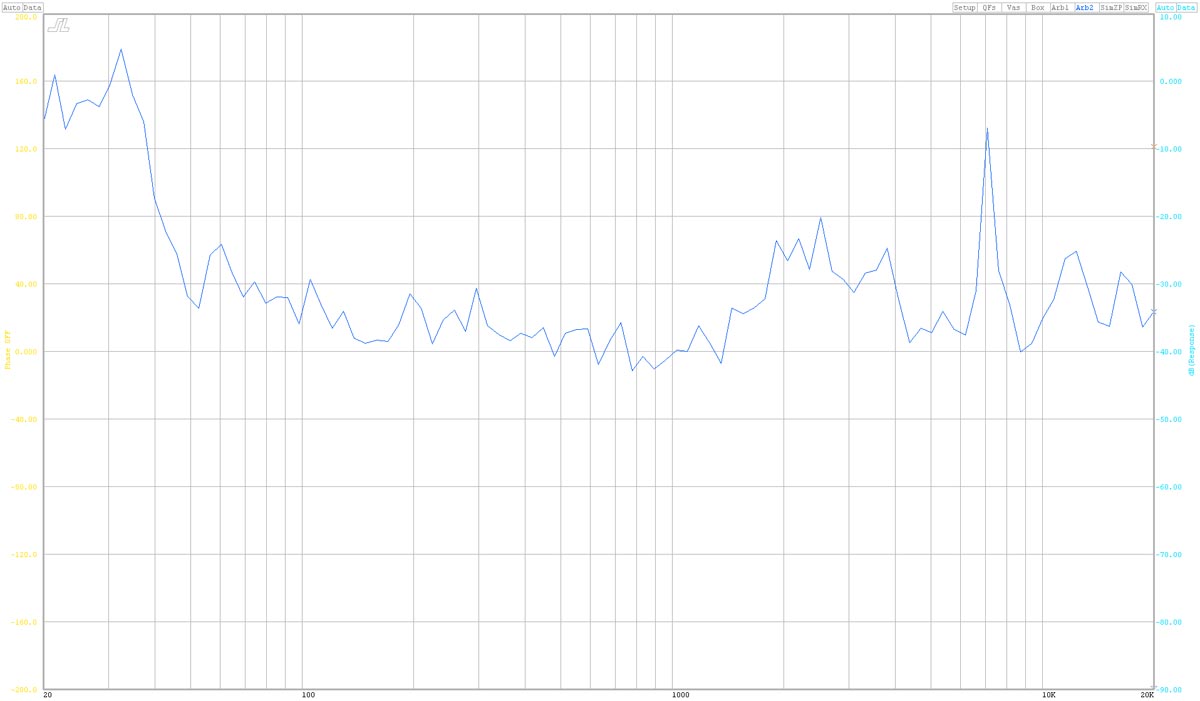

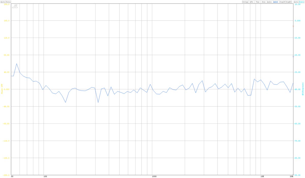

Hope this is better:
Without reflector:
And with reflector:
Note: one measurement starts at 20Hz, the other at 50Hz.
The speaker I used for these measurements is of my own design and for IP reasons cannot yet publish pictures, sorry, but it is nothing special in the sense that it is a two way active speaker.
As a reflector, I appropriately used Vance Dickason's "loudspeaker design cookbook'' which I had laying around.
So, these are very quick and dirty measurements, but the result is so obvious and in line with expectations, that I don't plan to spend any more time on refining them.
