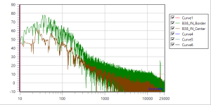

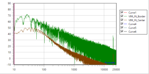

Testing was basically performed as described in the former thread for transmission/transparency, reflection and induced noise (=damping). The film was always stimulated passively, either by the energy of a sound wave, or the dropping of a 4mm steel sphere onto it. Some of these tests seemed to reveal quite obviously some specific film properties. This was the nice side. The more awkward side was given by the fact that even small variances of the setup may have contributed to not so obvious results. And while some analysis methods allowed clear conclusions, others did not quite so.

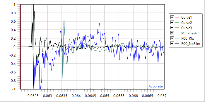

Whenever possible, some calibration was applied. E.g. for the transparency/reflection test first the empty frame (no film fitted) was measured to assess the influence of the frame itself at the two different room locations: The sound source was static. The microphone was static. For the transparency measurements the target location of the frame was 86 mm in front of the microphone, e.g. between the sound source and the microphone. For the reflections measurement, the target locacion of the frame was further away from the sound source at 172mm behind the microphone. So the income time of the reflection was approx. 1ms. Testing for the empty frame effects revealed distinct artefacts attributed to the frame for both frame locations. This was quite unexpected to me, because the frame was made of slim 16mm x 16mm quadratic-sectionned steel tubes.

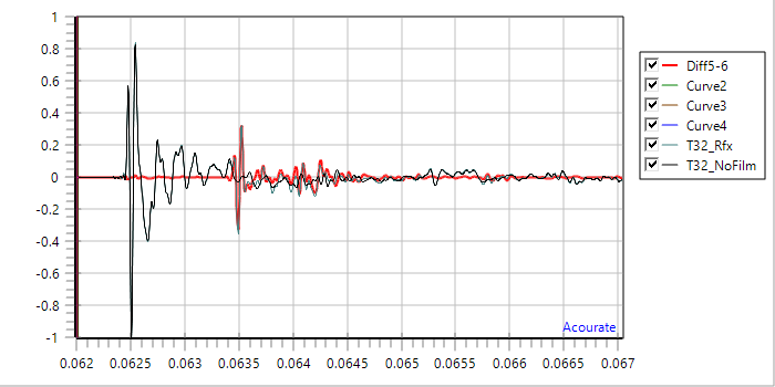

This is a mixed-phase impulse graph showing a time section 0.5ms in front and 4.5ms behind the initial amplitude surge of the pulse.

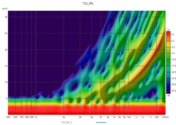

In magnitude domain and after some processing the frame artefacts look like this:
So, once the frame will be fitted with a film, everything outside the envelope of these curves, and certainly everything < -2dB and > +2dB might be considered as film artefacts/properties. Good to know.

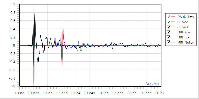

At the other extreme of the calibrations horizont is the full reflective structure. The frame was fitted with a hard fiber board instead of a nothing:
The max. reflection amplitude (grey) gets about 80% of the amplitude of the direct, no film (in this case no board) response. And another thing occurs as a measurement and processing artefact: The transparancy impulse (blue) is much more intense than in the previous graph. In fact it should be lower. This has a simple reason which gets more obvious in the next graph:
The sinesweep recorder gui of Acourate has an option to normalize the pulse after a measurement. If enabled, this option processess weak signals with a compensating amplification. I do have this option enabled as a standard. In reality, the sound intensity behind the board is weaker than in front of it. This then gets processed with the amplification in order to normalize it. Therefore, in this resulting graph the signal behind the board paradoxically appears some 15dB ... 18dB more intense than the one in front of the board. In reality, the rear signal is down by 15dB ... 18dB. You may note that the Y-axis has exceptionally been scaled to +20dB (instead of +8dB) because of the high amplitude of the blue transparency curve.
You also see that in this setup the max. possible comb filter-type, reflection-caused ripple is +6 / -8dB.

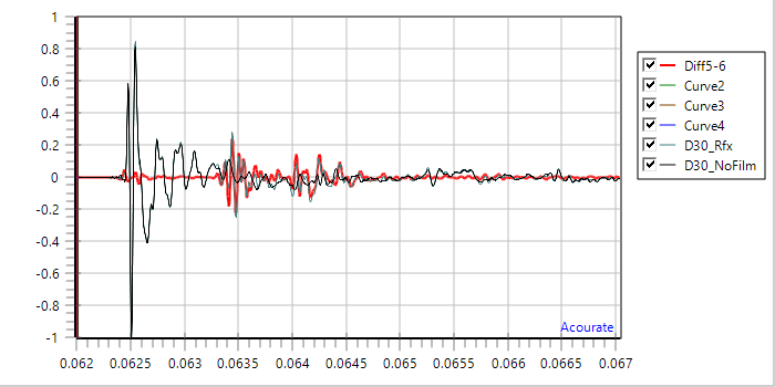

So then, how do the films present themselves applying this kind of measurements (transparency/reflection) and processing:

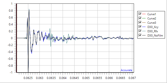

BOPET 3.0um - D30 - Dupont Mylar:

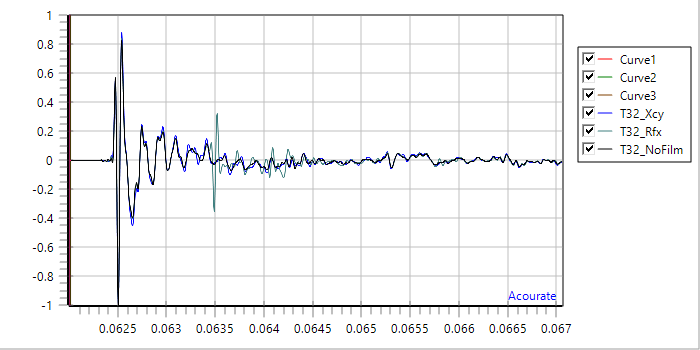

BOPET 3.2um - T32 - Toray PET:
BOPP 3.8um - B38 - The Polypropylen film made in Germany with an equivalent mass of 2.8um PET:
BOPET 4.2um - M42 - Dupont Mylar:
BOPET 6.0um - X60 - ICI Melinex (original product, dating from 1977)
HS 8.0um - H80 - The heat-shrink film which is a co-extrusion of two types. The exact formulation is not known.

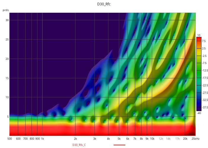

Remember that the delta between the two curves (blue = transparency, grey = reflection) are correlated to the transmission damping: The more damping, the higher the delta.
That's it for the moment ... A presentation of data from the induced noise (=damping) test may follow.
- Black: The Null-measurement as the biasing reference. No frame, no film, nothing but the room response.
- Blue: The empty frame (no film fitted) is located at the location for transparency measurements, e.g. 8.6 cm in front of the microphone.
- Grey: The empty frame (no film fitted) is located at the location for reflection measurements, e.g. 17.2cm behind the microphone.
- Red: This is a synthesized pulse delayed by 1ms which typically would show up in a measurement if a reflective plane/film would have been fitted.
