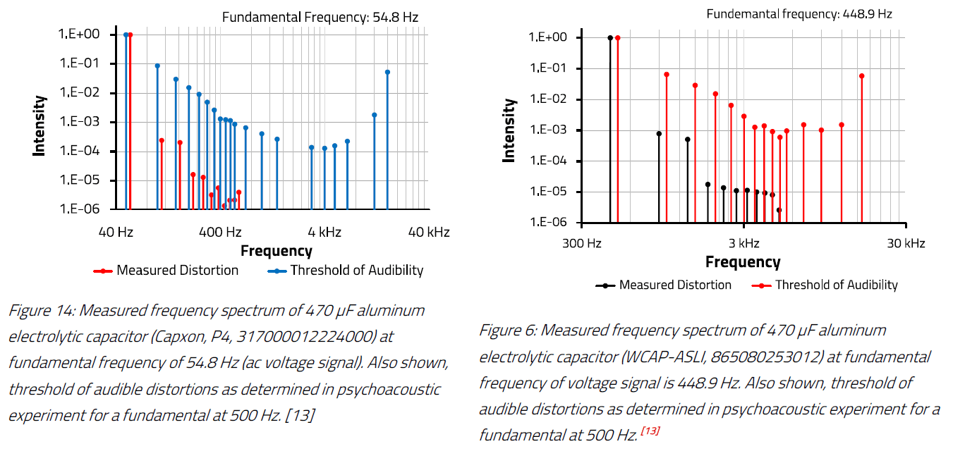

I recently received an article from Wurth Electronics on the acoustic effect of Harmonic Distortion caused by Aluminum Electrolytic capacitors. Their findings pretty much agree with what I have observed and measured over the years - decades actually. This information isn't unique to Wurth products, it applies to all electrolytic capacitors.
I contacted representatives at Wurth for permission to post the article here. They agreed after contacting the author, Dr. Rene Kalbitz.
... so here it is as published.
For those who do not wish to wade through the 15 page pdf:
"Abstract: This note reports a comparative study of total
harmonic distortions (THD) caused by commercial electrolytic
capacitors, as produced by Würth Elektronik eiSos as well as
purpose-built items. The discussion about the audibility of
distortions is made on the basis of human sound perception.
This note arrives at the conclusion that capacitors do not add
significant distortions to fundamental frequencies as they
transfer signals. Modifications of the electrolyte or
separation paper have almost no effect on the THD."

Within reason, and assuming reasonable materials and construction, yes. That is correct. The products made by Wurth are very much like other brands (even special ones for audio), so this applies to electrolytic capacitors in general. If you read the note, they did vary materials and note the results.

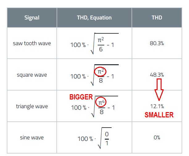

Anybody else baffled by Table 3?

I added the harmonics:
Saw: 62.4%
Square: 43.2%
Triangle: 12.0%
Sine: 0%
The study is considering only non-linear capacitance and ignoring how the capacitor is used in a circuit. A 500 ohm series resistor will dilute the 470uF capacitor's THD to essentially zero.

Didn't Doug Self say something about this some years ago? IIRC he found that if the AC voltage across an electrolytic was less that 60 some odd mV then there was no measurable HD?
IIRC the conclusion therefore reached by some here in the forum was that if the cap was a large enough value such that at the lowest frequency of interest the voltage across the cap below 60mV or so then the cap should have no effect on distortion.

That is exactly the entire point. A coupling capacitor does not have signal voltage developed across it. Otherwise it becomes partly a filter at least. If you size the capacitor properly, it has to be pretty bad quality to make an audible difference. Read defective.
The work Doug Self did was on track and excellent. Other similar studies came to the same conclusions.
As for the sound of various capacitors. Well, that has a great deal more to do with expectation bias and other tricks of the mind. I've tested this often enough over the years using the average customer as a test bed. People who hear a difference aren't really hearing things, but their mind has been conditioned to sense a difference. So they do.
