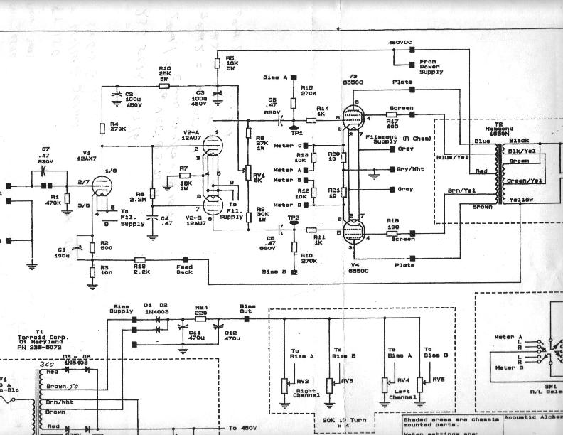

Does anyone have info on this Amp or Company? Might be a no starter or out of business, but this appears to be an easilly modified platform good for either near triode or triode connection. R4 by the way is actually 470k per parts list I have. Thanks

If the power trafo has some extra filament current, ditch the 12AU7 and install a 6FQ7/6CG7. The 'U7 has linearity issues.
Another easy upgrade is to replace the 1Nnnnn diodes with the corresponding UFnnnn parts. UFnnnn diodes are MUCH quieter than the corresponding 1Nnnnn parts.
Thanks for the advice, the transfomer I have is 360 V 200 mA - good for 450 or so DC but sadly specd for 3 amps 6.3 and another winding for 1 amp 6.3 - obviously good only for AC heater supply. Found some 6.6-6.6 CT toroids at All electronics, 8 amp rating, got em, they are powertronix, well made 🙂 and work to specs - so, now I do have enough for a good DC heater supply. Will try the swap. Have the board half populated, now just have to see what that plate resistor on 12ax7 really wants to be. At the rate I am going won't be done for a month, but I will let you know how it sounds.
