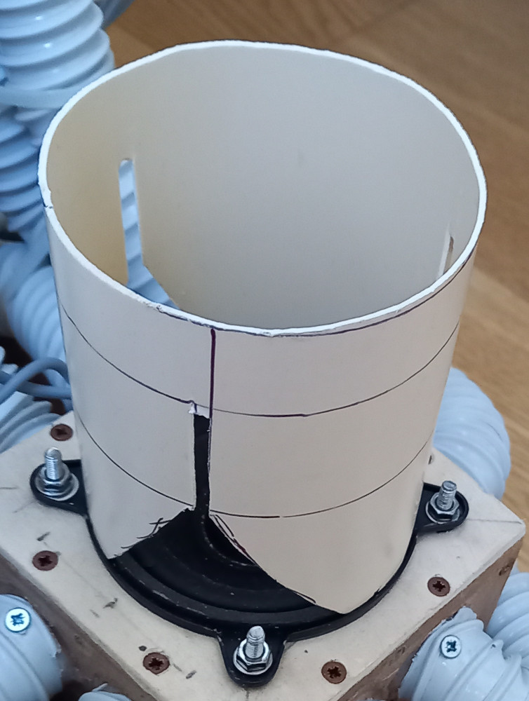

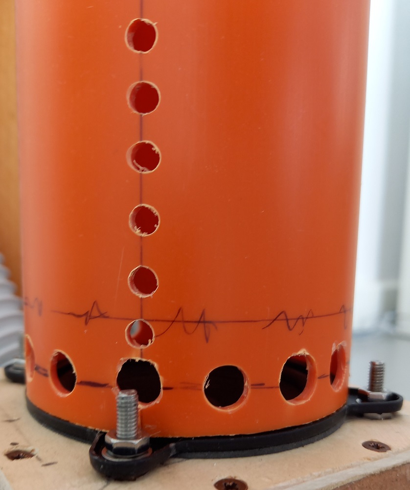

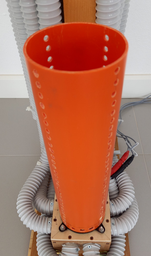

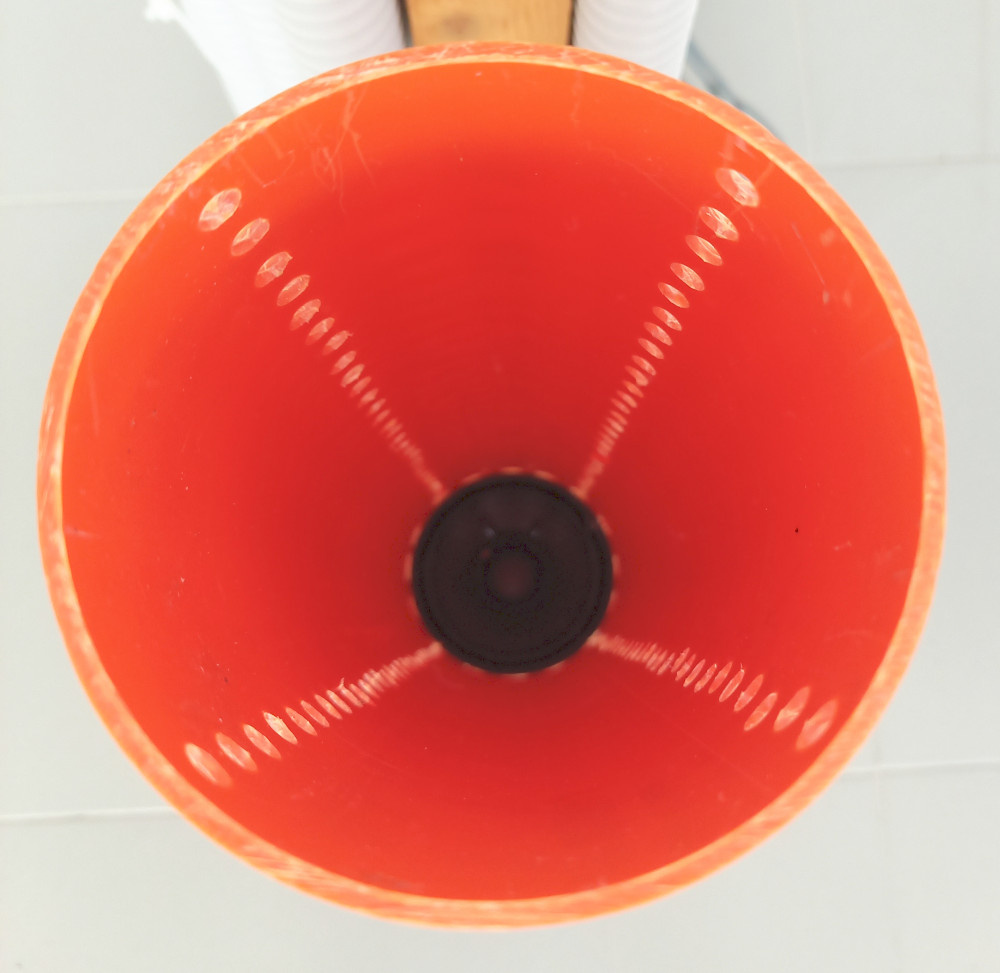

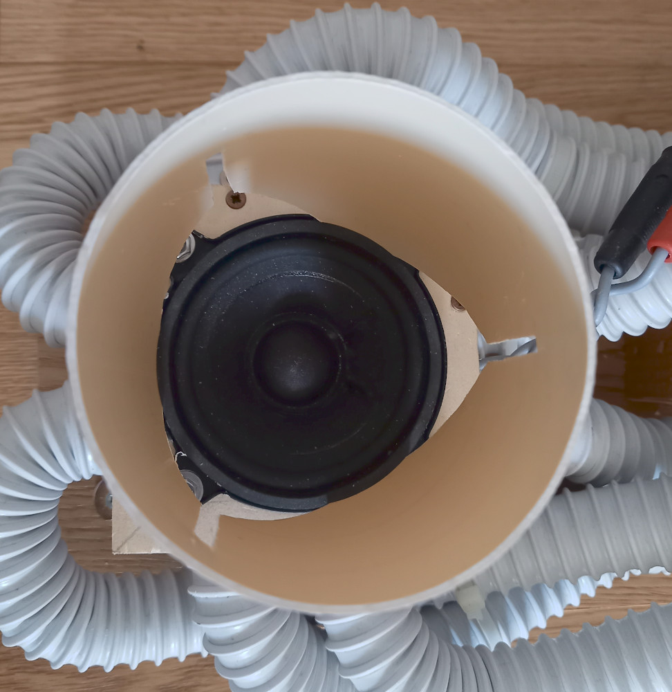

JBL engineers used diffraction to send most of the acoustic energy to listeners. For home listening I use diffraction to obtain a 360 degree emission on the horizontal plane with very simple and cheap devices.
First example: triple profile type Karlson
MDDFL
Second example: single waveguide with the same diameter as the drive with four series of holes.
MDDFL
My web site: Claudio Gandolfi - MDD (Multi Delays Diffraction Loudspeaker)
My thread: MDD Multi Delays Diffraction (Multi TL, omnidirectional, single drive, ...)

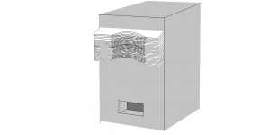

you could make a little cardboard test karlson "front chamber" say a 20 degree baffle angle wedge just large enough to cover the driver. The aperture may be made tighter than what Karlson, as to influence horizontal polars.

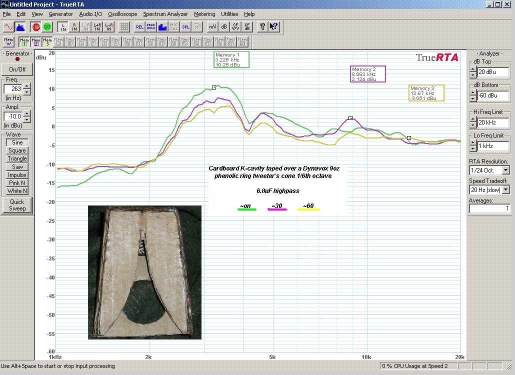

here's a lens in front of a Dynavox "phenolic ring" tweeter - horizontal dispersion is good for 120 degrees up to 20KHz
You can try the JBL lens in cardboard, etc. scale and print the image below to fit the driver120 dispersion - try a Karlson wedge shaped chamber with aperture which overlaps part
of the cone.
JBL style lens - scale as necessary and print:
https://i.imgur.com/E3MneZr.jpg

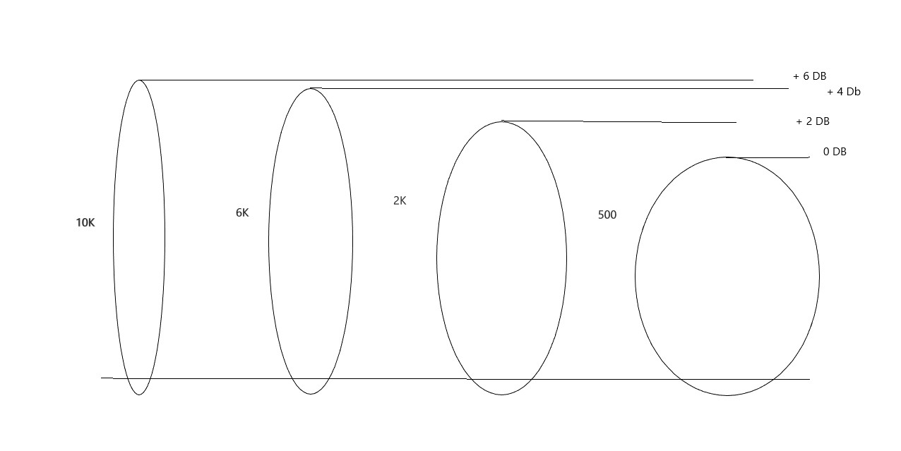

Rick,Wow, didn't take long for some of you to careen down the verbial rabbit hole...didn't cha?
In the prose of anthropomorphism, I can add another nonsensical word attributing to a character of sound..."ASTIGMATIC".

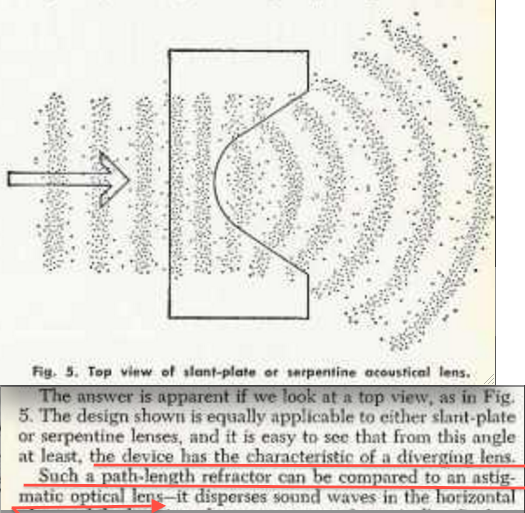

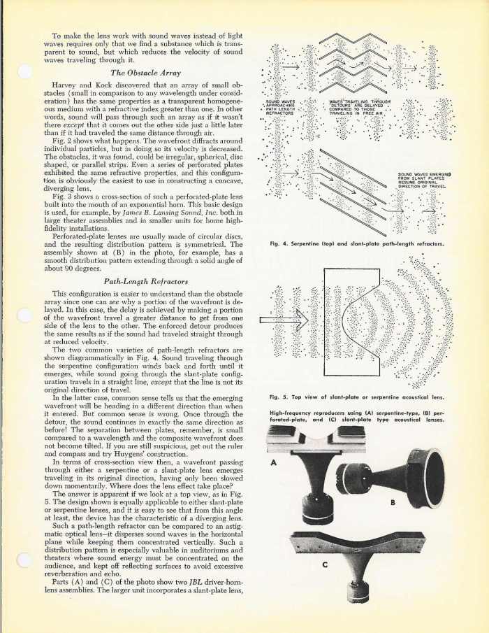

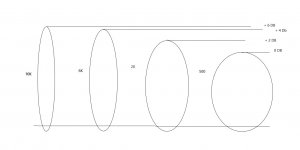

The apt comparison of the 2308 style horn "lens" to an astigmatic optic lens was from the attachment you included in your original post.
The description makes sense of the way the horn lens works.
Though the horn lens does spread out sound waves horizontally, allowing you to hear the hi-hat cymbals and other high frequency sounds a bit further off-axis, the sonic effect in visual terms is a smeared (unclear) image.
You can see the "smearing" in the lateral dispersion, 14kHz is reduced on axis by 6dB compared to 4kHz, and sent off to a pair of peaks left/right 25 degrees off axis. Not visible in the chart is the overall attenuation of high frequency going through the lens causes, not much of a problem with a two-way system, but would require EQ correction using a full range speaker.
Art
Smearing implies an interaction ...as in two-frequencies creating harmonics above and below as in a non linear device. But if this was the case, the collection of frequencies in music with each two creating multiples of...music as a whole wouldn't exist.
There is a nodal effect going on I haven't learned of yet.

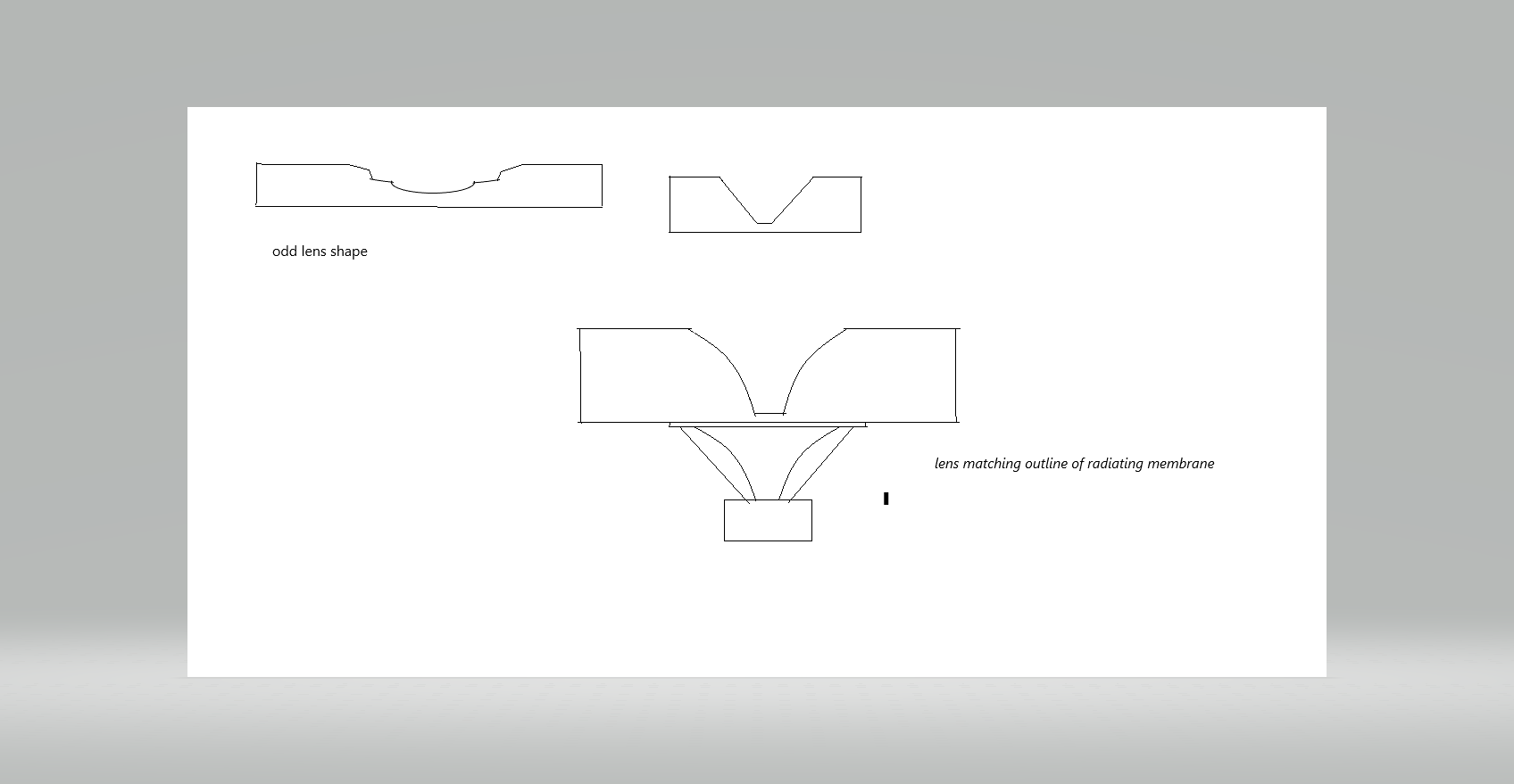

JBL created the potato-masher, the slant-plate, and the serpentine type lens', but this was about it for the lens development...the acoustic lens was dropped when the dome tweeter was developed.
Perhaps JBL was working on nulling out these lobing effects with the more complex serpentine lens.
There is little data I have found as of late, little bits here & there...one the notation of half an inch or less of slant plate "gaps" near 10K hz.
There is one mention of the lens matching the contour of a radiating cone or membrane.

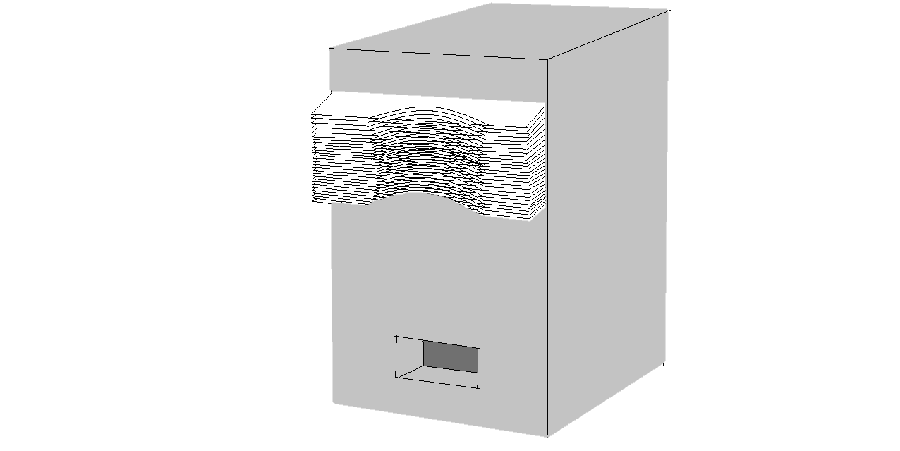

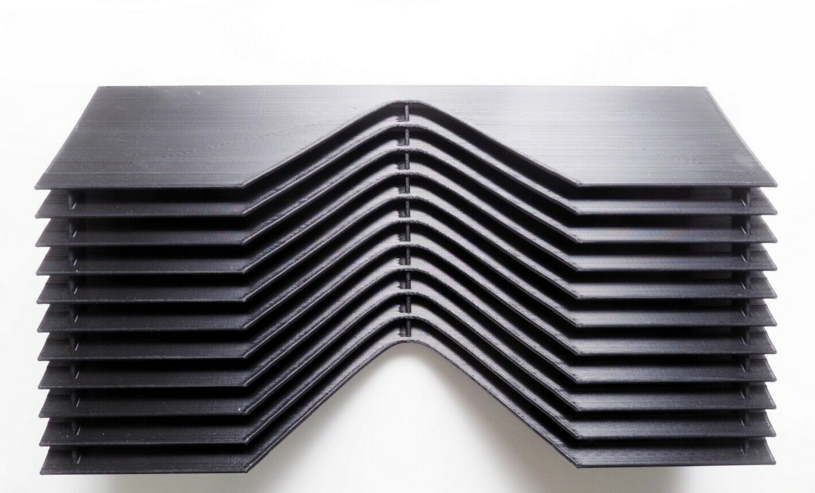

A multicellular horn can be placed in front of an FR driver with no detriment like resonating cavities or combfiltering.
It can be as simple as a single wing sticking straight out splitting the wavefront into two.
Or it can be very elaborate including reflectors as part of the design.
