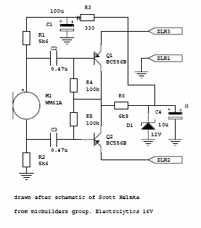

Hey teleman, I actually invested in a Peterman Piezo transducer for one of my acoustics. It has great gain WITHOUT a preamp (plus no associated impedance matching/noise coupling/power supply/ad nauseum). It has to do with the type of transducer it is, that utilizes all three types of force to produce current- pressure, stress, and flexure. It sounds amazing. Look it up online. However, PLEASE DON'T give up on your circuit! I am prototyping a boundary mic built right in to the bridge of an acoustic I'm building. I started down the same road as you, and ruled out many things. First, microphones are better transducers of acoustic sound than piezo elements, second, balanced line level with phantom power is the ultimate way to go, in that the signal is twice the potential no matter what the gain, and phantom power eliminates onboard power needs. Thirdly, most modern consoles have better secondary preamp stages and better tone controls than anything you could build onboard.That just leaves creating the best high-impedance preamp to balanced output line driver to XLR out...which I am still working on...and might need your help myself.

One question remains though! How can I modify this circuit to supply 12/15V DC from a 15V DC supply instead? I'm thinking in lines of "T" power circuits!

Oooops! Didn't even look at the date. I got a reply from DIY in my mailbox, so thought it was a current thread. Sorry. I'm glad you've made progress. To be honest, since they started coming out with high quality very low-noise op amps, I've steered away from discreets. I've been so busy trying to trim out my guitar prototype (I made my own purflings using laser etching) that I haven't got back to my preamp. I appreciate the feedback on the 'Linkwitz mod' however, needed to hear from someone that it really works. Thanks for the reply. BTW, my first name is John. Last name Marvinkite (Don't worry, I get that all the time. My nickname in H.S. was 'Marv'.

I have also been playing around with building onboard acoustic guitar preamp as well. This schematic seems to be designed using phantom power. If you google something like "diy phantom power", you will see quite a bit info about how to add phantom power to this kind of circuits (usually with two 6k8 resistors match to within 1% and non-polarized DC isolation caps).
