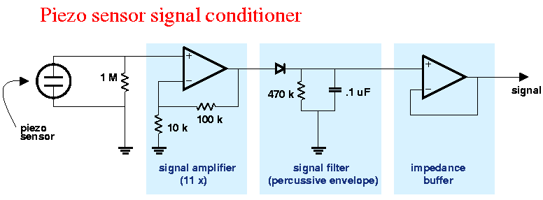

I Found this schematic on http://devices.sapp.org/circuit/piezo, hence thought I could try this with my earlier piezo circuit above to increase the sensivity & gain.
This circuit breaks up the sound!,although I can hear a lot of gain.
Tried removing the diode,but then it sounds like a fuzz box!A lot of distortion!
I've connected it as it is to the previous piezo preamp.(above)
Is there any incompatibility between these two?
By the way I'm running this too on +9/-9 v supply.
Can anyone please tell me why this doesn't work?

I think that this is not a circuit for instruments. Piezo sensors are used for various measurements and this is just one of such circuits. In my opinion you don't need any gain - you just need a circuit with very high input impedance > 10 MOhms (it was stated here already several times). And the circuit from Carvin will work without any problems.
Mark
Mark
Thank you Markus,
Yes you're right,It eventually dawned on me that the circuit was
for some sort of purcussive instrument.But then I just tried the input section only with my current circuit..& both the switches & the tone controls started functioning atlast!
So it could be the impedence/gain incompatibility problem!

For the Panasonic WM 61A you can find good electret mic preamplifiers schematics.
This mic is commonly used by DIY audio people.
You can use just one opamp
http://www.linkwitzlab.com/images/graphics/microph1.gif
http://www.johncon.com/john/wm61a/
For your guitar pickup, you would need a circuit with high impedance input.
This can be done.
Using one opamp with JFET inputs, like TL071 TL061 OPA2134.
At output of those source input amplifiers, you can add whatever other effects or amplifiers.
