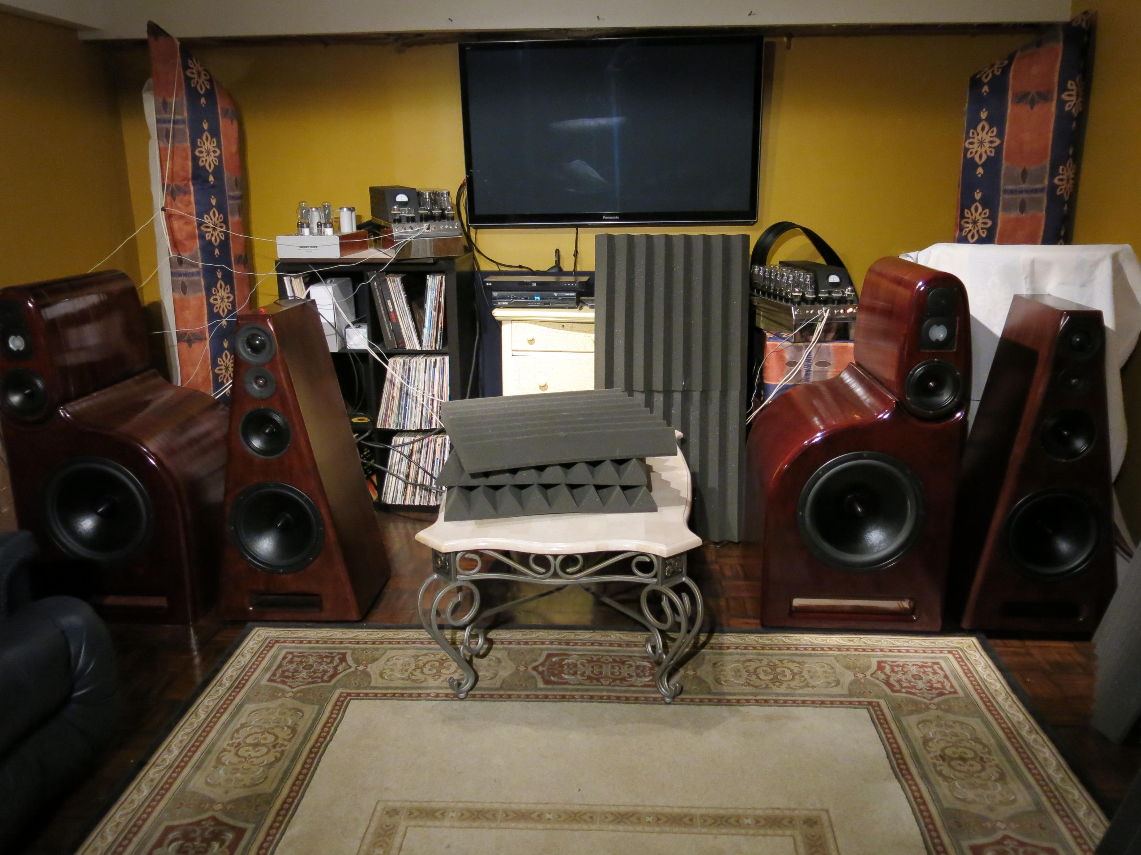

Here is a bit more information;
The above speaker has a frequency dip. It is centered around 240Hz. My first assumption is floor bounce from the mid woofer. After inverting the top three driver section, the dip didn't change. This leads me to a woofer issue.
I can read all I want. For me, trial and error is the fun part of this hobby.
Question; how do dual side firing passive radiators affect overall frequency response?
Here's another problem:
The next speaker will use a slightly more efficient midrange and tweeter. I don't like the sound of resistors, so padding them down is not an option. I need more output.
The next speaker will likely have two mid-base drivers. D'Apollito? TD6m's or TD8m's.
Question; will dual TD15H's, one front firing, one back firing, give me +3dB of output?

Passive radiators act like a port, except they don't have the out-of-band resonances that ported boxes usually do.
Have you tried stuffing the port in your current cabinets to see if the 240Hz dip disappears?
With regards to your allergy of resistors, I'd politely suggest that you get over it. There are a staggering number of resistors that signal must pass through before it even gets recorded anywhere. I'm talking about the mixing desk at the studio end. I promise you they're not using "audiophile" resistors, either. 1/4-watt carbon film, probably. Tens or hundreds of them, depending on whether the mixing was all-analogue, or done in a computer as is often the case these days.
Resistors between the amp and speaker will have some non-linear effects, sure, but nothing that can't be worked out with proper application of LCR and Zobel filters. Edit - except at low frequencies, where the components can get very large. This is where bi-amping comes into its own.
Adding another driver in parallel adds +6dB, assuming the amplifier can supply the extra current. Put them in series, and gain will be 0dB, although the amp will be supplying half the current as the impedance at the terminals has doubled.
NB - this assumes an amp that's a pure voltage source. Valve amps aren't always that.
That only works when the drivers are within 1/4 wavelength of each other at the listening position. With one driver firing forwards and the other backwards, that will depend heavily on your crossover frequency. Below 100Hz, it'll be fine.
Chris
