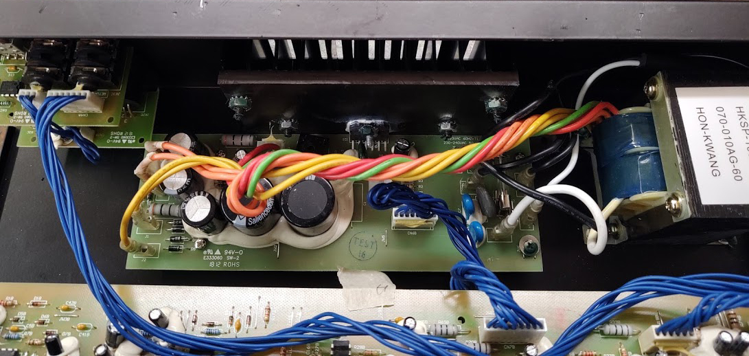

I'm continuing to test this, and so I decided to start by testing the transformer.
I disconnected all primary and secondary connections from the board and did a continuity test. There are 3 secondaries on the transformer and each of the three tested with 100% continuity between each of the secondaries' leads. The thing I wonder about is that one of the secondaries also tested continuity with another set of secondaries.
More specifically there is a pair of yellow wires, a pair of orange wires, and three wires consisting of two reds and a green and the middle. The three wires tested continuity with the orange wires.
Could this be in the design, or is this a flaw or damage?
Here's a photo, showing the power board (top center), with the secondaries (the orange, yellow, red/green).
