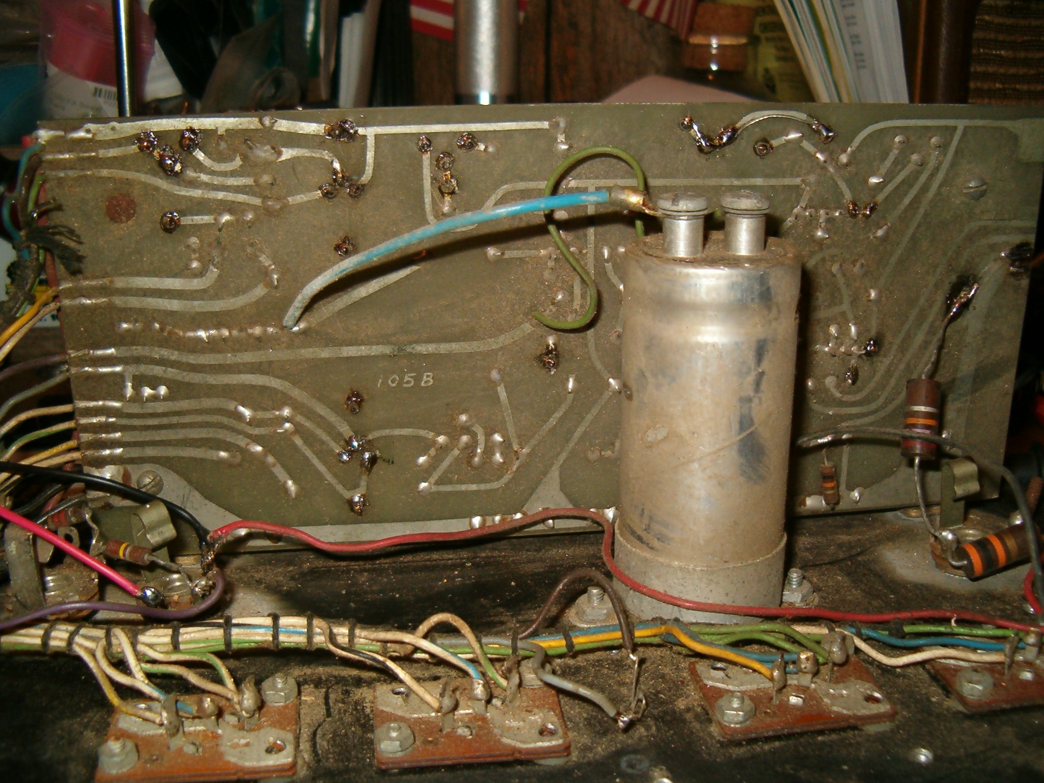

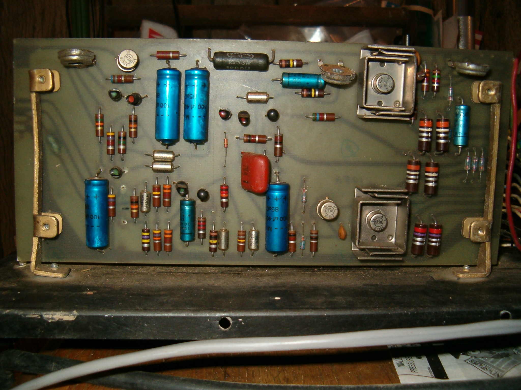

Thanks.Attached are the pictures.

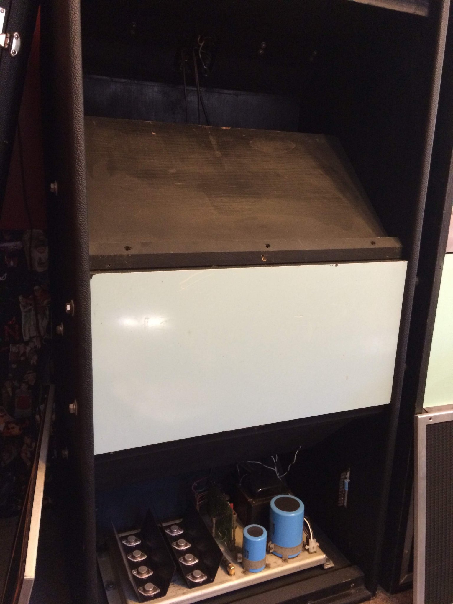

This is actually just the 260 amp module, not the full amp head. Powered speakers are nothing new, Acoustic built powered speakers using just the 260 amp section built on to panel fitted into the back of the speaker.
The idea was use one full amp head and take the line level outs from the head to drive multiple cabinets.

These boards "should" match the schematic I posted, which is a cleaned/sharpened version of the fuzzy one in the service manual, but you check and confirm that.
Just curiosity, it would be nice to see the whole power module and how it´s mounted in the cabinet.
I know the big horn loaded ones, there they had free open air space on the floor
but your 260 looks like a closed (or bass reflex) cabinet from the front.
I suggest an immediate recap of the amp. Those bluish caps may have over 40 years. And the big bottle too.
I am going to, I did pull one side and check them, they did meet the rated value but I know that does not tell you everything. I looked and did not enough proper value caps laying to change them.I suggest an immediate recap of the amp. Those bluish caps may have over 40 years. And the big bottle too.
I think I'm about to order a set of outputs and caps and see where that goes.
you could just check the driver transistors and make sure they are OK.
Otherwise it could be something simple.
There is a few open frame potentiometers which adjust bias and DC offset.
If the finals are not actually blown, they might just be getting nailed hard.
Meaning it is possible, just the open frame bias pot is bad.
or there is a issue with the simple diode string.
or DC offset pot is not so great and causing issues.
could also be basic insulators or mounting hardware for the T03 outputs.
looks like there is fresh solder spots on that board.
might be previous work done on the head, or just your work for testing.
The point is more often than not if previous work was done.
most the time it is where you find problems. check traces/ semiconductors for continuity.
if something is open / shorted could be massive DC offset just nailing the outputs fully on.

its a rather simple bootstrap current source for the bias/ 2nd gain stage.
bootstrap cap is rather small 10uF could be increased to more standard 100uf

I've done the simple test on the outputs and drivers with a multimeter they all passed that test.you could just check the driver transistors and make sure they are OK.

I did pull the pots and measure them on both sides of the wiper and that seemed to add up, put a couple drops of Caig Lab control lube in them gave them few rotations and set them back to where they were at least really close going by the resistance measurement.
Changed the insulators and checked for shorts to the chassis
The fresh solder spots are from me pulling parts for testing.
It did not look anyone has done anything to the board as far as the solder connections look.
There had been some "work'' to the input and output 1/4' jacks, the speaker and input jack need to have
insulating washers on them and they were gone!
