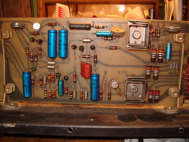

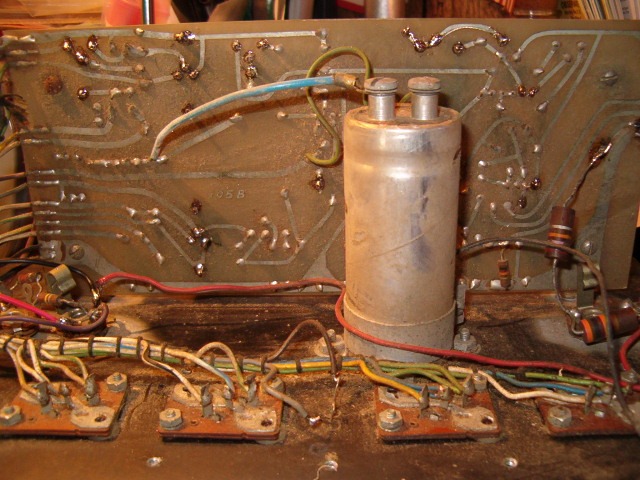

A couple top and bottom real closeup pictures (board almost filling screen) will definitely help.
Model 260 WAS used, even by fmous Musicians, but is somewhat obscure; the schematic which pops out all the time is that of 270, which may or may not be close, we need those pictures.

Attached are the pictures.
This is actually just the 260 amp module, not the full amp head. Powered speakers are nothing new, Acoustic built powered speakers using just the 260 amp section built on to panel fitted into the back of the speaker.
The idea was use one full amp head and take the line level outs from the head to drive multiple cabinets.
