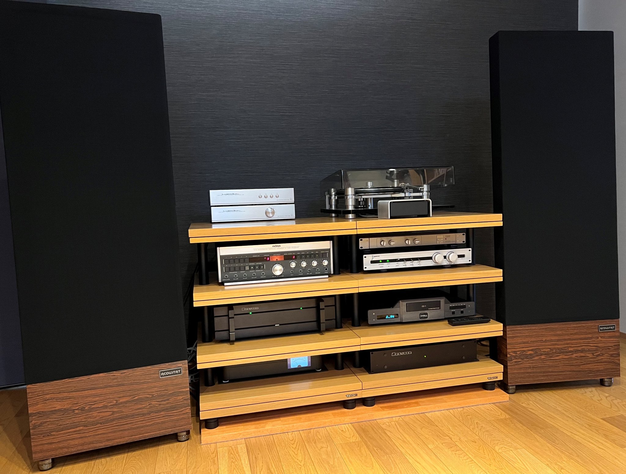

Figure 1. Acoustat Model 2 home setup - photo taken October 2023 after restoration.
  • I was extremely pleased with the sound quality of these electrostatic loudspeakers throughout 20 years of worldwide assignments in Canada, Japan, UAE and UK, beautiful sound no matter where they were setup. Sadly, I had to put all my audio equipment into storage in 2001 due to shortage of living space.
  • Early 2022 brought my Acoustat Model 2s out of storage and powered them up for the first time in 20 years, and although the speakers were still working and usable, they needed considerable work.
  • My goal was to fully restore these speakers to their original (or better) condition, while keeping their external appearance original.

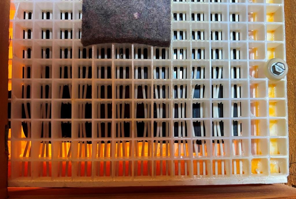

* Lowering the grille cloths to expose the panels revealed several problems with the stator wires (Fig 2.), including multiple broken glue joints, wires bent out of shape/overlapping, wires pressed against the diaphragm etc.
Figure 2. Example back side of one panel showing broken glue joints, stator wires bent, stator wires pressed against the diaphragm.
  • To assess the scope of repair work, this series of Acoustat model 2 is configured with two, 3-wire panels per speaker, for a total 8 panel sides needing inspection and repair (2 sides per panel x 2 panels per speaker x 2 speakers). While one of the panel sides had only a few broken joints, all the other panel sides suffered from several hundred broken joints.

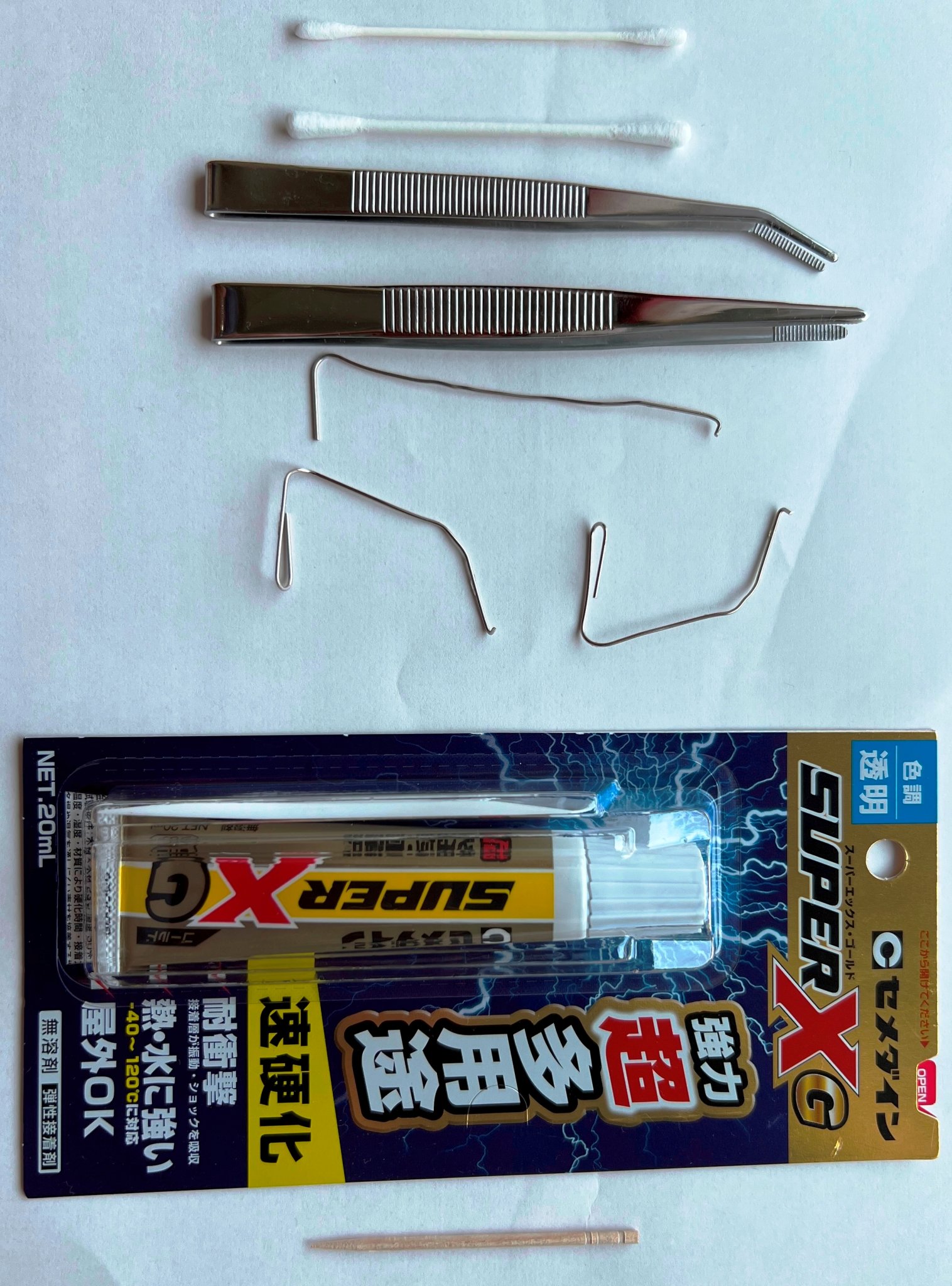

Materials and Tools
Figure 3. Example of commercial and hand-made tools, adhesive for plastics.

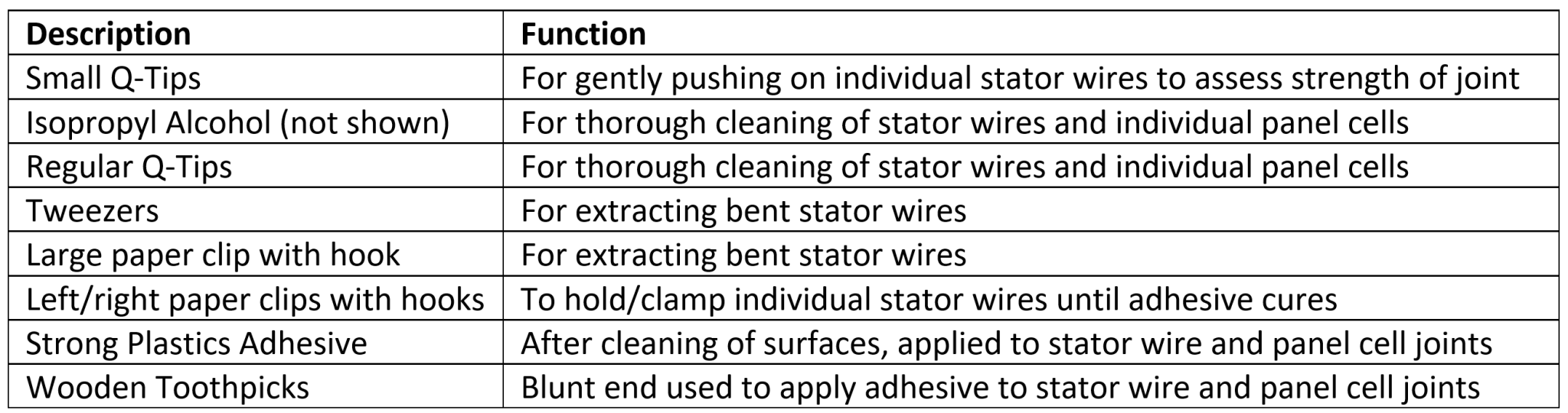

Table 1. Description of repair tools and materials.
  • From a visual inspection of the stator wires its not always apparent where the problem joints are, using a small Q-Tip to gently press on the stator wires proved effective in identifying weak or broken joints.
  • For adhesive, I used several tubes of Cemedine "Super X Gold", due to its suitability for a wide-range of plastics, high-strength, high-temperature rating (a consideration for diaphragm heat-shrinking), and quick drying to a semi-hard, semi-translucent finish. Although not tried, other adhesive brands can also work well. https://www.cemedine.co.jp/global/en/technology/elastic/superx/index.html
  • To prevent adhesive from contaminating the diaphragm, I used the blunt end of a wooden toothpick to carefully apply a small dab of adhesive only to the stator wire and panel cell of each broken joint.

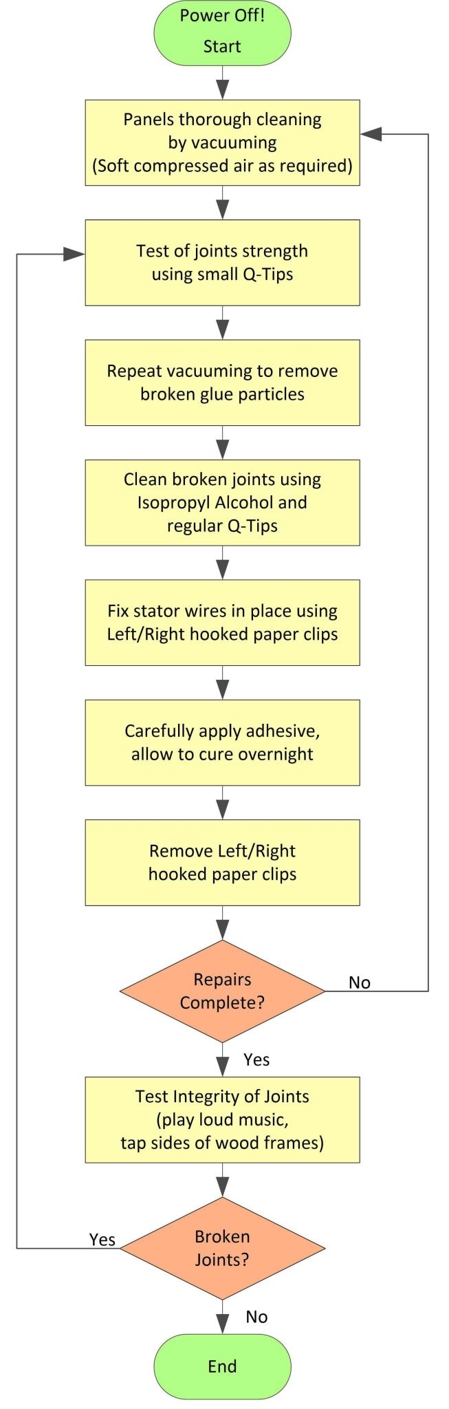

Figure 4. Example of stator wire repair workflow.

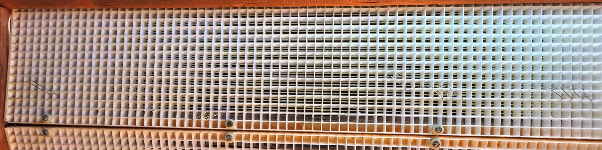

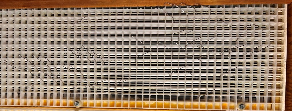

Figure 5. Beginning of repairs to the back side of panel shown in Figure 2, with Left and Right hooked paper clips in place.
Figure 6. Continuation of repairs shown in Figure 5 with more Left and Right hooked paper clips in place.
* As described in the flowchart (Fig. 4) and shown in Figs. 5 and 6, the repair steps may need to be repeated several times until all joints have been repaired. Patience is needed, this process can take several months as seen in Fig. 7. From my experience, I could spend only a few hours each day on these repairs before a hand cramp or fatigue set in. There's no need to rush it, take the time to do the repairs carefully.

  • In my case I spent about 5-months on this extensive repair, the panels cleaning process consisted of daily vacuuming, once a week blowing with soft compressed filtered air, and before applying any adhesive carefully cleaning the exposed stator wires and cells with isopropyl alcohol.
  • To explain the flowchart step "Test Integrity of Joints (play loud music, tap sides of wood frames)". Although this repair process can be tedious, there's no rush to complete it. Whenever the adhesive has cured and all paper clips have been removed, the speakers can be powered up and you can enjoy listening to music. When I played loud music, I believe this put stress on the stator wires causing other weak joints to fail - I believe this is a good thing because it accelerates the inspection and repair process, better to identify and repair weak joints sooner rather than later.
  • A useful remedy described by Mr. AAM on the diyAudio site to dislodge trapped foreign particles advises simultaneously slapping both sides of the wood frames (with power off!) with the palms of your hands, and indeed this does work. However, it also exposed more weak joints causing them to fail, but again I believe this is a good thing - the earlier you can identify weaknesses and fix them the better.

* As before, the minor follow-up repairs used the same simple tools and items shown in "Figure 3. Example of commercial and hand-made tools, adhesive for plastics.", while following the steps described in flowchart "Figure 4. Example of stator wire repair workflow.".
After 6-months usage, one panel's minor repair showing hooked paper clips in place - photo rotated 90 degrees to fit.
