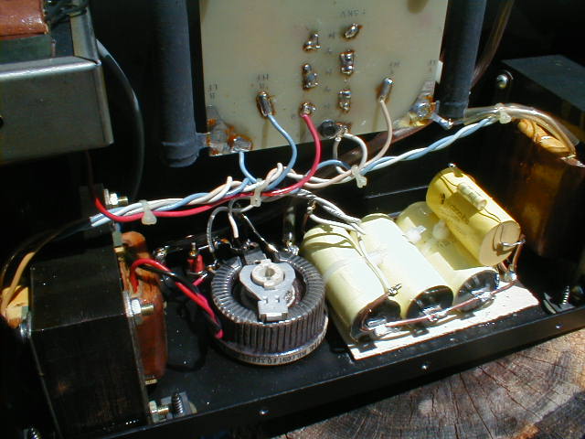

Change out the coupling caps, asap - use film caps, preferably polypropylenes. This will dramatically improve the imaging, moving the upper mids back into the same plane with the rest of the sound.

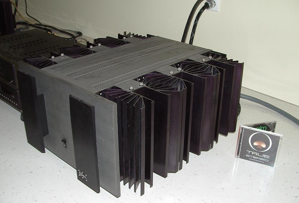

I bought my amps especially for the occasion of when I would get the acoustats.
I found a pair of mono blocks krell krs 100
they were made specifically for the apogee scintilla 1 ohm load,so acoustat will be a piece of cake

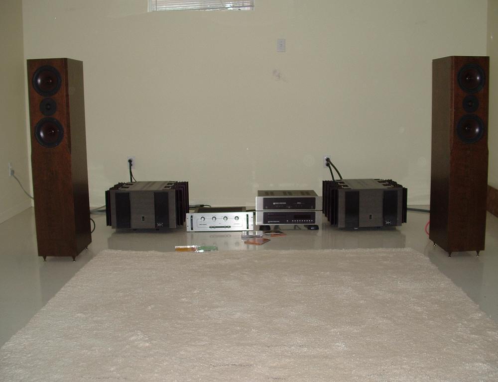

here is my room (had no time to decororate or paint)the speakers are my DIY'S,they play extremly well...but when acoustat are in town they are gone!!

I bought my mono blocks especcially for the occaison that I would find either a pair of acoustat medallions 2+2 or a pair of apogee scintilla or divas on the market.
they are krell krs 100
double their power in class a down to 0.5 ohm(1600watts per channel)
they were made for the scintilla at the time for their 1 ohm load,but since they will be driving my acoustat if I right they are 4 ohm so wont be a problem
here is my setup(the place hasn't been decorated yet it's in the basement ,also the audio research sp9 is gone replaced by conrad johnson pv14L ,which has a much better image and depth but also better sound overall smooth and more character.for the price I think it's a piece tough to beat.

Dear newfinish,
May I offer you some suggestions, hopefully without appearing too critical or making you upset? I hope so.
After looking at the pic of your system, of which you are proud, my reaction was "oh dear"!
Here's why - the room!
Hard floor, hard walls, hard ceiling, no absorption or diffusion!!
You definitely badly need to take some time to install something to do these tasks. It can be bought for purpose, homebrewed, or just "stuff" that normally goes into a room (bookshelves, wall hangings, etc...), it's necessary. Put a layer or two of padding under that rug too!!
The only other thought that I had is that while the Krell amps definitely are low Z champs, imho they are not champs in other regards. Imho, for the Acoustats, if you got something like a 150+ watt class tube amp with a pair of 811s with an all triode input & drive stages, you'd instantly relegate ur Krells to dust collection! 😀
If and when you get those Apogee speakers, you may have to use the Krells then...

PS. Yes, the coupling caps are easy enough to find. You have to be able to desolder/solder. You'll need either 50ufd or 200 ufd, depending on which set of caps are in your interfaces... just match the total capacitance of what is already there - you can ignore the value of the small caps. Then you need polypropylene caps (you can parallel them to get the total ufd amount) @ 200vdc rating or higher. Easy enough to find. Personally, I do not think you need to go for "exotic"/expensive "audio" caps. Regular or switching supply type polypropylene caps will do this job just fine. Surplus or stolen from dead computer monitor chassis (for example) works for me... 😉
You can remove the top "hatch" of the interface without removing the interface entirely, just make sure the speakers are unable to tip over - they are leaned up against something, etc... since the interface is part of the "stand" and you will be removing half of the mounting for that...
The caps are against the rear wall next to the HF control area... not the ones on the HV board in the center... 😀
change those Caps!!
I finished the mods on my 1+1s recently and getting that old electrolytic cap out of there worked wonders!! A whole other layer of grime was removed. I don't think there is much else you can do with these speakers except direct drive!
If you are going to stick with the interfaces then I recommend anything but Krell but primarily I recommend a powerful tube amp...especially an OTL. For some time I had a pair of Silvaweld OTL Tube Reference monoblocks on my Acoustats (100 watts with 4 6C33C tubes per monoblock) and it sang like no other amp in my experience. Just make sure you have good air conditioning!! It rasied the temp in my room by several degrees!
