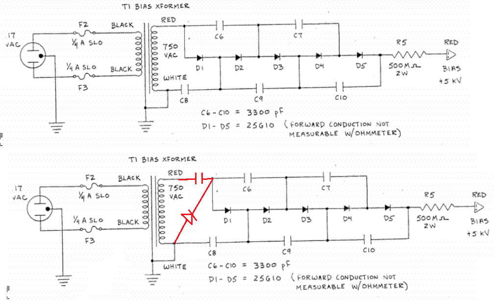

Can someone show me a pic or a diagram of how to add additional diodes and caps to my mk 121 HV bias section. Do I need to drill additional holes in the board and hard wire the connections. Please give advice and pics if possible.
So you just add that one 1 diode across the red and white wire without extra cap? That will increase voltage enough to get to 3.2k V.?
Sorry I now see the cap thanks makes sense now and I believe the holes are already there. Did you notice the panels easier to drive after doing this? Thanks for the help.

I have been running my bias high for years.....it opens up the sound....this year i pic up a pr of Acoustat 2+2s I ran them all stock ....with 5k bias that had just been rework with all new parts...for about 4 weeks..then I added the diode an cap....Wow....for me it a must...
I just cant live with the stock setup.... knowing what I was missing.....other may feel diff..
all just one mans finding....good luck

Soldered on the under side of the board where the traces are a diode going in proper orientation from the white tab from bias transformer to red wire from bias transformer , now do I solder a 3300 pf. Cap along side it from same wires (white and red) as diode? Want to make sure I understand.
